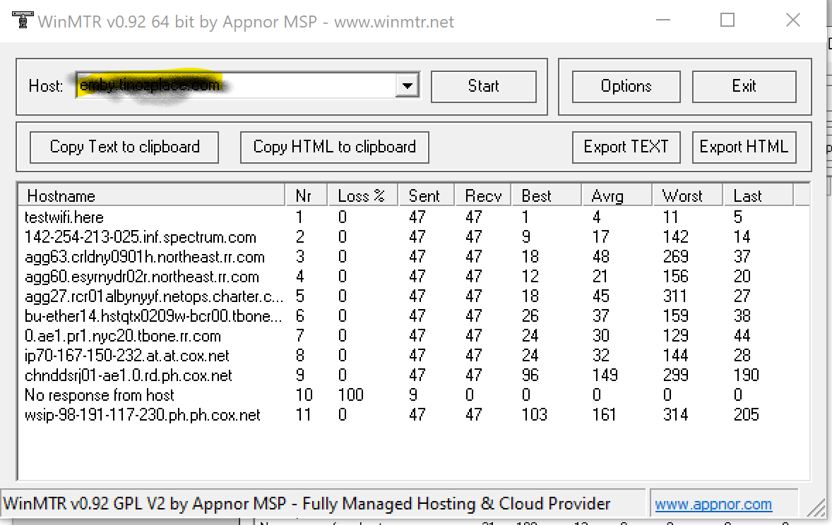

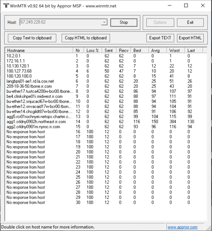

rbjtech 5337 Posted June 18, 2021 Posted June 18, 2021 Network LATENCY may also be an issue here which people frequently forget about - for 'chatty' TCP protocols (such as emby), this latency could lower throughput significantly. From AZ to NY latency should be in the 60mS range - which should not have any impact on throughput - but if this is much higher than this, then it starts to slow down TCP throughput unless you start using larger packet sizes to combat the latency. What does the speed test/ping test show as the latency ?
Carlo 4561 Posted June 18, 2021 Posted June 18, 2021 @Tony B. Do you have the ability to test your server from a different ISP closer to home like from work or a friends house? If you want to send me a login via PM and a movie/show to try I'd be happy to give this a test run for you from the Phila area (I'm on gig up and down) on Verizon FIOS and also on Comcast (400 down) as I have both. What that test might help to show is if it's on the server side or not. If it's ISP throttling at either end you may be able to work around this with a point to point VPN. Sometimes as Luke suggested a switch to a different uncommon port might thwart ISP throttling. But as @rbjtech mentioned if it's a latency issue the only possible fix is to contact the ISP or switch ISPs.
Tony B. 38 Posted June 18, 2021 Author Posted June 18, 2021 (edited) 10 hours ago, rbjtech said: Network LATENCY may also be an issue here which people frequently forget about - for 'chatty' TCP protocols (such as emby), this latency could lower throughput significantly. From AZ to NY latency should be in the 60mS range - which should not have any impact on throughput - but if this is much higher than this, then it starts to slow down TCP throughput unless you start using larger packet sizes to combat the latency. What does the speed test/ping test show as the latency ? That's NY to AZ.. That's the Emby Server in AZ to NY. Doesn't look very good. Edited June 18, 2021 by Tony B.

ebr 16309 Posted June 18, 2021 Posted June 18, 2021 3 hours ago, Tony B. said: That's NY to AZ.. That's the Emby Server in AZ to NY. Doesn't look very good. Given that, I don't think the app/device is the problem...

rbjtech 5337 Posted June 19, 2021 Posted June 19, 2021 15 hours ago, Tony B. said: That's NY to AZ.. That's the Emby Server in AZ to NY. Doesn't look very good. NY to AZ is 'ok' - Adding up those latency figures gives you ~500mS - which should be fine. That sort of latency is not good, but it should not cause you throughput issues. However - AZ to NY appears to be stuck in a loop (max 30 hops) - suggesting a routing issue on the ISP side of things. That will cause you issues - causing packet loss and seemingly random issues.
