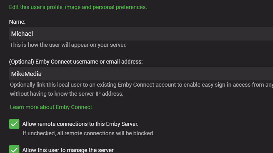

Carlo 4561 Posted June 17, 2021 Posted June 17, 2021 Tested the WAN address and it's working just fine from my house so remote access is good. MikeMedia would be what you want to have in the optional Emby Connect field. Make sure you have "Allow remote connections to this Emby Server." enabled for this user in the profile tab. Keep in mind you have a local username/password and then Emby Connect user of MikeMedia and password. So don't confuse the two different passwords. Are you trying the phone on WIFI or off WIFI through the cell network? You may want to try it both ways.
MikeMedia 1 Posted June 17, 2021 Author Posted June 17, 2021 Yes we have allow remote connections see screenshot. and the pw SHOULD be the same for both.

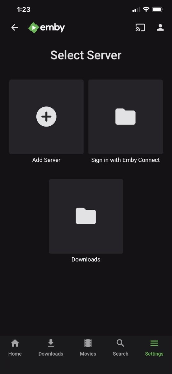

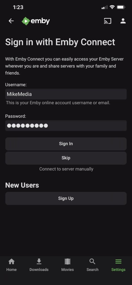

MikeMedia 1 Posted June 17, 2021 Author Posted June 17, 2021 HEres the sign on screen and after i enter username i just go back to the select server screen Oh..also, it works fine connecting local on wiFi but when i try to use it outside on cell only, thats when it fails/
