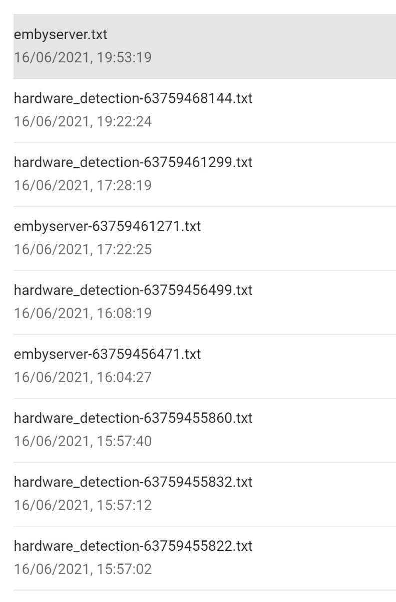

Carlo 4561 Posted June 16, 2021 Posted June 16, 2021 Try this for me. Play back one of these media files then go look at your logs. Do you see a log file starting with ffmpeg with the same time as when you started playing this file? If so upload that ffmpeg file here please. 1
mystic.bertie 23 Posted June 16, 2021 Author Posted June 16, 2021 Thanks for your reply the log file just says 'embyserver.txt'

Carlo 4561 Posted June 16, 2021 Posted June 16, 2021 3 hours ago, mystic.bertie said: Thanks for your reply the log file just says 'embyserver.txt' You don't have any ffmpeg named files looking at the Logs menu like this? 1

mystic.bertie 23 Posted June 16, 2021 Author Posted June 16, 2021 18 minutes ago, cayars said: You don't have any ffmpeg named files looking at the Logs menu like this? No mate they all look like this.

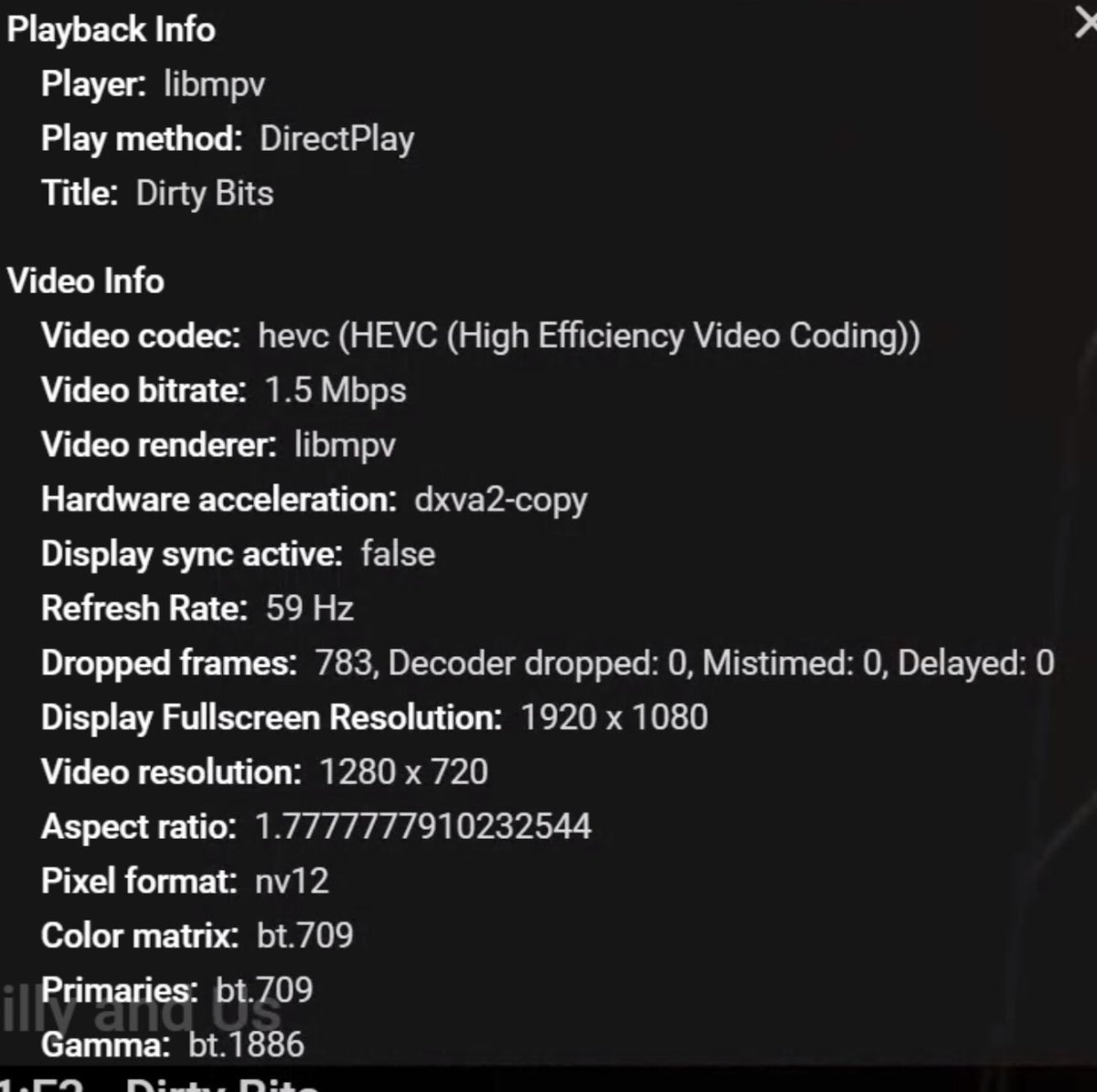

Carlo 4561 Posted June 16, 2021 Posted June 16, 2021 OK so what is likely happening is that the client, not the server is trying to process this file and that is what is kicking in the fans. If you play this back in Theater and bring up stats for nerds what does it show? Can you grab a screen shot? 1
mystic.bertie 23 Posted June 16, 2021 Author Posted June 16, 2021 36 minutes ago, cayars said: OK so what is likely happening is that the client, not the server is trying to process this file and that is what is kicking in the fans. If you play this back in Theater and bring up stats for nerds what does it show? Can you grab a screen shot? thanks and here you go
Guest Posted June 16, 2021 Posted June 16, 2021 There's your answer. It's dropping frames. Switch your hardware acceleration back to auto and change the renderer to GPU.
mystic.bertie 23 Posted June 16, 2021 Author Posted June 16, 2021 27 minutes ago, generiq said: There's your answer. It's dropping frames. Switch your hardware acceleration back to auto and change the renderer to GPU. Wow this is amazing, it works great now and there is no fan noise at all. Well done to everyone and very well spotted mate Your a star
