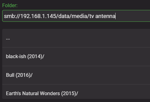

xrqp 11 Posted June 16, 2021 Posted June 16, 2021 (edited) Emby screen: I click OK and get this error message "Emby Server requires write access to this folder. Please ensure write access and try again." Unraid share (called "data" where I store media) is setup like this: Any thoughts how I may fix this. Edited June 16, 2021 by xrqp

Luke 42246 Posted June 23, 2021 Posted June 23, 2021 Hi @xrqp, rather than add an smb path into emby server, I would suggest mounting the smb share to a local path using the tools unraid/docker. Then add the local path into emby server. Please see if that helps. Thanks !
xrqp 11 Posted June 26, 2021 Author Posted June 26, 2021 (edited) Luke, I'm guessing when you say "...mounting the smb share to a local path using the tools unraid/docker", I'm guessing it means "setup the path mapping in the container settings, then use that path in the emby server app". By doing that, it fixed the problem! Yeah! It seems with emby i need to do that for every media library path. I had done it for "movies", and "tv"(for all tv that is not from antenna), but I had not done it for "tv antenna". Once I added "tv antenna" to the container paths mappings it works good. And port assignment problems went away too, which (I do not understand). With other unraid containers, like sonarr, radarr, etc., I did not have to map so granular. I just needed to map the one higher directory "data" (used for media, but called data, to copy what Trash's Guide used), and that alone covered the subfolders of "movie", "tv" and "tv antenna". I am not 100% sure of all of this, but that is how recall it. I am doing all this as a "public" share. I may try to secure it to user "bob" but one step at a time. Edited July 5, 2021 by xrqp
