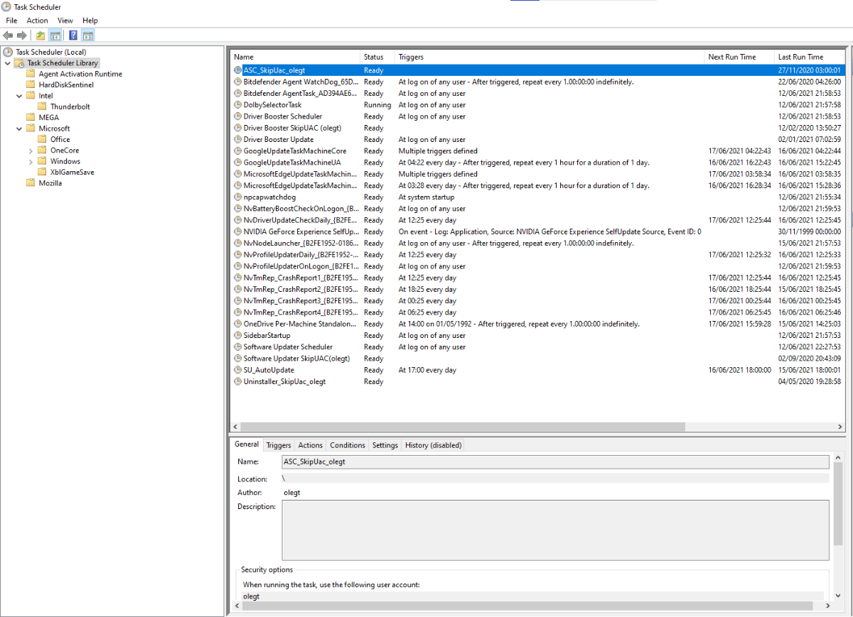

Carlo 4563 Posted June 16, 2021 Posted June 16, 2021 Just to be clear I'm talking about OS Scheduled Tasks not those inside Emby.
GrimReaper 5210 Posted June 16, 2021 Posted June 16, 2021 I have no Emby-related scheduled tasks at all.

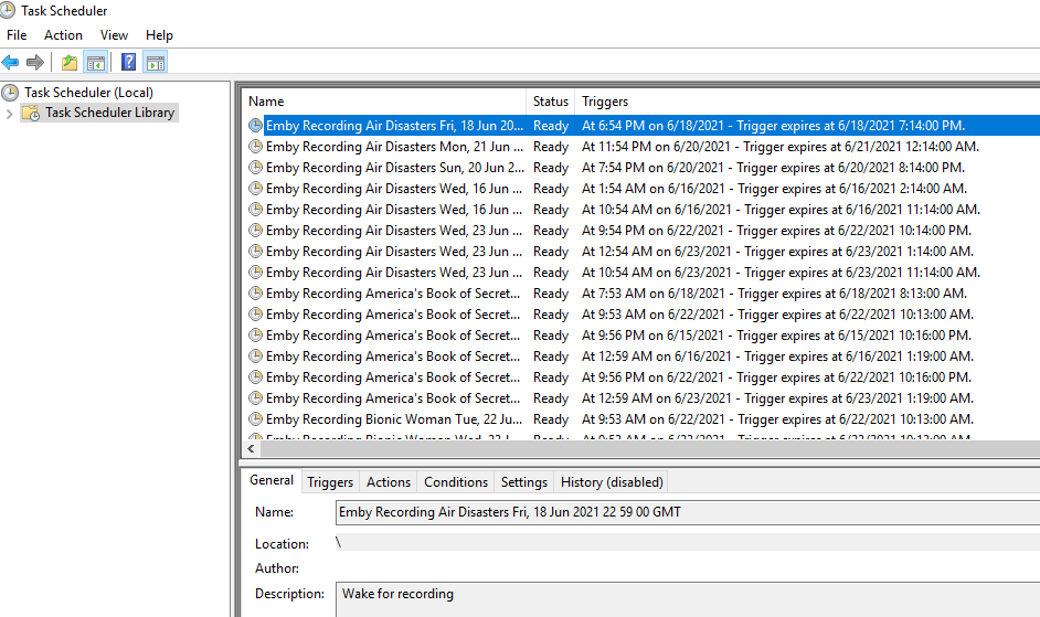

Carlo 4563 Posted June 16, 2021 Posted June 16, 2021 You're not assuming but checked? Emby creates these for scheduling.
GrimReaper 5210 Posted June 16, 2021 Posted June 16, 2021 I was assuming, as I've never made any For Emby myself, but upon checking, still cannot find single Emby-created task, where would that instance be? 1
Carlo 4563 Posted June 16, 2021 Posted June 16, 2021 That is where they would be. Here's an example 1
