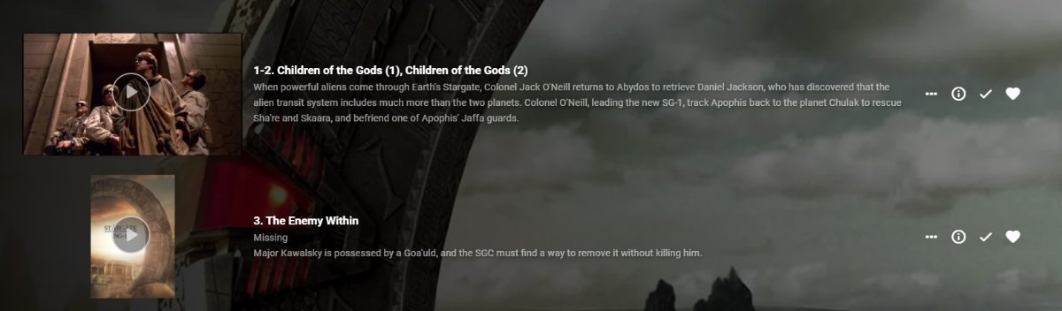

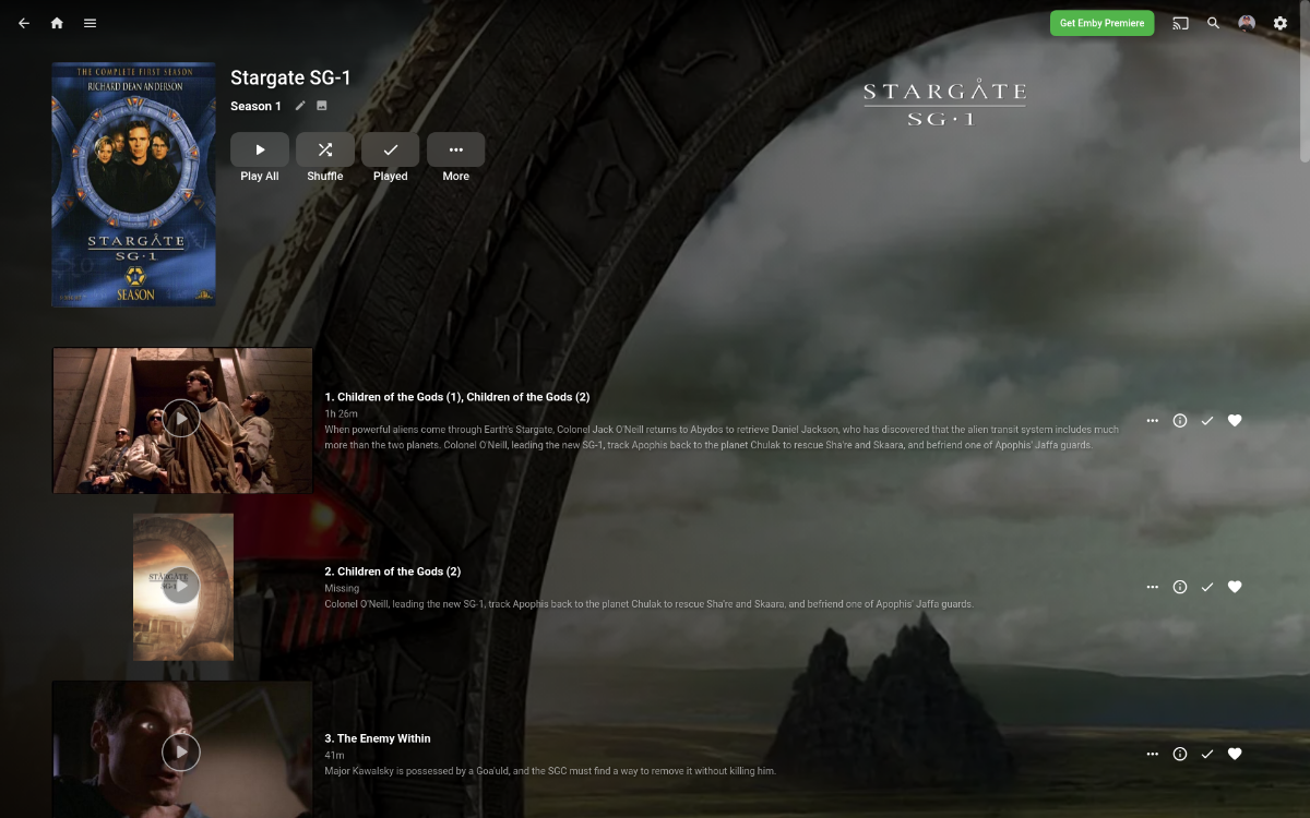

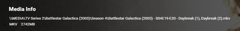

Junglejim 385 Posted June 14, 2021 Posted June 14, 2021 Hi guys, sorry if this has been covered before but it a new thing for me from 4.6.. Multiple episodes seem to give a missing episode result. I have looked at the settings and nothing jumps out as a problem. As you can see Emby thinks Ep 2 is missing but its a double. I also attached the episode data.

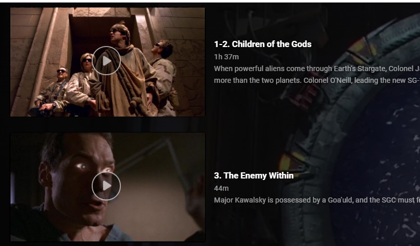

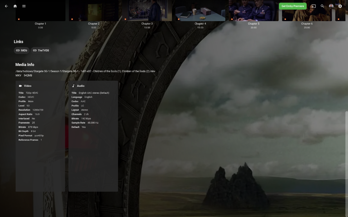

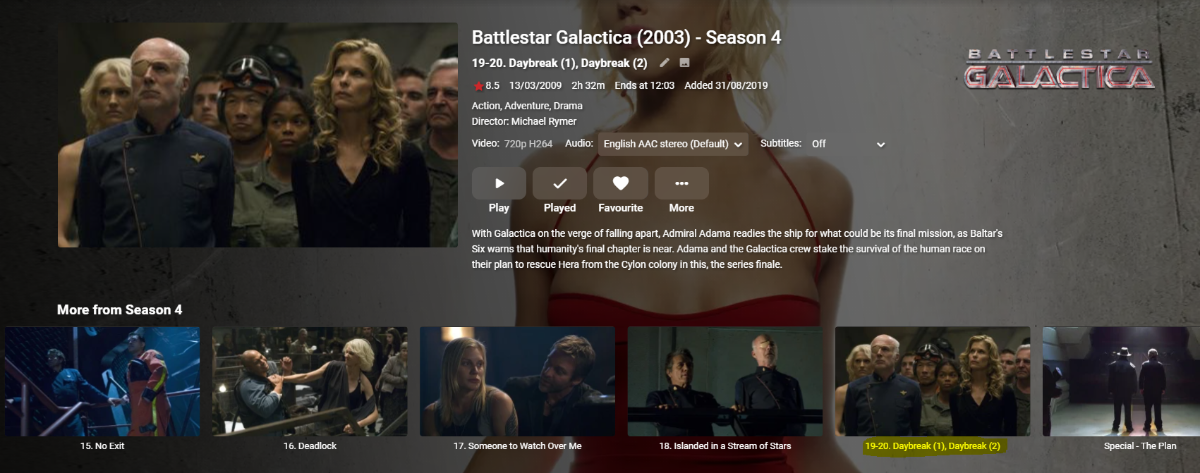

Happy2Play 9799 Posted June 15, 2021 Posted June 15, 2021 @Junglejim Not sure as I enabled missing episodes on a database only library (no nfo) and added this series with provided naming scheme without issue. So all I can guess is a quirk with Missing Episodes. Before After (Stargate SG-1 - 1x01-x02 - Children of the Gods (1), Children of the Gods (2).strm) Only thing I can suggest is Removing the episode, doing a library scan so both show missing, then re-add the episode and do a scan to see if they are picked up properly.
Junglejim 385 Posted June 15, 2021 Author Posted June 15, 2021 Thanks for the advice mate, that worked. Now I have to find all the rest of my double episodes and do the same thing. Cheers.

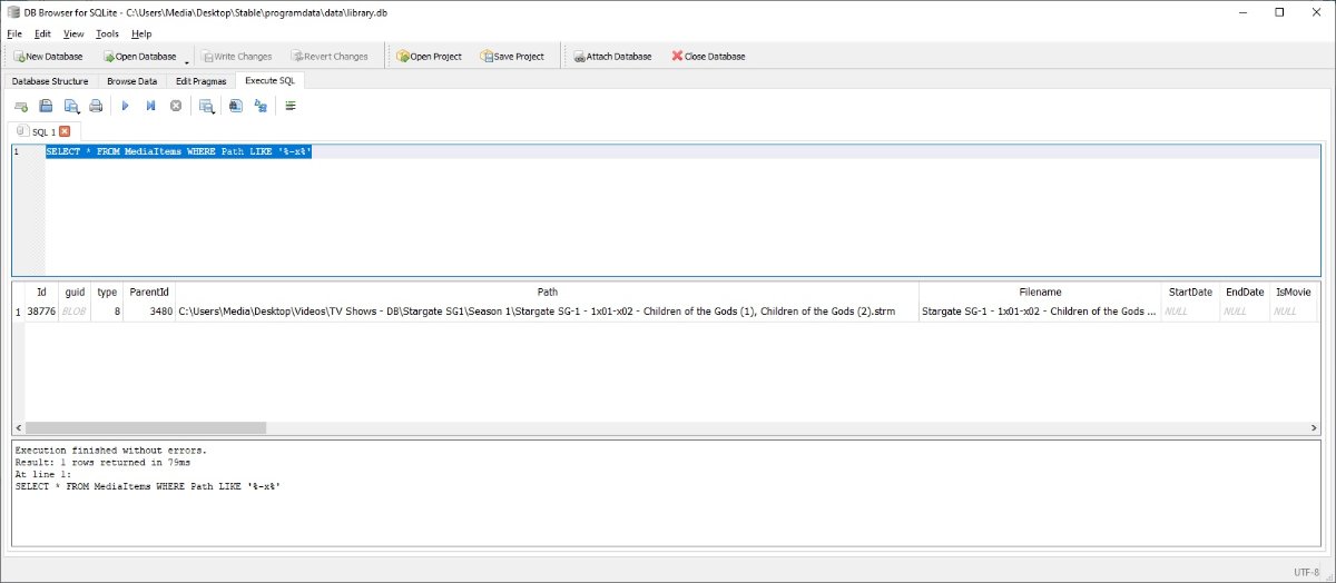

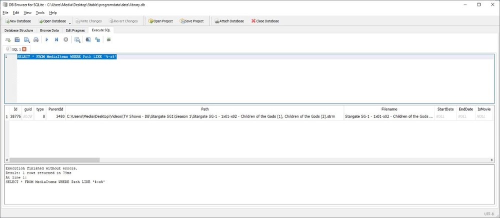

Happy2Play 9799 Posted June 15, 2021 Posted June 15, 2021 (edited) Or make a copy of your library.db run this on your copy in a database viewer. This will show you all your multi-episode items assuming you have used the same naming scheme. SELECT * FROM MediaItems WHERE Path LIKE '%-x%' Edited June 15, 2021 by Happy2Play 1

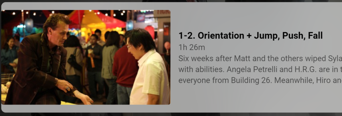

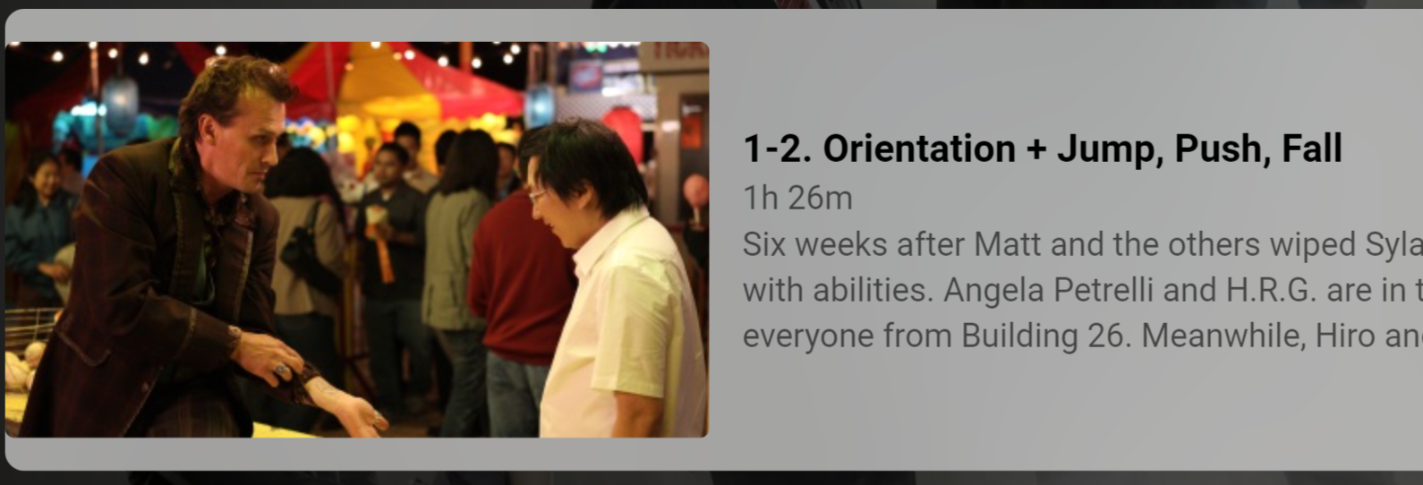

Nuitarius 22 Posted January 20, 2022 Posted January 20, 2022 Hi I have had same issue as OP. I just wanted to share my experience here as it may differ slightly in solution, and also may shine light on how this may be improved if someone gets bored So I ripped Heroes season 4 today and the first disc had only 4 entries, but 5 episodes. It turned out that episode 1 and 2 are bundled together. Weird. This thread helped me figure out what to do, to at least get information enough into Emby so that I would not ponder where episode 2 is. I use TinyMM to scrape for data via tvdb (for shows). I used the accepted naming convention like this "S04E01E02 - Orientation, Jump Push Fall.mkv" TinyMM accepted 2 episodes, but with identical episode naming. After renaming the episodes to the correct names I scraped and an nfo was created. Only 1 nfo though, but it contains both episodes. That was really neat. Emby did not accept this though. So I had to add/change the following: <title>Orientation</title> <originaltitle/> <showtitle>Heroes</showtitle> <season>4</season> <episode>1</episode> to <title>Orientation + Jump, Push, Fall</title> <originaltitle/> <showtitle>Heroes</showtitle> <season>4</season> <episode>1</episode> <episodenumberend>2</episodenumberend> Now I have a better named episode in Emby Maybe this can help others. Thank you all for the assistance
