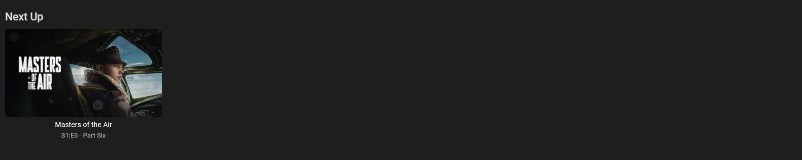

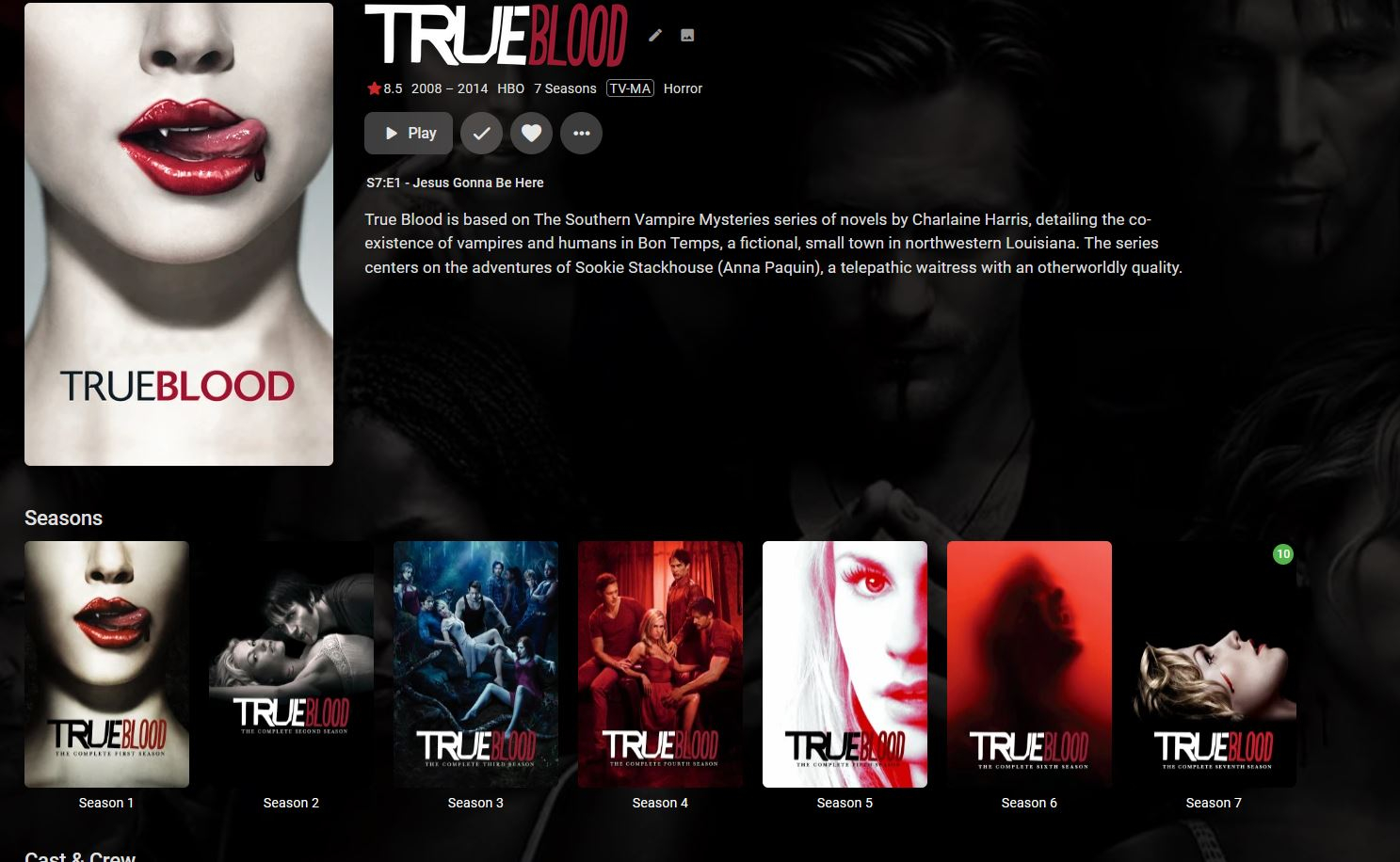

SLMK 19 Posted February 29, 2024 Author Posted February 29, 2024 OK, here is the current next up queue on an account: I've marked 5 episodes of this show as watched, the last is unwatched. Like everything else I have added since the 4.6 update it is correctly showing the unplayed episode in Next Up. However it is the only item in Next Up, the below two old shows have been marked partly watched and do not show up. Older show, two seasons marked watched, one unwatched. No episodes showing in Next Up, s03e01 should be showing. Another, same situation, s07e01 should be showing. Am I mistaken in expecting these to be showing their next unwatched episodes in Next Up? They all used to behave as I am expecting here but ever since 4.6 this has broken down. The update to 4.7 fixed some of them, it appears older shows that have had any episodes added since 4.6 are now fixed for all their episodes, I haven't gone through all of them to confirm this but a number of previously problem shows now work. Shows that were added entirely prior to 4.6 are still showing the symptoms. I can resolve this by deleting a show from the library and re-adding it, however that's pretty disruptive as all watched states are lost for all users and older shows will now be showing as new.

SLMK 19 Posted March 1, 2024 Author Posted March 1, 2024 Hi Luke, dont take this the wrong way, because I do appreciate your time and any help, but have you looked at my examples above and what Ive already written? Thats exactly what I have already said does not work. In the 3 years Ive been dealing with this issue, I have, I promise you, actually watched some of these shows. Both of the old shows Roswell and True Blood in the two screenshots above you can see have had all episodes watched except those in the last season, which should make the first unwatched epidode appear in Next Up but does not. If I do the same procedure in a recently added show it works correctly. Masters of the Air is showing up as expected because it is a recently added show. If I pick any other newly added show at random and mark any episode as watched, the next unwatched episode will appear in Next Up, doing this with any show added solely before 4.6 will not show in Next Up, consistently, no matter how many of them I have watched. If no one has any idea and its never been seen before thats fine, I will have to commit to a library rebuild, but the equivalent of have you tried turning it off and on again isnt really productive.
