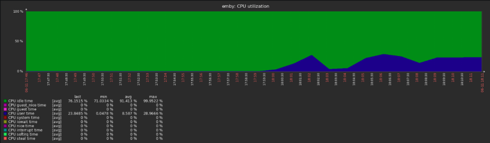

Thuzad 50 Posted June 11, 2021 Posted June 11, 2021 Hello, For some time now, I have noticed that Emby uses a lot of CPU when there is no streaming going on. I've looked at the logs and it doesn't do anything at all at that time. Screenshot monitoring the host server: Screenshot_20210611_181159.png Screenshot monitoring of the Emby container: Screenshot_20210611_181443.png Logs sent by PM to @Luke
Solution Luke 42246 Posted June 11, 2021 Solution Posted June 11, 2021 The realtime monitor is reacting to lots of changed files reported by your file system, so try turning that off and then restarting the server. Also see here: https://support.emby.media/support/solutions/articles/44002210894-corrupt-database
Carlo 4561 Posted June 11, 2021 Posted June 11, 2021 I see the same thing in your logs. If you search for "Info LibraryMonitor:" in the log you will see all the files being refreshed. You also have what looks like a locked database and the link Luke provided will show you an easy way to fix this. Let us know how you make out.

Luke 42246 Posted June 11, 2021 Posted June 11, 2021 No, that's not the library scan. It's exactly what I said - you have the realtime monitor enabled and it is reacting to lots of changes in your files. Try also removing the anime plugin and restarting the server.
