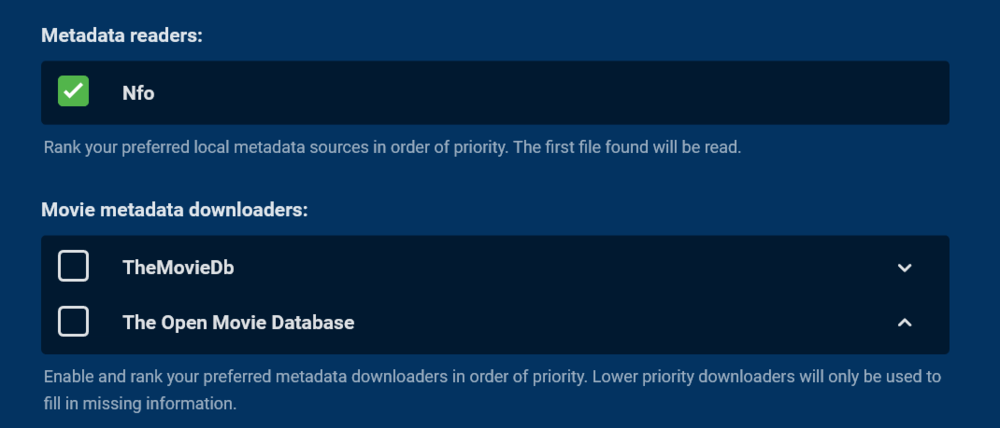

rodainas 191 Posted June 9, 2021 Posted June 9, 2021 I cant get Rotten Tomatoes ratings and local NFO information at the same time, looks like the "Movie Metadata Downloaders" on library settings when activated are overriding the activated "Metadata Readers: nfo" I have enabled on my Movie Library settings "Metadata Readers: nfo" in order for emby to read the contents of my nfo files and If I want to get Rotten Tomatoes ratings I need to enable on my Movie Library Settings: "Movie Metadata downloaders: The Open Movie Database", the thing is when my library is scanning for new content I do get the Rotten Tomatoes ratings but the metadata information within my nfos is ignored, I know this because my metadata is in spanish, so when the new media is added the metadata is in English. The workaround I have found is to uncheck the movie metadata downloaders just leave metadata readers: nfo enabled and when new media is added, I go to Library settings enable Movie Metadata Downloaders: The Open Movie Database, select the newly added entries, select option Refresh Metadata, and Select Search for missing metadata instead of replace all metadata, return to Movie Metadata Downloaders and disable it, wait for a new scan and repeat, with this emby doesnt overwrite the content from my local nfos and adds the rotten tomatoes ratings, I think this should be the normal behavior when local nfos and metadata downloaders are enabled, and not overriding local nfos like emby is currently doing (at least for me). I have my local nfos previously created with all my movie folders. Example: These are library settings I have activated for this matter:

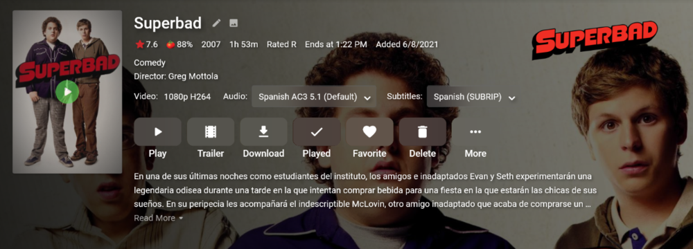

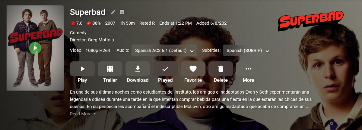

rodainas 191 Posted June 9, 2021 Author Posted June 9, 2021 (edited) @cayars I did it, I can get my local metadata and rotten tomatoes in emby, the problem is I have to do it manually after new media is scanned, having the 2 things enabled at the same time just overrides/ignores local nfos. @LukeMy nfo is ignored because when the two options are enabled and new content is added to the library, the metadata language is english and the metadata inside my nfos is in spanish. I get the same result with the 2 options enabled and doing a Refresh on a selected movie (using the replace option) I get Rotten Tomatoes yes, but the rest of metadata is in english, it just uses the Open Movie Database and ignores the nfo enabled options. This is the result of doing manually: Edited June 9, 2021 by rodainas

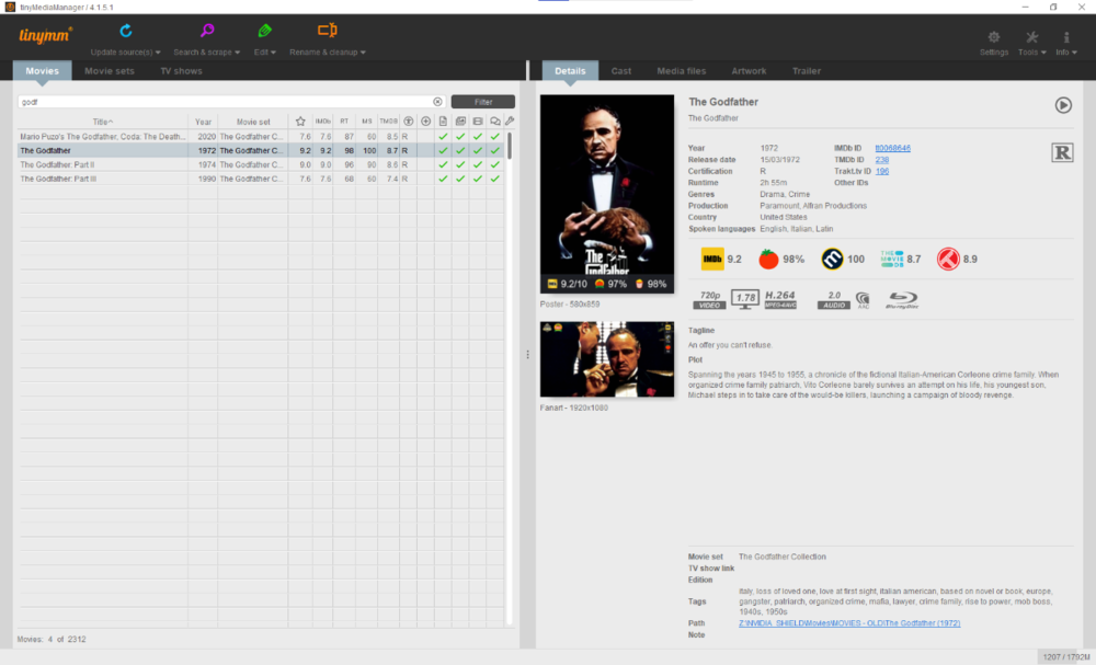

rodainas 191 Posted June 11, 2021 Author Posted June 11, 2021 (edited) @pünktchenjust to let you know I rescraped my nfos using tmm with imdb and rotten tomatoes ratings like this: <ratings> <rating default="false" max="100" name="rottenTomatoes"> <value>95.0</value> <votes>0</votes> </rating> <rating default="true" max="10" name="imdb"> <value>7.5</value> <votes>11837</votes> </rating> </ratings> So I went to emby selected the movie and did a "Refresh Metadata" to force emby to re-read the nfo, but rotten tomatoes is not showing up, using this library options, as you said rotten tomatoes is getting your ratings from your nfo file whether or not rotten tomatoes is the default file, and not from the opendatabase scrapper from emby. But the only way to this day I get the rotten tomatoes rating on emby whether or not is included on the nfo, is activating Open Movie Database within emby itself and refreshing metadata (search missing metadata) with the movie selection. Conclusion I cant get rotten tomatoes to show as critic rating on emby via nfo file as you said is working for you, if I am doing something wrong I appreciate the comments to correct it. Edited June 11, 2021 by rodainas
GrimReaper 4854 Posted June 11, 2021 Posted June 11, 2021 (edited) 14 minutes ago, rodainas said: @pünktchenjust to let you know I rescraped my nfos using tmm with imdb and rotten tomatoes ratings like this: <ratings> <rating default="false" max="100" name="rottenTomatoes"> <value>95.0</value> <votes>0</votes> </rating> <rating default="true" max="10" name="imdb"> <value>7.5</value> <votes>11837</votes> </rating> </ratings> So I went to emby selected the movie and did a "Refresh Metadata" to force emby to re-read the nfo, but rotten tomatoes is not showing up, using this library options, as you said rotten tomatoes is getting your ratings from your nfo file whether or not rotten tomatoes is the default file, and not from the opendatabase scrapper from emby. But the only way to this day I get the rotten tomatoes rating on emby whether or not is included on the nfo, is activating Open Movie Database within emby itself and refreshing metadata (search missing metadata) with the movie selection. Conclusion I cant get rotten tomatoes to show as critic rating on emby via nfo file as you said is working for you, if I am doing something wrong I appreciate the comments to correct it. Rotten Tomatoes tag in your nfo is wrong, it should read "tomatometerallcritics". I also scrape all metadata (ratings included), via TMM (and all Emby internal meta-scrapers disabled) and have no isses with Emby reading them. Edit: <ratings> <rating default="false" max="100" name="metacritic"> <value>100.0</value> <votes>0</votes> </rating> <rating default="false" max="10" name="themoviedb"> <value>8.7</value> <votes>14119</votes> </rating> <rating default="false" max="100" name="tomatometerallcritics"> <value>98.0</value> <votes>1</votes> </rating> <rating default="true" max="10" name="imdb"> <value>9.2</value> <votes>1643254</votes> </rating> <rating default="false" max="10" name="trakt"> <value>8.9</value> <votes>22598</votes> </rating> </ratings> Edited June 11, 2021 by GrimReaper76 Append

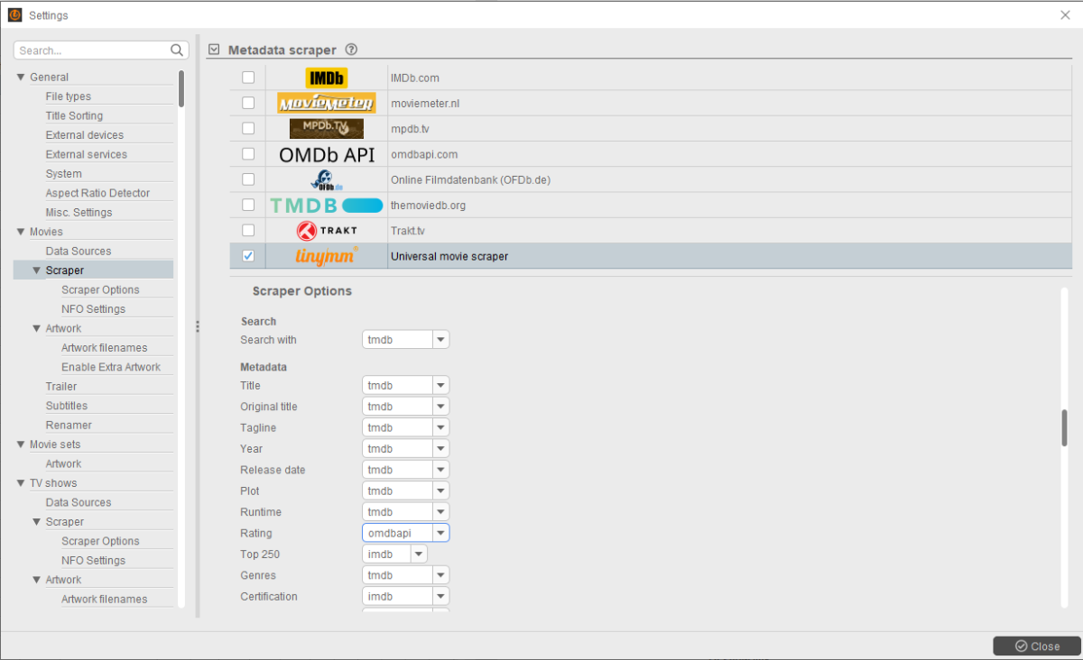

rodainas 191 Posted June 11, 2021 Author Posted June 11, 2021 2 minutes ago, GrimReaper76 said: Rotten Tomatoes tag in your nfo is wrong, it should read "tomatometerallcritics". I scrape all metadata (ratings included), via TMM (and all Emby internal meta-scrapers disabled) and have no isses with Emby reading them. Sure I use TMM too, and thats how it gets via omdb the rattings, could you show me your movie scrapping options for TMM to get the "tomatometerallcritics" or is this edited outside the gui? I appreciate the help.
GrimReaper 4854 Posted June 11, 2021 Posted June 11, 2021 5 minutes ago, rodainas said: Sure I use TMM too, and thats how it gets via omdb the rattings, could you show me your movie scrapping options for TMM to get the "tomatometerallcritics" or is this edited outside the gui? I appreciate the help. Sure, here:
rodainas 191 Posted June 11, 2021 Author Posted June 11, 2021 Thank you for showing me that now I confirmed why I thought. The settings are the same for me, the difference is am on the latest TMM v3 you are on v4.
GrimReaper 4854 Posted June 11, 2021 Posted June 11, 2021 4 minutes ago, rodainas said: Thank you for showing me that now I confirmed why I thought. The settings are the same for me, the difference is am on the latest TMM v3 you are on v4. You could just replace all instances of "rottenTomatoes" with "tomatometerallcritics" in your nfos, then Emby would pick them up.
