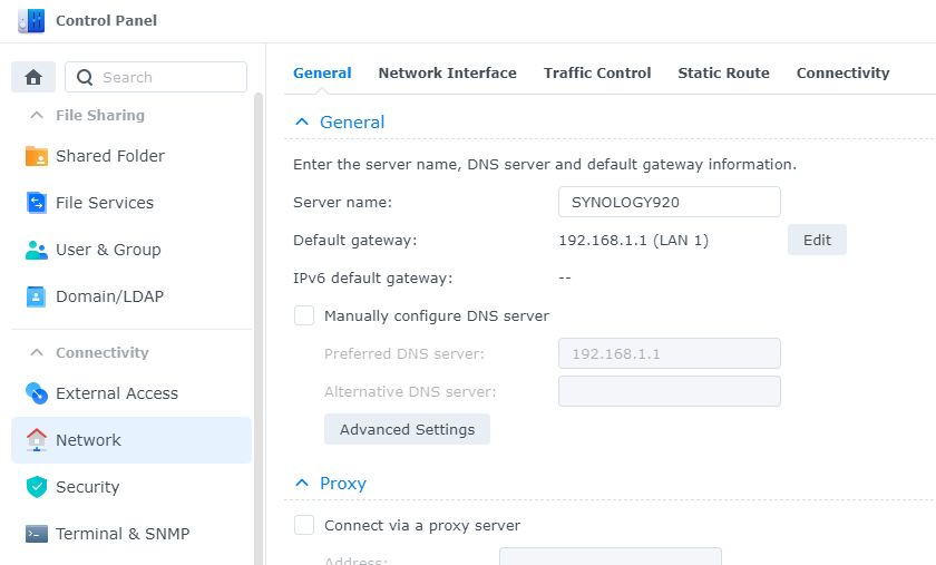

Carlo 4561 Posted June 10, 2021 Posted June 10, 2021 (edited) I have this working on my 920+. First thing I did was rename the box to SYNOLOGY920 so it used all caps. Then I setup the media shares with anonymously (read only) access over the lan so the Shield TV can access them. Then it's just a matter of following the instructions in the KB article: https://emby.media/support/articles/ShieldTV-Direct-File-Access.html Edited November 6, 2025 by GrimReaper KB article link updated

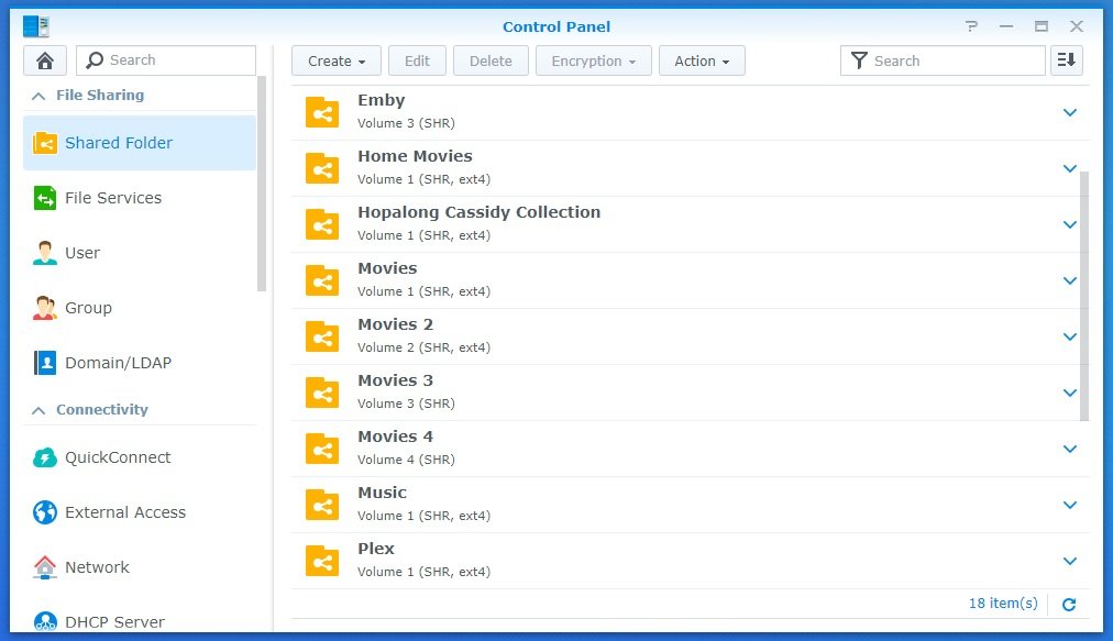

jsc1205 51 Posted June 10, 2021 Author Posted June 10, 2021 (edited) @cayars So do I have to actually change the name of each volume on the synology nas then? volume1 over to Media-A for example? Looking at this now and dont think you can actually change the "name" of the volume on the synology nas. How is yours labeled? Edited June 10, 2021 by jsc1205
Carlo 4561 Posted June 10, 2021 Posted June 10, 2021 (edited) Just to be clear, I'm new to Synology in general as I've only had the 920+ for about a month but have had several different versions of Emby on it as well as DSM 6 & 7 on it. I don't claim to be a Synology expert or anything. My 920+ right now is only for testing and support you could say. I was already famility with Synology before I got it however for general things. My production system runs on Windows Server but I've used the "direct file" play method with it from it's start and used that to write the KB article for the Shield TV. So I'm pretty familiar with the whole process. If you rename the NAS to all caps the volume names shouldn't matter. If you can access any of your media files from any computer on your lan without needing to login it should work. If you want send me a pic of your volume setup, I'll create one to match on my NAS and copy a few movies or shows over and give it a test run. Then I can show you exactly what I configured in Emby and on the Shield. Maybe even add to the KB article if I find anything useful. If you rename the NAS to all caps and restart it, I could also remote in and give you a hand as well if you like. What ever is best for you. Edited June 10, 2021 by cayars

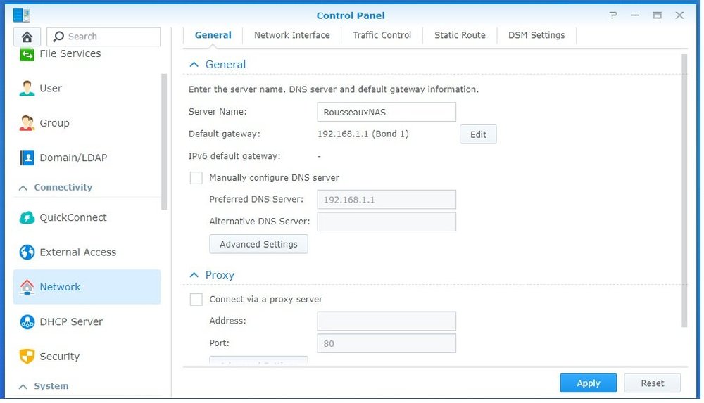

jsc1205 51 Posted June 10, 2021 Author Posted June 10, 2021 @cayarsThanks! Here is a screenshot example of the control panel on my synology nas. Do you recommend changing the nas name to all caps or the emby server name to all caps?.....or does it matter which?
Carlo 4561 Posted June 10, 2021 Posted June 10, 2021 Just the NAS name itself (Server name). Don't know what DSM version you're running but on 7 RC it's in Control Panel->Network menu
Carlo 4561 Posted June 10, 2021 Posted June 10, 2021 That's the place, just rename it using all capital letters and click the apply button. I believe it will want to restart the NAS after that so make sure you've closed out apps or anything that you don't want open during a restart.

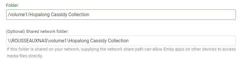

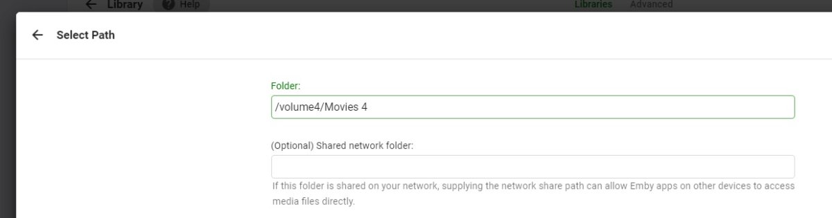

jsc1205 51 Posted June 10, 2021 Author Posted June 10, 2021 Got it! So after changing that, do I just go into the Library and go to each folder setting and add the path under "(Optional) Shared network path"? Do I leave the top entry alone?
Carlo 4561 Posted June 10, 2021 Posted June 10, 2021 Yes, that's it. You will need to verify the files are available on the Shield TV when you create the mount points. You may need to adjust privs on the NAS but you basically got it.
jsc1205 51 Posted June 10, 2021 Author Posted June 10, 2021 (edited) Ok thanks, will give it a shot. Will let you know if I run into issues. Does this look correct then? Edited June 10, 2021 by jsc1205
jsc1205 51 Posted June 10, 2021 Author Posted June 10, 2021 4 minutes ago, cayars said: Yes that seems to look good to me. Ok thanks, just wasn't sure about slashes 1
