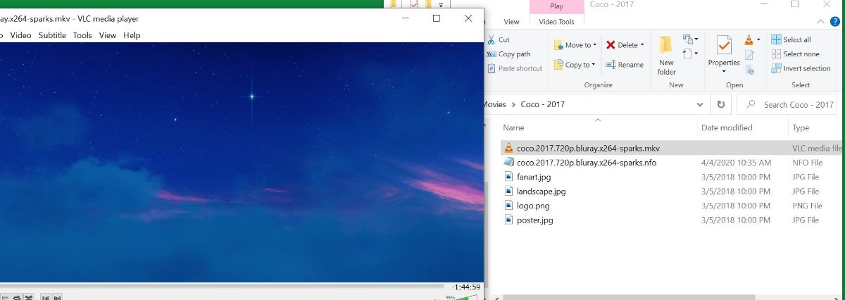

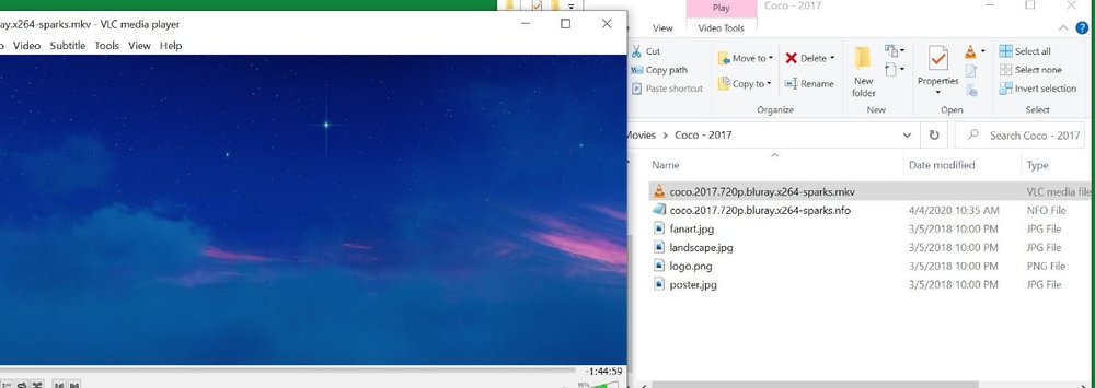

Carlo 4561 Posted June 9, 2021 Posted June 9, 2021 The log file is showing that it can't read the data properly the NAS is giving it. For example the timestamps are invalid. What does a "Coco" from above look like in Windows File Manager?
yamayama 2 Posted June 9, 2021 Author Posted June 9, 2021 Attached a screenshot of CoCo from Windows Explorer. Also, I just tried removing the NFO and JPG files from a different library. When I re-scan that library, nothing happens. Inside the Emby player, the thumbnail is gone which makes sense but I can still play the video fine.
Carlo 4561 Posted June 9, 2021 Posted June 9, 2021 You're screen shot top right shows the problem. Notice there is no date info? If it were me I would be trying to backup the data on this NAS in case a drive or the unit is failing. You should likely try contacting Dlink support to see what they would recommend you do as well.
