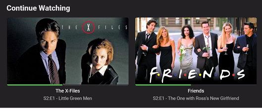

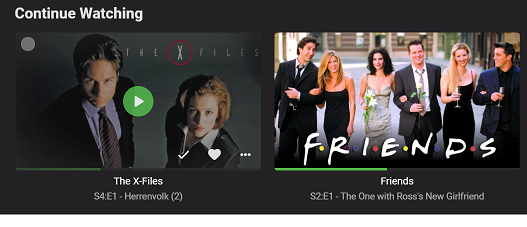

jonomite 29 Posted June 10, 2021 Author Posted June 10, 2021 The basic problem is that TV episodes that I have begun watching but not finished are not displaying properly in my Continue Watching feed. Specifically, in progress TV episodes will either (1) not appear at all in my Continue Watching feed; (2) the wrong episode appears (e.g., I am playing S2E14 but S5E11 displays in the Continue Watching feed); or (3) the TV Episodes will display in the first, and only the first, slot in Continue Watching (e.g., S3E01 is in progress and displays in Continue Watching; then, I start watching S3E02. After I stop watching S3E02 it displays in Continue Watching where S3E01 previously showed up, and S3E01 is no longer anywhere to be found). Here's an example of the third (3) item I described above happening. You can see that S2E1 of X-Files is in progress. I then stop S2E1, start playing S4E1 of the X-files, click into the middle of the episode to ensure that it is in progress, and return to my home screen. You can see below that S4E1 now displays, but S2E1 is nowhere to be found. I next started playing TV episodes from an entirely different TV show. They are not even appearing in Continue Watching at all, so this is the first (1) issue I described above. I cannot take a screenshot of an episode not appearing in my Continue Watching, but I believe this behavior is captured in the log I provided in my first post.

Happy2Play 9800 Posted June 10, 2021 Posted June 10, 2021 3 minutes ago, kbeck said: I have an idea. Leave it alone. A separate Continue and Next Up was perfectly fine the way it was. That is why Next Up Legacy what left as a option. So you have the previous view of both Rows. But there is going to be these issue in a combined view as you have a bunch of partially watched episodes and it will only display one from a Series.
jonomite 29 Posted June 10, 2021 Author Posted June 10, 2021 Hmmm. So, it sounds like I'm actually experiencing normal behavior then? If so, I apologize for creating the confusion. This is just very different from how TV episodes displayed in Continue Watching previously. So, can someone please just clarify for me, is this indeed expected behavior? Is it normal that I won't see TV episodes display in Continue Watching when there is already another in-progress episode for the same series?
Solution Happy2Play 9800 Posted June 10, 2021 Solution Posted June 10, 2021 When there is more then one Continue Watching item for a series yes as the new combined row will only track one item for a series it you want them all then you need to display both rows.
