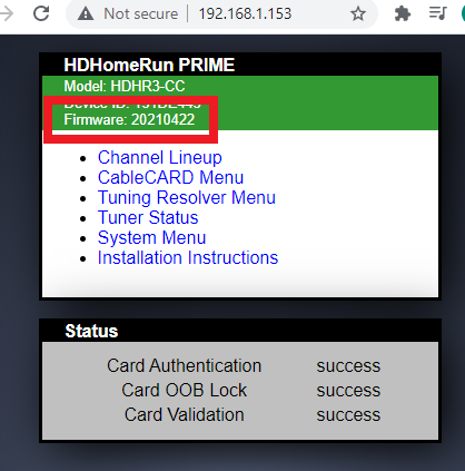

Carlo 4561 Posted June 8, 2021 Posted June 8, 2021 Thanks, I'm in the USA with a Prime as well so I'll do some testing of different interlaced channels as well. Just for good measure can you tell me what firmware version is running on your Prime? You can find this easily in the web view:
roberto188 33 Posted June 8, 2021 Author Posted June 8, 2021 HDHomeRun PRIME Model: HDHR3-CC Firmware: 20210210 For the record the station that has the issue was CBS. 1
