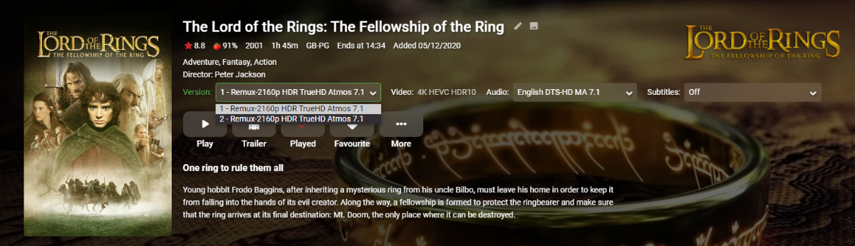

rbjtech 5344 Posted June 8, 2021 Posted June 8, 2021 I have never had great success merging the LOTR remux's via MKVToolNix - it seems to screw up the timing and as a consequence, your ff/rw doesn't work as you have found out. On the 1080p versions I successfully managed to do it by demuxing the streams using EAC3TO, then merging the streams using ffmpeg and then remuxing back together again using MKvtoolnix. For the 4K extended remux however, I didn't bother as frankly nobody is going to watch a 6hr film without a break anyway so I left them as two parts.. I just used the multi-resolution 'feature' to name then Part 1 and Part 2 and you just select the part you want to play (to avoid duplicate entries in the dB/display) 1 1
VJzenzub 2 Posted June 9, 2021 Author Posted June 9, 2021 Thanks again for the follow-up @cayars. @rbjtechThe part that really throws me is my 'part 1' and 'part 2' files are also freezing out after a fast forward. So even with merging/appending totally out of the equation, I'm getting a similar symptom. Thanks for showing the sweet trick with the multi-resolution selection box. You're darn right, duplicate entries be damned.
