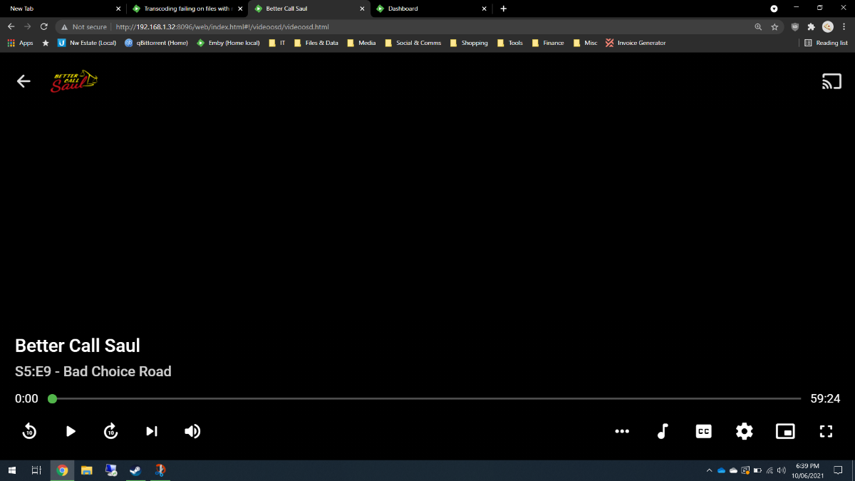

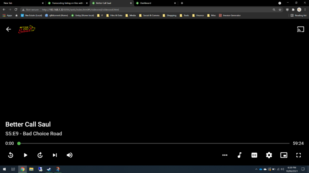

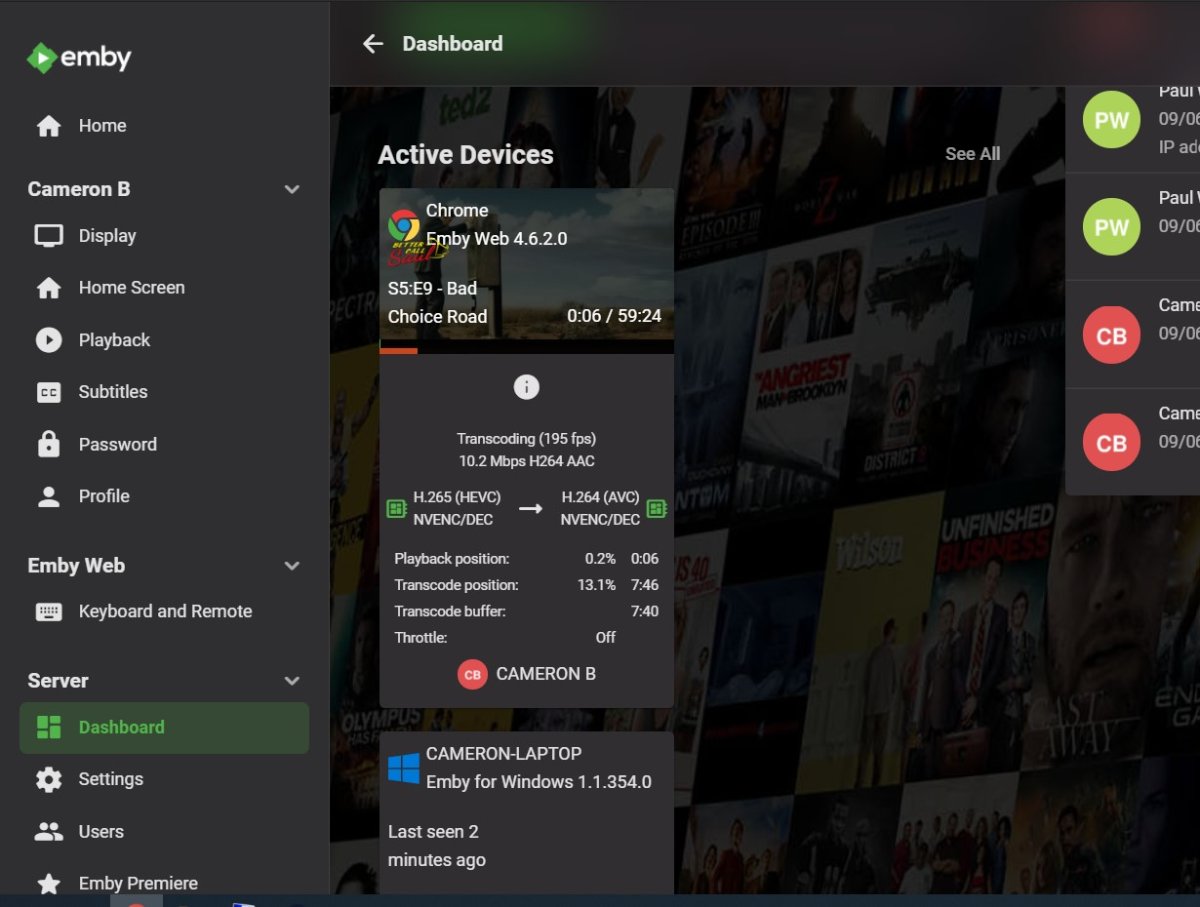

cjkbarnett 1 Posted June 6, 2021 Author Posted June 6, 2021 Hi all, Unfortunately the new update has broken playback on my server(s). No clients on chrome (And that's what most of them use) can playback any media. Sometimes it works, but is very glitchy, but only if you attempt serval media files. Direct play through the emby app works mint. This problem is across both of my servers. Both have nvida GPUs, one is intel, the other AMD This is only happening when any media requires transcoding. Mostly just with .265 files, which is what most of my library is made of. I have attached a screenshot of what it looks like when trying to play, and also added logs. embyserver.txt ffmpeg-transcode-5698584c-1d5d-4701-ba97-6fe3b7242dda_1.txt
Luke 42203 Posted June 6, 2021 Posted June 6, 2021 Hi there, make sure your nvidia drivers are fully up to date. if that doesn't help, then as a test, try turning off hardware transcoding in server transcoding settings and see if that helps.

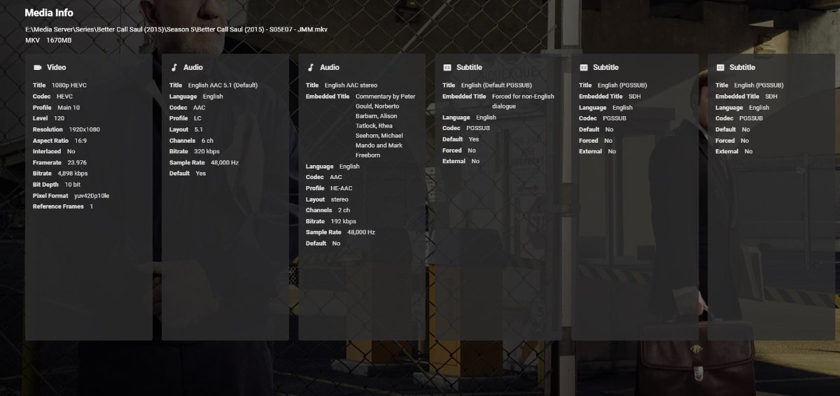

Carlo 4561 Posted June 6, 2021 Posted June 6, 2021 Hi, in order to rollback you would need to have a complete backup of your Emby Server folder so that you could restore it as it was. Can you show the Media Info screen for this Better Call Saul episode (bottom of episode detail screen). If you turn off hardware transcoding does it play correctly when software transcoded?

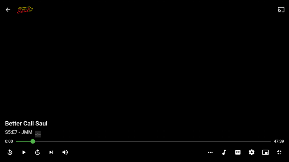

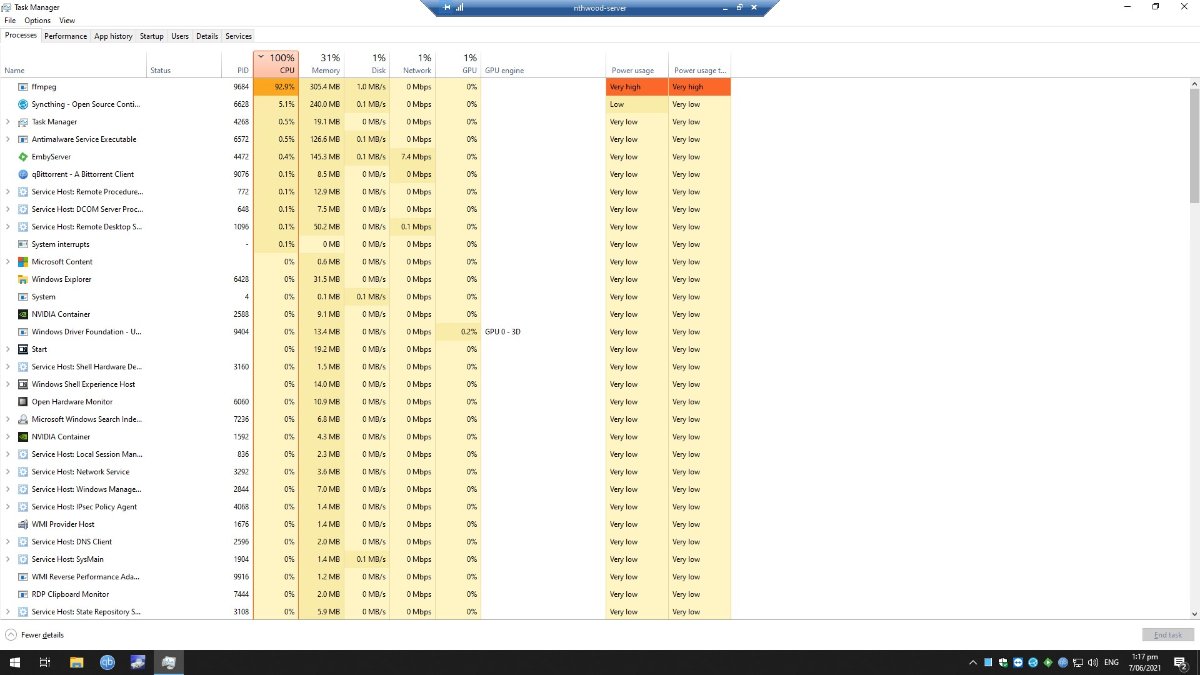

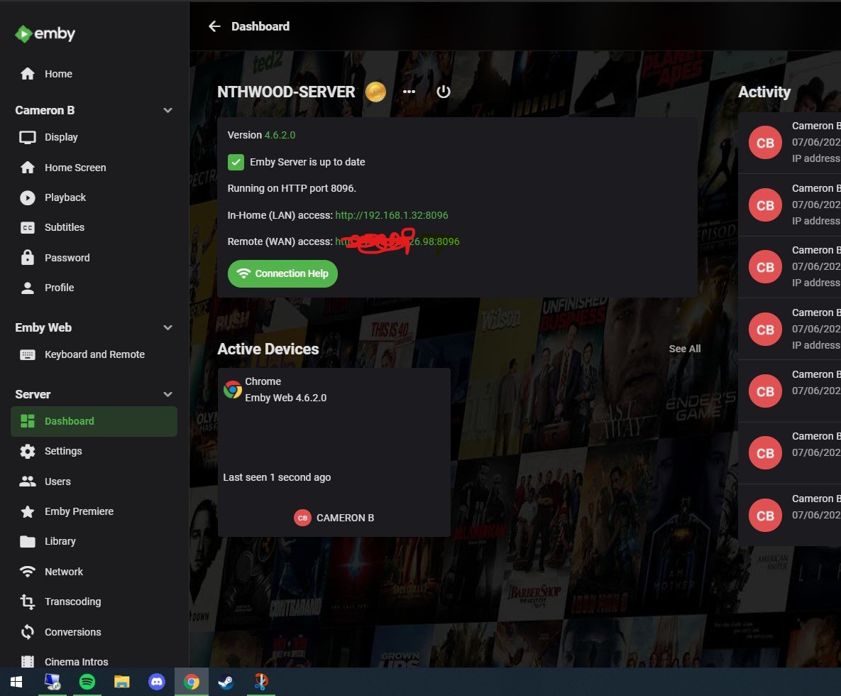

cjkbarnett 1 Posted June 7, 2021 Author Posted June 7, 2021 (edited) So it gets weirder. Other accounts can play that file just fine, but when i attempt it on the admin profile (Mine) it hangs. I tired everything, changing drivers, changing transcode settings, rebooting the server, rescanning the library and restarting emby after every change. I noticed that it ffmpeg ramped the cpu up to 100 percent when attempting to play it too, was odd because it did that even when i selected hardware transcoding (gpu). Emby also wouldn't show the client on the activity dashboard either. Then i decided to mark the whole series as played, then unplayed and lo and behold, it worked! Seems some items with resume data from the old version of emby don't want to play nice, and causes transcoding to fail! It seems ok for now, it there any way i can bulk clear the watched status or rebuild it for all my users? Or is it a case of logging into each one and doing it manually? I've attached some screenshots below. Cheers Edited June 7, 2021 by cjkbarnett Clarity

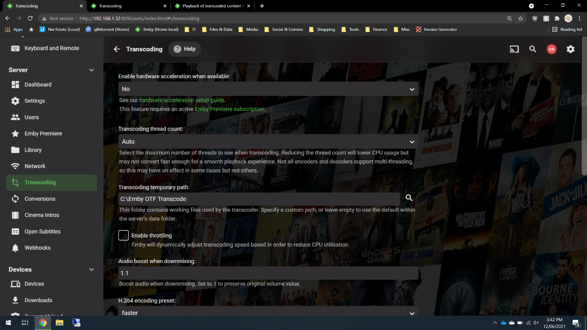

Luke 42203 Posted June 10, 2021 Posted June 10, 2021 Did you try turning off hardware transcoding? Can we please see a log example of that? Thanks.

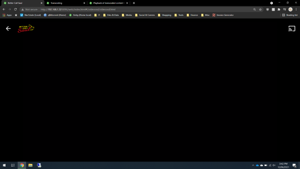

cjkbarnett 1 Posted June 12, 2021 Author Posted June 12, 2021 On 6/10/2021 at 11:57 PM, cayars said: Hi, What server version are you currently running? Hiya, apologies for the slow reply, i have been away. I am running the latest stable release - 4.6.2.0 on both of my servers. On 6/11/2021 at 4:45 AM, Luke said: Did you try turning off hardware transcoding? Can we please see a log example of that? Thanks. I did, and for some reason when hardware transcoding is disabled, the play controls disappear from the web player. (example attached). But, if it is any good news, hardware decoding seems to be playing well for the moment. I cannot seem to reliably replicate it...the worst type of issue!
Luke 42203 Posted June 16, 2021 Posted June 16, 2021 Quote I did, and for some reason when hardware transcoding is disabled, the play controls disappear from the web player. (example attached). Hi, it's not that they've disappeared, it's that they're not available until playback successfully starts. We'd have to look at an example, but it could be that with hardware transcoding disabled your server just can't transcode it quickly enough.
cjkbarnett 1 Posted June 19, 2021 Author Posted June 19, 2021 On 6/17/2021 at 8:02 AM, Luke said: Hi, it's not that they've disappeared, it's that they're not available until playback successfully starts. Ahh ok that makes On 6/17/2021 at 8:02 AM, Luke said: We'd have to look at an example, but it could be that with hardware transcoding disabled your server just can't transcode it quickly enough. Its never had an issue transcoding before, but i seem to have found part of the issue. Its when it tries to auto select the quality through the web player. If i manually force a quality setting then it seems to play fine. After it starts playing, i can toggle it back to auto and it resumes. Its only eve off a cold start it does this
