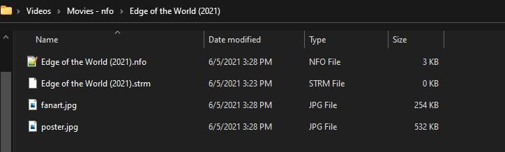

judgey 13 Posted June 5, 2021 Author Posted June 5, 2021 (edited) Also got a different problem ill post here but if u want me to make a new post i will... I keep getting fanart even tho the plugin has been uninstalled, i restarted emby and the server but im still get fanart. Is that the way its meant to be? Thanks EDIT - Even when u click identify you pick the right film but it just goes back to what it was Edited June 5, 2021 by judgey
Luke 42246 Posted June 5, 2021 Posted June 5, 2021 2 hours ago, judgey said: Also got a different problem ill post here but if u want me to make a new post i will... I keep getting fanart even tho the plugin has been uninstalled, i restarted emby and the server but im still get fanart. Is that the way its meant to be? Thanks EDIT - Even when u click identify you pick the right film but it just goes back to what it was Please go over a specific example and attach the corresponding emby server log from when the problem was experienced. thanks.
Happy2Play 9813 Posted June 5, 2021 Posted June 5, 2021 3 hours ago, judgey said: I keep getting fanart even tho the plugin has been uninstalled, i restarted emby and the server but im still get fanart. Is that the way its meant to be? Fanart/Backdrop can come from any provider. So if you do not want them you need to set them to 0 in Fetcher Setting per library.
judgey 13 Posted June 5, 2021 Author Posted June 5, 2021 (edited) Hey guys, if i change it to 0 will that stop all images? here is a video of what i mean.... its not just that film its just random films i add Edited June 5, 2021 by judgey
Happy2Play 9813 Posted June 5, 2021 Posted June 5, 2021 (edited) Got the server log for that video demo? But the issue is your are not getting a poster image as that is the proper backdrop/fanart per TMDB. Edge of the World (2021) - Backdrops — The Movie Database (TMDb) (themoviedb.org) But I had no issue with that movie, and your settings. Edited June 5, 2021 by Happy2Play
judgey 13 Posted June 5, 2021 Author Posted June 5, 2021 (edited) Its mad because it only started happening when i moved the order of "movie image fetchers" settings, i moved fanart to top then changed my mind and moved it back to how it was, then the problems started. On my other server everything is fine as i not touched them settings. here is log thank u Edited June 6, 2021 by judgey

Happy2Play 9813 Posted June 5, 2021 Posted June 5, 2021 3 minutes ago, judgey said: Yer i thought that was the problem, changed permissions and still the problem is there. Ill un solve for now EDIT can not un-solve sorry Done If you go to Edit images on that movie will it find and save a Primary image?
judgey 13 Posted June 5, 2021 Author Posted June 5, 2021 (edited) Here is log after restart and debug on and permission fixed. No primary image its emby everything is just that fanart image. Edited June 6, 2021 by judgey
Happy2Play 9813 Posted June 5, 2021 Posted June 5, 2021 23 minutes ago, judgey said: Here is log after restart and debug on and permission fixed. No primary image its emby everything is just that fanart image. embyserver (5).txt 199.69 kB · 0 downloads You can see it fail to get poster from OMDB/doesn't exist, but don't see any tries from TMDB. 2021-06-06 01:12:47.668 Debug App: ConvertImageToLocal item 173128 - image url: https://img.omdbapi.com/?i=tt3006472&apikey=fe53f97e 2021-06-06 01:12:47.670 Info HttpClient: GET https://img.omdbapi.com/?i=tt3006472&apikey=fe53f97e 2021-06-06 01:12:47.762 Error Server: Error processing request *** Error Report *** Version: 4.6.2.0 Command line: /opt/emby-server/system/EmbyServer.dll -programdata /var/lib/emby -ffdetect /opt/emby-server/bin/ffdetect -ffmpeg /opt/emby-server/bin/ffmpeg -ffprobe /opt/emby-server/bin/ffprobe -restartexitcode 3 -updatepackage emby-server-deb_{version}_amd64.deb Operating system: Linux version 5.4.0-74-generic (buildd@lgw01-amd64-038) (gcc version 9.3.0 (Ubuntu 9.3.0-17ubuntu1~20.04)) #83-Ubuntu SMP Sat May 8 02:35:39 UTC 2021 Framework: .NET Core 3.1.13 OS/Process: x64/x64 Runtime: opt/emby-server/system/System.Private.CoreLib.dll Processor count: 12 Data path: /var/lib/emby Application path: /opt/emby-server/system System.InvalidOperationException: System.InvalidOperationException: Operation is not valid due to the current state of the object. at Emby.Server.Implementations.Library.LibraryManager.ConvertImageToLocal(BaseItem item, ItemImageInfo image, Int32 imageIndex, CancellationToken cancellationToken) at Emby.Drawing.ImageProcessor.ProcessImage(ImageProcessingOptions options, CancellationToken cancellationToken) at MediaBrowser.Api.Images.ImageService.GetImage(ImageRequest request, Int64 itemId, BaseItem item, Boolean isHeadRequest) at Emby.Server.Implementations.Services.ServiceController.GetTaskResult(Task task) at Emby.Server.Implementations.Services.ServiceHandler.ProcessRequestAsync(HttpListenerHost appHost, IRequest httpReq, IResponse httpRes, RestPath restPath, String responseContentType, CancellationToken cancellationToken) at Emby.Server.Implementations.HttpServer.HttpListenerHost.RequestHandler(IRequest httpReq, ReadOnlyMemory`1 urlString, ReadOnlyMemory`1 localPath, CancellationToken cancellationToken) Source: Emby.Server.Implementations TargetSite: Void MoveNext() If you selected Edit Image and clicked the search icon for Primary image is one found?
judgey 13 Posted June 5, 2021 Author Posted June 5, 2021 Hey, yes that works i can pick the right image if i search.
Happy2Play 9813 Posted June 5, 2021 Posted June 5, 2021 You still have a permission issue but separate from this not getting poster issue. 2021-06-06 01:12:58.096 Debug App: ConvertImageToLocal item 173128 - image url: https://image.tmdb.org/t/p/original/lPcDU9Mt1SO4pW00K8L9a7pgMi5.jpg 2021-06-06 01:12:58.096 Info HttpClient: GET https://image.tmdb.org/t/p/original/lPcDU9Mt1SO4pW00K8L9a7pgMi5.jpg 2021-06-06 01:12:58.301 Debug ProviderManager: Saving image to /home/judgey/rclone/gmedia/new films/Edge of the World (2021)/fanart.jpg 2021-06-06 01:12:58.303 Error ProviderManager: UnauthorizedAccessException: Emby Server is being write access to /home/judgey/rclone/gmedia/new films/Edge of the World (2021)/fanart.jpg. Please check your file permissions. 2021-06-06 01:12:58.303 Debug ProviderManager: Saving image to /var/lib/emby/metadata/library/b3/b335915d44293e4f0d22df1535e6da03/fanart.jpg You should see the same for the Poster you just saved also.
