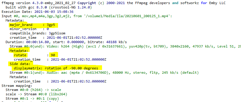

Happy2Play 9812 Posted June 15, 2021 Posted June 15, 2021 May need @softworkz for this. 15:08:36.019 Stream mapping: 15:08:36.019 Stream #0:0 (h264) -> scale_vaapi 15:08:36.019 scale_vaapi -> Stream #0:0 (h264_vaapi) 15:08:36.019 Stream #0:1 -> #0:1 (copy) 15:08:36.019 Press [q] to stop, [?] for help 15:08:36.065 Impossible to convert between the formats supported by the filter 'transpose' and the filter 'auto_scaler_0' 15:08:36.065 Error reinitializing filters! 15:08:36.065 Failed to inject frame into filter network: Function not implemented 15:08:36.065 Error while processing the decoded data for stream #0:0 15:08:36.098 Conversion failed!
softworkz 5133 Posted June 16, 2021 Posted June 16, 2021 @DJX - What kind of video is this, where did you get it from? From a smartphone? The point is this: It seems that ffmpeg has some automatism to insert a transpose filter to apply the display matrix (90° rotation). The transpose filter is a software filter, that's why its insertion fails in the initial transcoding pipeline (because it's a pure hw pipeline). In case of the subsequent (sw-fallback-)attempt, its insertion works as it's all sw processing. To be honest: this is the first time that I'm seeing this, and I don't have a plan yet for dealing with it. My very first thought is more like: nice that it's getting handled by sw fallback at least..
DJX 18 Posted June 16, 2021 Author Posted June 16, 2021 3 hours ago, softworkz said: @DJX - What kind of video is this, where did you get it from? From a smartphone? The point is this: It seems that ffmpeg has some automatism to insert a transpose filter to apply the display matrix (90° rotation). The transpose filter is a software filter, that's why its insertion fails in the initial transcoding pipeline (because it's a pure hw pipeline). In case of the subsequent (sw-fallback-)attempt, its insertion works as it's all sw processing. To be honest: this is the first time that I'm seeing this, and I don't have a plan yet for dealing with it. My very first thought is more like: nice that it's getting handled by sw fallback at least.. Yes, my videos are 4K taken from a Samsung s21+. I've just tried the encoding/decoding again and ticked VAAPI for h264/265 for both. This time the dashboard shows it working correctly with VAAPI>VAAPI. So I think its working fine for me now! Thanks! 1
