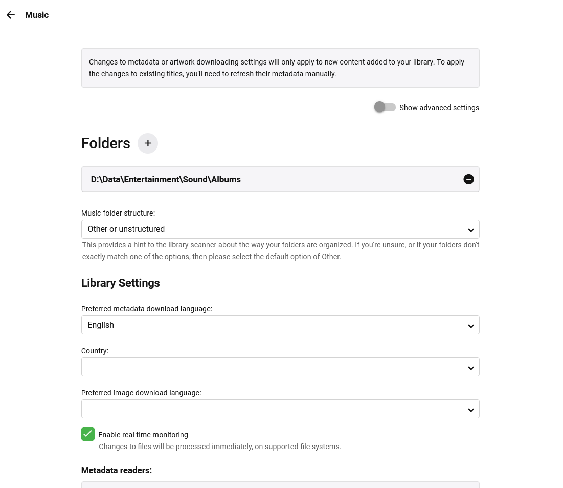

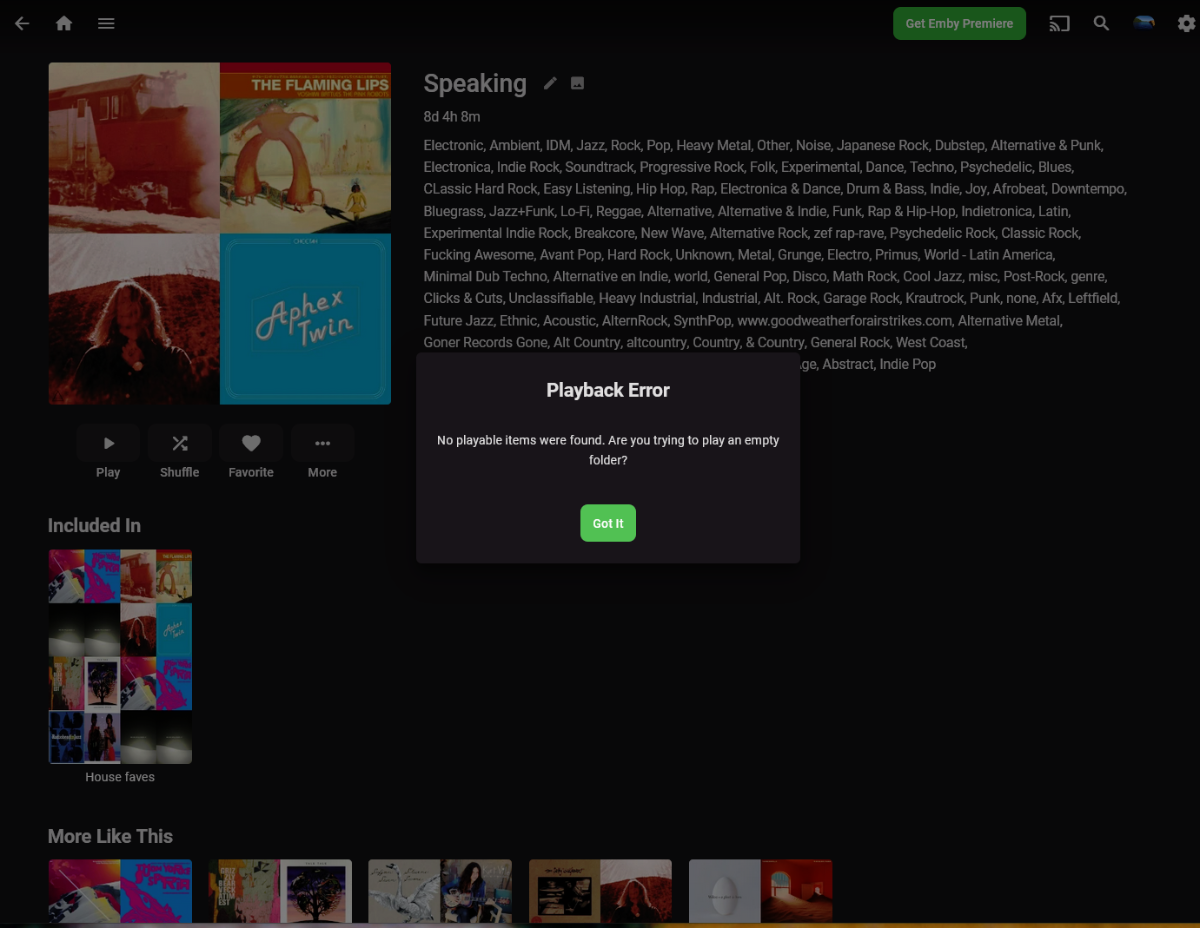

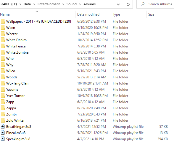

Wavecrest 4 Posted June 7, 2021 Posted June 7, 2021 (edited) Hi, thanks for the instruction. Per my prior post, I had already tried doing that. Just tried again. Unfortunately I am still having the same problem with the m3u8 playlists that I had imported from Plex. (The ones that I created in Emby are working fine now.) No tracks are appearing under those m3u8 playlists. Below are three images, showing, in order: The error I'm getting when I try to open and play one of those playlists; The location of the those m3u8 files in my filesystem; and My Emby library settings showing that location selected as my music folder. What else can I try please? Would it be a terrible idea to cut & paste those m3u8 files into the folder where the Emby-created .xml playlists live? That seems to be C:\Users\[username]\AppData\Roaming\Emby-Server\programdata\data\playlists. Edited June 7, 2021 by Wavecrest Posted too early without enough info.

Happy2Play 9840 Posted June 8, 2021 Posted June 8, 2021 (edited) 23 minutes ago, Wavecrest said: Sure, here's one of the files.Pineal.m3u8 It was working fine in Emby a week ago. And this still plays for me in Winamp. I am guessing Emby has no idea what those partial paths are to each of those tracks. Full Path to track needs to appear for each track just like it does in the Emby xml playlist file. Without specific path then playlists break as you already see. Edited June 8, 2021 by Happy2Play

Happy2Play 9840 Posted June 8, 2021 Posted June 8, 2021 Luke will have to comment, but I am pretty sure playlists have always had to have full path or be next to the files (same folder). In this case since the media is in multiple different folders full path is required. Just like if you were to make that same playlist in Emby the xml file would have the full path to the items. There is no way really to compare how one programs treats the m3u vs Emby. All items are in the database by full path so "Avett Bros\Four Thieves Gone\09 - The Avett Brothers - Matrimony - 2006.mp3" will not equal true path "D:\Data\Entertainment\Sound\Albums\Avett Bros\Four Thieves Gone\09 - The Avett Brothers - Matrimony - 2006.mp3".

Happy2Play 9840 Posted June 8, 2021 Posted June 8, 2021 Just now, Wavecrest said: They are. No the playlist is in Albums and all the media is in there own subfolder ie not next to physical media.
