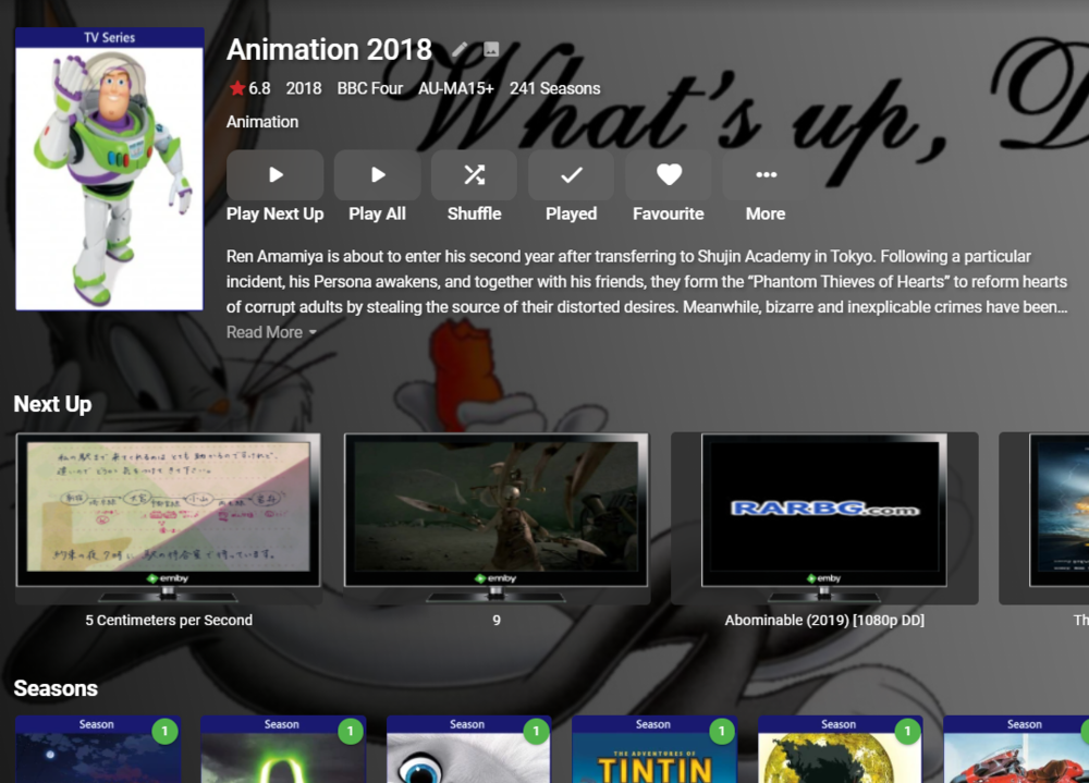

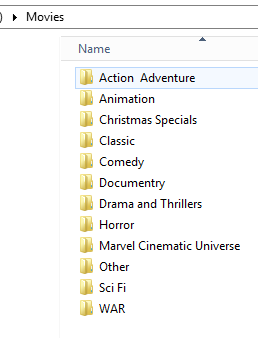

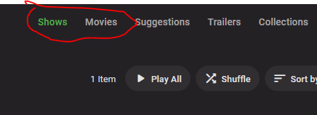

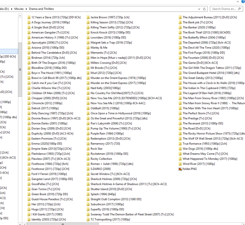

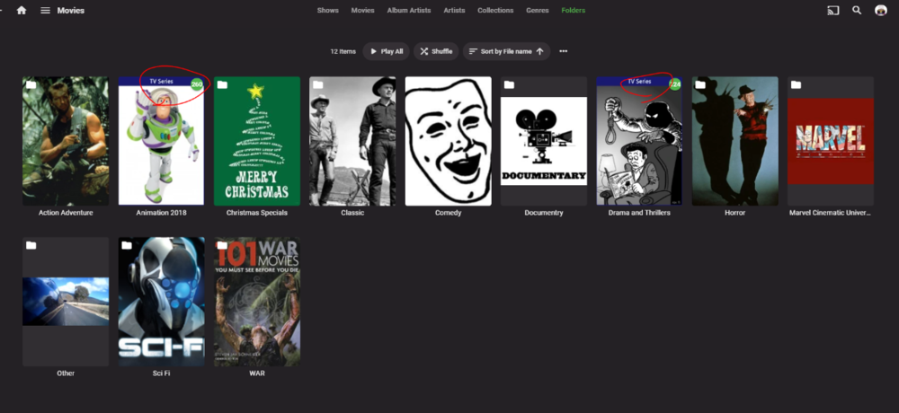

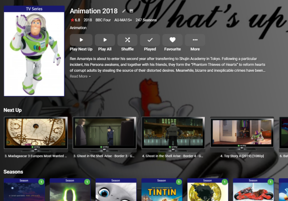

DUG 3 Posted June 3, 2021 Posted June 3, 2021 Hi After a recent full library scan, a couple of my movie sub folders are now registering as TV series within the Movies Library. I use an old legacy file structure to simplify content sharing instead of a flat structure. it even identified the animation folder as a tv show or something and tagged movies as episodes I started removing the " - " from any movies names to avoid them being seen as versions, I haven't noticed any change yet. please help
