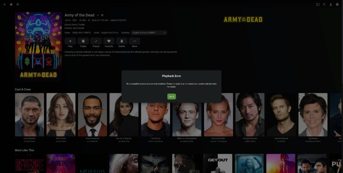

Cphusion 3 Posted June 3, 2021 Posted June 3, 2021 (edited) When I open a movie in my Emby library there is a button "Trailer", when I click on it I get an error: " No compatible streams are currently available. Please try again later or contact your system administrator for details." I have already installed the plugin "Trailers" but that plugin only seems to be an addition to cinematic mode and doesn't do anything for streaming trailers for movies in your library. I don't see any useful errors in my log file, all I see is this. Quote 2021-06-03 09:38:12.938 Info Server: http/1.1 GET http://emby.example.com/Users/a7046292568c4dafafb5ab37fde5a6f6?X-Emby-Client=Emby Web&X-Emby-Device-Name=Firefox&X-Emby-Device-Id=c196d44c-65c6-47cc-a144-a3e454951a1e&X-Emby-Client-Version=4.6.1.0. UserAgent: Mozilla/5.0 (X11; Linux x86_64; rv:89.0) Gecko/20100101 Firefox/89.0 2021-06-03 09:38:12.966 Info Server: http/1.1 Response 200 to 10.31.251.11. Time: 28ms. http://emby.example.com/Users/a7046292568c4dafafb5ab37fde5a6f6?X-Emby-Client=Emby Web&X-Emby-Device-Name=Firefox&X-Emby-Device-Id=c196d44c-65c6-47cc-a144-a3e454951a1e&X-Emby-Client-Version=4.6.1.0 How do I get the "Trailer" button to stream(I don't have local files for trailers) the trailer of a movie? Edited June 3, 2021 by Cphusion

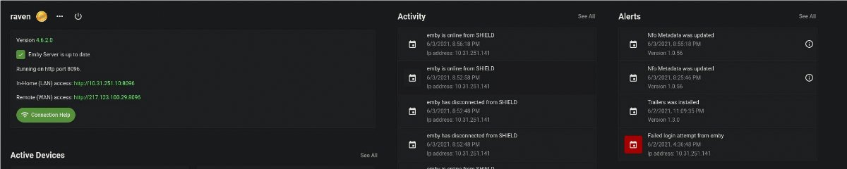

Cphusion 3 Posted June 3, 2021 Author Posted June 3, 2021 It looks like the plugin was updated(see attachment) and I did a library rescan but the trailers still don't work.
Happy2Play 9802 Posted June 3, 2021 Posted June 3, 2021 I just added Army of the Dead with your nfo file and it played without issue, where it failed before the update. 1 1
