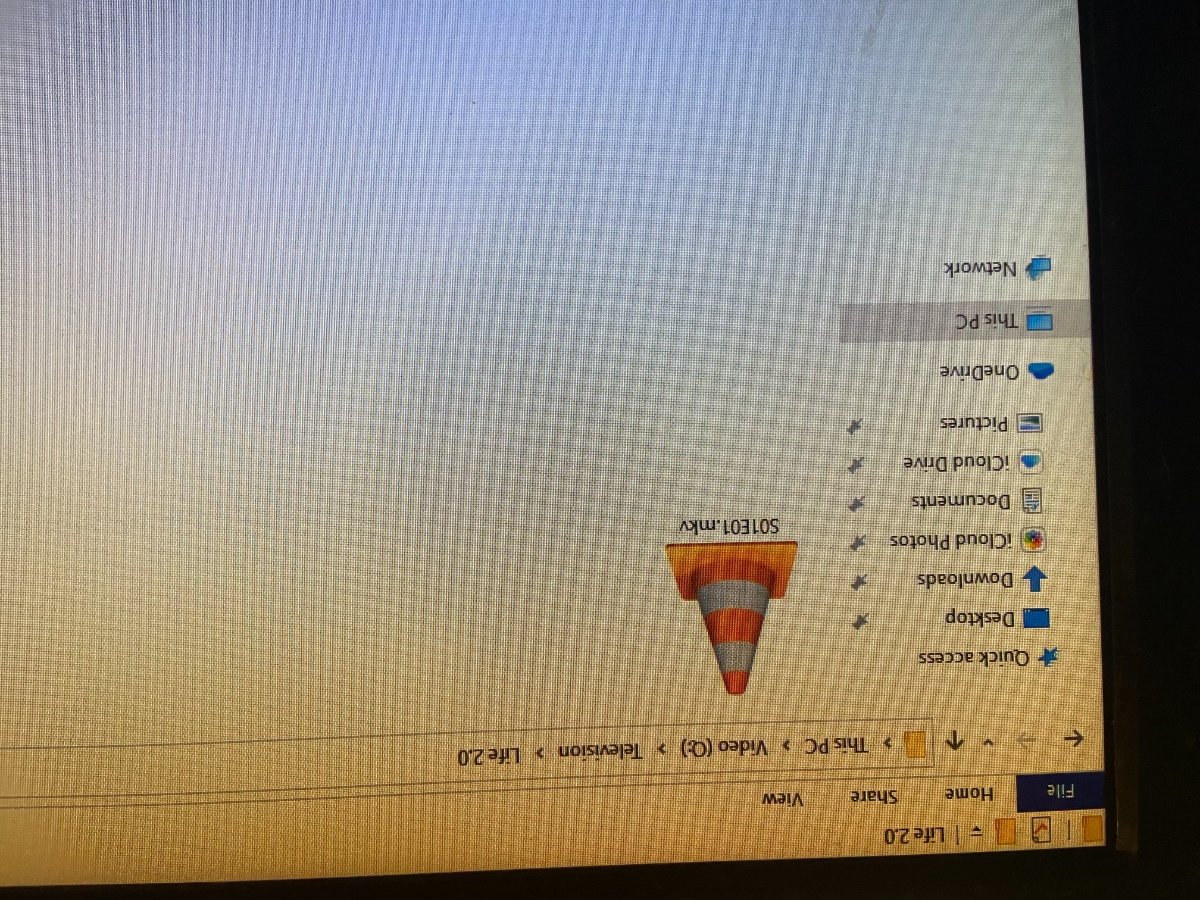

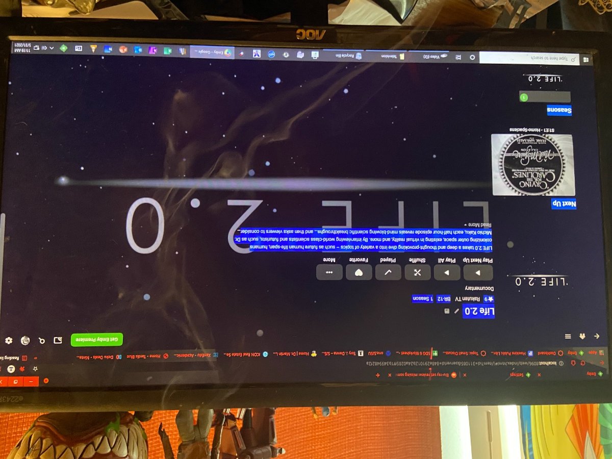

thesnappysneezer 2 Posted May 31, 2021 Posted May 31, 2021 3 minutes ago, zivt said: like this and its not my provider, its themoviedb.org I just created a folder in my television folder called Life 2.0 and dropped a file in there, renaming it S01E01 and Emby found a show to match it. Is this the version you are looking for? (Sorry if the photo is upside down, when adding a photo here mine always show upside down for some reason.)

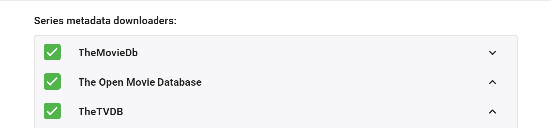

zivt 3 Posted May 31, 2021 Author Posted May 31, 2021 Than maybe the problem in my hierarchy in emby Is yours different ?
Luke 42203 Posted May 31, 2021 Posted May 31, 2021 2 minutes ago, zivt said: Than maybe the problem in my hierarchy in emby Is yours different ? The default is tvdb first.
zivt 3 Posted May 31, 2021 Author Posted May 31, 2021 I need the moviedb first there is a mistake there i will try to fix it thanks tal 1
