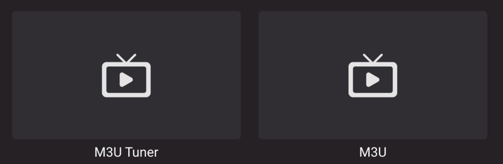

thegrunge 29 Posted May 30, 2021 Posted May 30, 2021 Hello, I'm trying to add tv channels to my m3u list and emby don't want to see them. Even when creating a new m3u file it does not see its contents. Everything that was already in my file is still recognized, and functional, but that's it. I also noticed that my lists already add an emby before the last update for the name of m3u tuner, but when I add a new one, it only bears the name of m3u.
