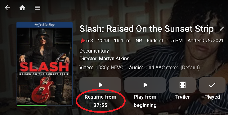

kurtgschumacher 36 Posted May 29, 2021 Author Posted May 29, 2021 cayars: When I saw your image I realized that all the videos I have been having the problem with are TV episodes, not movies. (Because I've been mostly watching TV and not many movies lately.) The problem does not occur with movies, only with TV episodes. Happy2Play: Yes, the action still causes Continue Watching. I do not have the Trakt plugin installed.

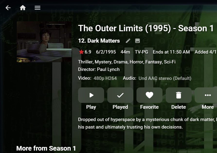

kurtgschumacher 36 Posted May 29, 2021 Author Posted May 29, 2021 Here is a what the episode looks like after viewing for 1:30. I don't know what you mean by "what your row looks like"... what row are you referring to?

ebr 16309 Posted May 29, 2021 Posted May 29, 2021 2 hours ago, kurtgschumacher said: Here is a what the episode looks like after viewing for 1:30. I don't know what you mean by "what your row looks like"... what row are you referring to? That item does not have a resume point set - and it shouldn't based on what you told us. 1:30 is only about 3.5% of 44 minutes.

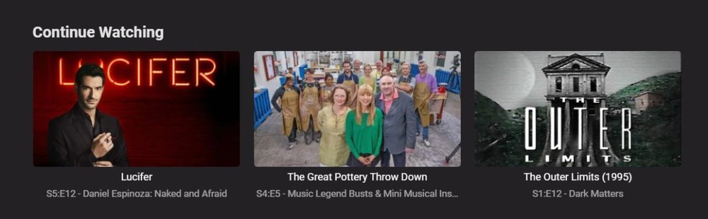

ebr 16309 Posted May 29, 2021 Posted May 29, 2021 Just now, kurtgschumacher said: ebr: That's not the issue. The problem is that the episode shows up in Continue Watching when it does not have a resume point set. Okay, then can we please see a screen shot of that (your Continue Watching row)?
kurtgschumacher 36 Posted May 29, 2021 Author Posted May 29, 2021 Here it is, do you believe me now? The first two were run for only a few seconds, the last for 1:30.

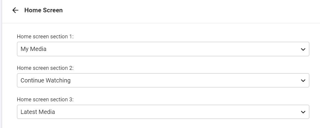

Happy2Play 9802 Posted May 29, 2021 Posted May 29, 2021 (edited) And can you post your Home Screen setting. Honestly look like the current merged Continue Watching/Next Up. Edited May 29, 2021 by Happy2Play
Happy2Play 9802 Posted May 29, 2021 Posted May 29, 2021 1 minute ago, kurtgschumacher said: Can you show a larger screenshot of section 1 (only the top). But to me if I read this right look like the current merged Continue Watching/Next Up.
kurtgschumacher 36 Posted May 29, 2021 Author Posted May 29, 2021 It would have been easier to do that screenshot if you had said that was all you wanted. Please be more specific in the future to save us both time. And I had said earlier that the problem happens with either Continue Watching or Next Up.
Solution Happy2Play 9802 Posted May 29, 2021 Solution Posted May 29, 2021 Just now, kurtgschumacher said: It would have been easier to do that screenshot if you had said that was all you wanted. Please be more specific in the future to save us both time. And I had said earlier that the problem happens with either Continue Watching or Next Up. What you are seeing is expected behavior as Continue Watching and Next Up were merge, (multiple topics and blog) If you want them separate add back Next Up (Legacy) and that will clear your Continue Watching and only show items with resume points there. So from what you have provided everything is working as designed.
Carlo 4561 Posted May 29, 2021 Posted May 29, 2021 But shouldn't it still need to be more than 5% to show up there? Otherwise the continue row will have a lot of junk in it.
Happy2Play 9802 Posted May 29, 2021 Posted May 29, 2021 6 minutes ago, cayars said: But shouldn't it still need to be more than 5% to show up there? Otherwise the continue row will have a lot of junk in it. Well it is technically the Next Up item not a Continue Watching item as only Continue Watching is enabled so ie the merged view.
Happy2Play 9802 Posted May 29, 2021 Posted May 29, 2021 18 hours ago, kurtgschumacher said: This happens on both the new Continue Watching and legacy Next Up settings. So yes the New Up item will appear in the New merged Continue Watching, or those same items will appear in the Next Up row if you enabled Next Up (Legacy) clearing the Continue Watching row for Resume items only.
