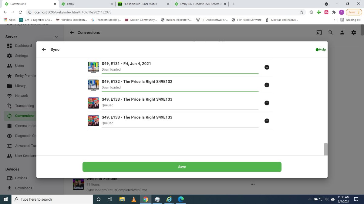

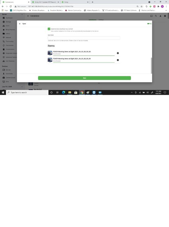

scott46953 31 Posted June 4, 2021 Author Posted June 4, 2021 ffmpeg-transcode-85145d47-5ffe-4889-a5a9-86d673fee348_1.zip I found the problem tonight by chance. the first fox news converted and everything went good, then the second one started ( that should not exist ) when the fox news 2 started if finished fast and over wrote my new converted fox news 1 But why is there 2 fox news on convert when I only have 1 file in my dvr folder???? and why is #2 fox news ghost erasing my recordings??

scott46953 31 Posted June 4, 2021 Author Posted June 4, 2021 (edited) Believe we have an error, if you look at photo below... The show is still recording and convert is busy doing other jobs, so will catch the original file and copy it to my google drive, I will also grab the log files for this file as well. Also in my google drive you will find wheel of fort dvr recording that error at end of convert, i see this error alot on random dvrs 5-10% of the time but i just delete and go on. https://drive.google.com/drive/folders/1X3EoyH2mMr9FpL31T2YIBWj8kW2BX9Iv?usp=sharing I copied the wheel ts original file and logs for it as well, but believe that is a differant issue and I always believed that it was a receiver blip error from interference in air waves while recording, since this is hd home run from antenna. Signal is good, but sometimes things happen. If you check it out and see something and its correctable, please let me know. However, if you want to look at that issue, your more then welcome. Maybe it can be fixed also. Just waiting on the price is.. to finish recording, then wait i have to wait for convert to hit the job. I will collect at much at I can on the way. Edited June 4, 2021 by scott46953
scott46953 31 Posted June 4, 2021 Author Posted June 4, 2021 (edited) Well, that was not expected.... it did not stop at 2-3 seconds this time, it did something different and the second price job errors instead of completes. When it does the 2-3 second thing the job #2 completes with ok. we will try again and keep eye for the next round, but the current files are uploading to goog D, it may take some time to upload, big files. logs and photos of screens shots are all together and named. But why does the error convert now says recording is 1h 16m?? but the finished file is only 420mb? It did delete the original and now my recording is the small bad file. I usually delete these videos when this happens, but i will keep it for a day just incase something is needed that i missed. Got 2 more shows coming with same issues(2jobs same name in convert), hopefully one will do the 2-3 seconds.. the 2 shows that finished both converted ok, then when it hit the job #2 in convert it just error and did not write over the 1st converted job. So everything came out ok on these. However, i believe if the Ghost job #2 never existed then the complete issue with convert should go away and since the 2-3 second isssue that started this off is also linked to the Ghost job #2 then I think that should resolve the complete issue in several ways. But for now, I turned off my direct delete by enabling my trash can for the dvr drive. So when emby deletes a recording and emby spits it out at 2-3 seconds, I can just go to the trash and recover the original file so you can see if it is missing frames or something. However, the 2-3 second thing did not exist until after the recent update 4.6.1 or the big update before that. Missing frames I can usually keep my original file and fast forward over the bad spot and continue playing the show when needed. After checking or playing, the show always got deleted so it can be recorded again if it comes on again. sorry if i repeat myself, i try not too. I'm taking a break from this for a few hours. I'll check back and see if I find any goodies in my trash... Edited June 4, 2021 by scott46953
