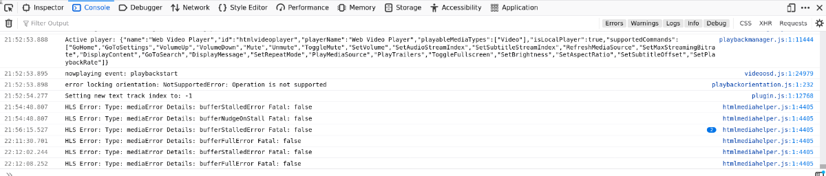

Misinthe 46 Posted June 9, 2021 Posted June 9, 2021 I've been getting this same problem since Saturday.
Misinthe 46 Posted June 10, 2021 Posted June 10, 2021 21 hours ago, Misinthe said: I've been getting this same problem since Saturday. I wanted to give an update, I replaced my old GPU (GT 710) for a "newer" Quadro K2000 for transcoding and ran DDU and downloaded the newest drivers from Nvidia and it seems to have fixed the issue, I'm not sure if it was the driver update or the hardware replacement.
svdasein 8 Posted June 14, 2021 Posted June 14, 2021 Ok - I had two more "sightings" of this today. So I guess "it's still there" but quite a bit less frequent.
Luke 42203 Posted June 16, 2021 Posted June 16, 2021 On 6/13/2021 at 11:14 PM, svdasein said: Ok - I had two more "sightings" of this today. So I guess "it's still there" but quite a bit less frequent. @svdasein can you try with our online web app and see how that compares? http://app.emby.media Thanks.
svdasein 8 Posted June 16, 2021 Posted June 16, 2021 @Luke I will spend some quality time w/ it & let you know. FYI - I was watching a movie last night and just got into freeze-up hell with it for some reason. I didn't see any issues at all on the backend vis a vis loads or anything - it just was going like 2 mins and freezing. I'll try it w/ the same media and see what happens.
svdasein 8 Posted June 18, 2021 Posted June 18, 2021 @Luke just a heads up - I was all set to get into the "quality time" with the online app, but found that for some reason it would not connect to my server on the workstation I planned to use for it. I did the manual connect thing and it came back with "cannot connect". I tried both dns and ip. Note that earlier that day it seemed I *was* able to get it to work - on a different workstation. Not sure what's up with that. I'll keep trying.
Solution Luke 42203 Posted June 18, 2021 Solution Posted June 18, 2021 Ok the 4.6.3 server release is also rolling out and includes a fix that may help with this. 1
p4nda 25 Posted June 18, 2021 Author Posted June 18, 2021 i can confirm that update to 4.6.3 fixed it for me thx 1
svdasein 8 Posted June 19, 2021 Posted June 19, 2021 Yep - I'm all good too. I was still having the problem, and it occurred to me that maybe it was just the damn browser, so I checked. Shame washed over me then I did this: Unpacking firefox (88.0+linuxmint1+sylvia) over (84.0.1+linuxmint1+sylvia) Problem solved. Sorry for the crazy mix of variables. But it's working like a clock now. I'll be doing some of this now
