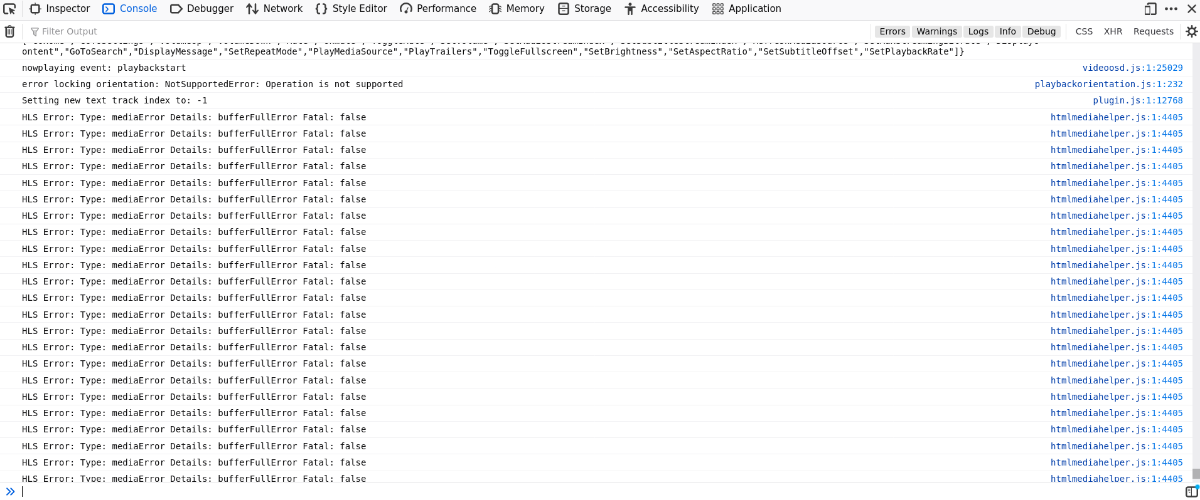

Carlo 4561 Posted May 28, 2021 Posted May 28, 2021 I'm seeing the problem in firefox and I get these errors Setting new text track index to: -1 plugin.js:1:12768 appRouter.sendRouteToViewManager - processing path: isBack: undefined router.js:1:7566 viewManager.onBeforeChange - processing path: isBack: undefined viewmanager.js:1:1694 HLS Error: Type: mediaError Details: bufferFullError Fatal: false htmlmediahelper.js:1:4405 HLS Error: Type: mediaError Details: bufferFullError Fatal: false htmlmediahelper.js:1:4405 HLS Error: Type: mediaError Details: bufferFullError Fatal: false htmlmediahelper.js:1:4405 HLS Error: Type: mediaError Details: bufferFullError Fatal: false htmlmediahelper.js:1:4405 HLS Error: Type: mediaError Details: bufferFullError Fatal: false htmlmediahelper.js:1:4405 HLS Error: Type: mediaError Details: bufferFullError Fatal: false htmlmediahelper.js:1:4405 HLS Error: Type: mediaError Details: bufferFullError Fatal: false htmlmediahelper.js:1:4405 HLS Error: Type: mediaError Details: bufferFullError Fatal: false htmlmediahelper.js:1:4405 HLS Error: Type: mediaError Details: bufferFullError Fatal: false htmlmediahelper.js:1:4405 HLS Error: Type: mediaError Details: bufferFullError Fatal: false htmlmediahelper.js:1:4405 HLS Error: Type: mediaError Details: bufferStalledError Fatal: false htmlmediahelper.js:1:4405 I also tried loading the web UI in firefox from app.emby.media and then manually logging in. Again I get: HLS Error: Type: mediaError Details: bufferFullError Fatal: false htmlmediahelper.js:1:4405 HLS Error: Type: mediaError Details: bufferFullError Fatal: false htmlmediahelper.js:1:4405 HLS Error: Type: mediaError Details: bufferFullError Fatal: false htmlmediahelper.js:1:4405 HLS Error: Type: mediaError Details: bufferStalledError Fatal: false htmlmediahelper.js:1:4405 Error opening web socket: Error: Cannot open web socket without access token. @Luke

svdasein 8 Posted May 30, 2021 Posted May 30, 2021 Just FYI - I'm seeing a similar thing on FF on Linux. FF version 84.0.1 (64-bit) Console at time of playback freeze attached
svdasein 8 Posted May 30, 2021 Posted May 30, 2021 The attached contains a screenshot of the event with timestamps, an ffmpeg log for the stream in question, and a listing of the transcode directory's contents. There was plenty of space free in it when this happened. Both client and server are running ntp. ffstall.zip
