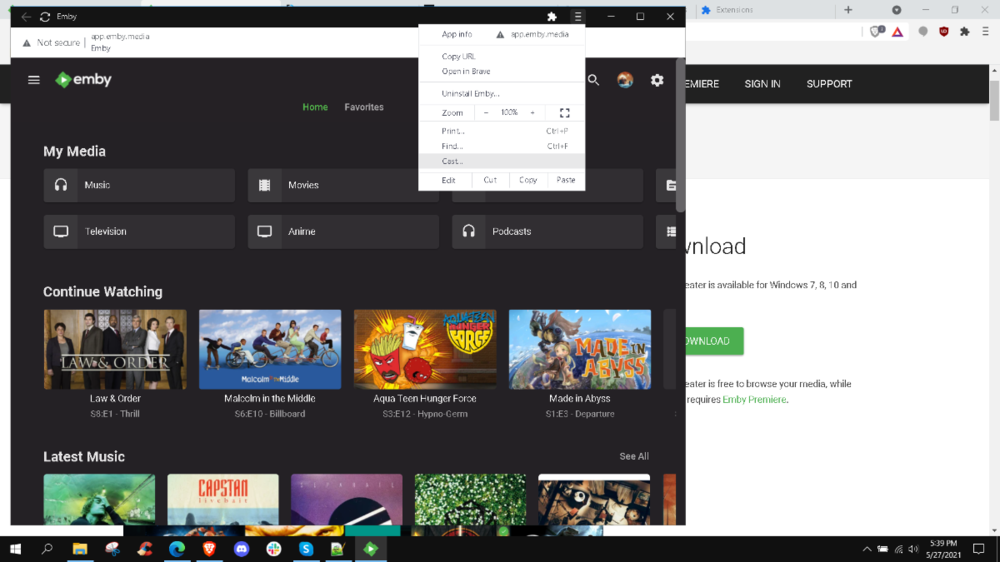

Dreakon13 143 Posted May 27, 2021 Posted May 27, 2021 (edited) This is kind of a weird question... but hoping someone might know what I'm talking about. Back before I reformatted my laptop, in my Brave browser I had the option from app.emby.media to "Open in App" like this... I'm not sure what I did to get that option, but it's not there with a clean laptop reformatting/new browser install. I tried installing Emby Theater from the Microsoft Store (long shot) and the Emby Chrome app/extension but neither produced the results I was getting before. The neat thing about the feature I was using, is that it opened it in a separate application window that was effectively a tab of the Chrome-based browser so I could both pin it to my taskbar AND cast to Google devices (like my Google Home speakers around the house) that the Emby apps themselves don't seem to pick up on. I'd think the Emby browser app would be right, but using it, I don't have the same browser-wide casting options like I did before. Any ideas what I'm missing? EDIT: Now that I look at it, this probably belongs in the Web App subforum. Sorry, please move if that's more appropriate. Edited May 27, 2021 by Dreakon13

Dreakon13 143 Posted May 27, 2021 Author Posted May 27, 2021 (edited) This is what it was!!! I followed your previous suggestion of creating a website shortcut, but chose to "open as window". Now I have this handy separate "application" window complete with my browsers casting abilities. Yay! That isn't how I did it before... but I'm glad to know the proper way now. 4 minutes ago, cayars said: Do me a favor and try to install this. https://emby.media/emby-theater.html This is our stand alone Theater desktop app which is superb and can direct play things your browser normally can't. This might have been what you were thinking about. Let us know. I would love to use the Emby Theater but I haven't been able to get it to pick up my Google Home devices to cast to. I use Emby on my desktop primarily for music. Edited May 27, 2021 by Dreakon13 1

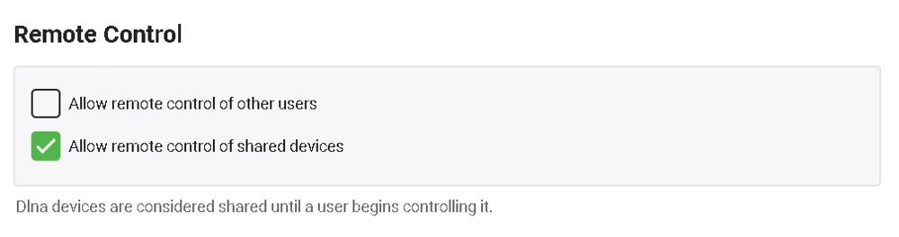

Carlo 4561 Posted May 27, 2021 Posted May 27, 2021 21 minutes ago, Dreakon13 said: I Haven't been able to get it to pick up my Google Home devices to cast to. I use Emby on my desktop primarily for music. Have you explored the Remote Control options of a user under profile?
Dreakon13 143 Posted May 27, 2021 Author Posted May 27, 2021 (edited) 12 minutes ago, cayars said: Have you explored the Remote Control options of a user under profile? I see the Remote Control options under my user... Is there something I should change? These are my options with Emby Theater: These are my options in the browser: Truthfully I've been meaning to start a thread if there's a way to get Emby Theater and the web app to pick up my Google Home devices like the browser casting can... but I always just figured it was probably more of a Google issue. Edited May 27, 2021 by Dreakon13

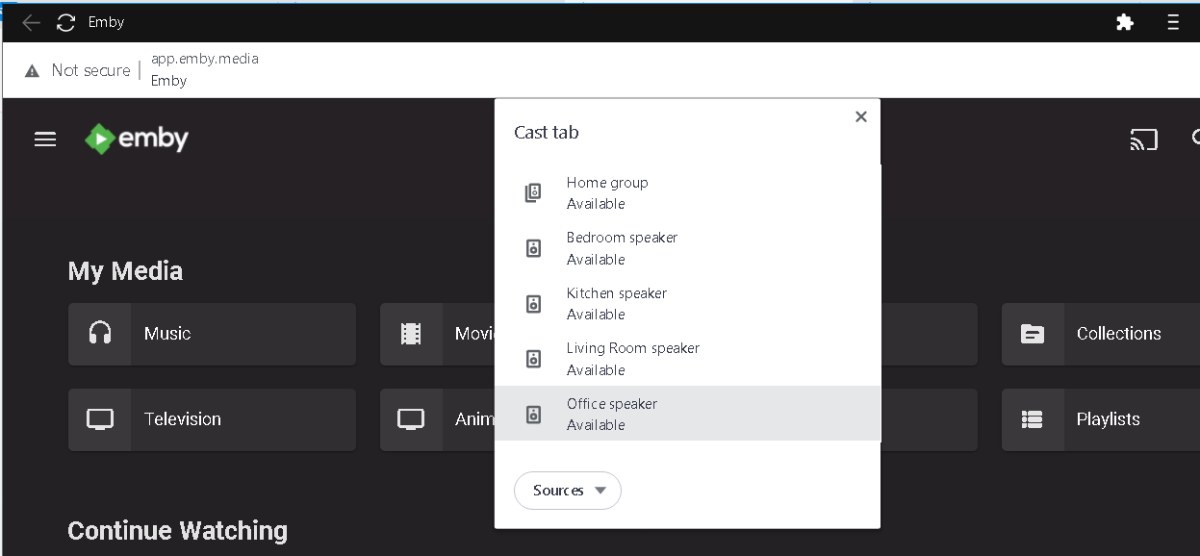

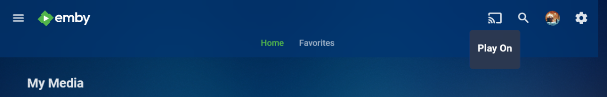

Dreakon13 143 Posted May 28, 2021 Author Posted May 28, 2021 (edited) 11 hours ago, cayars said: What is different between Emby and Google Chrome? Emby Theater doesn't list anything when I use the "Cast" button in the app itself. It just says "Play On" with nothing listed underneath it. The browser lists all of my Google Home devices. 10 hours ago, Happy2Play said: Not exactly sure how this works as in web client I do not see my Chromecast but in my IOS app I do. But the Chrome browser Cast to sees these cast to devices. But believe some of this is by design. Agree. It works on my Emby android app, but not in Emby Theater on my PC. I get around that by, as you said, using the Chrome browser casting, but that's why Emby Theater wasn't going to work out (since cayars asked me to try it before)... otherwise, it seems like a great desktop app. Seconding what Luke said, if I go onto the Web App through my secure reverse proxy, I see Chromecast as an option (though clicking it just seems to leverage the browsers casting abilities). Changing to the secure server host/URL didn't change Emby Theater though. I kind of assume this may be some restriction on Google's end versus anything you guys missed. Edited May 28, 2021 by Dreakon13
Luke 42203 Posted May 29, 2021 Posted May 29, 2021 Google only provides cast developer libraries for android apps, iOS app, and web apps. That's why you don't see Chromecast in the Play On menu of Emby Theater, although you will see other Emby apps in there. Quote though clicking it just seems to leverage the browsers casting abilities That's how Chromceast in web apps work. The dialog box you get to pick a Chromecast device is provided by the browser. 1
