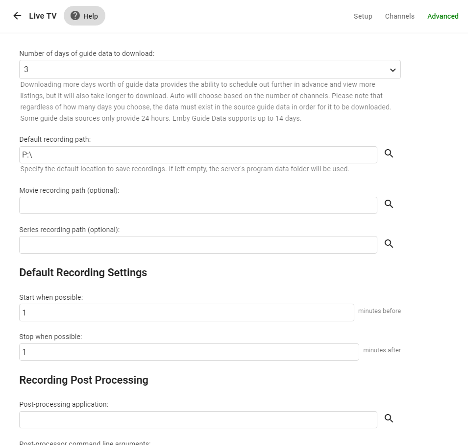

Happy2Play 9802 Posted May 30, 2021 Posted May 30, 2021 45 minutes ago, djpufcio said: I spoke too soon. After restarting emby back to the same issue. Missing the admin menu and emby crushing after couple of minutes. embyserver.txt 2.18 MB · 2 downloads can you please capture a screenshot of your live tv settings, along with your library setup and post them both here? thanks ! Possibly related to this previous topic. Corrupted Server Crashes Repeatedly - General/Windows - Emby Community 1
djpufcio 2 Posted May 31, 2021 Posted May 31, 2021 28 minutes ago, Happy2Play said: Logs like a rogue Recordings folder naming, pretty sure other topics on this issue exist. You were right. I deleted all of those "Recordings11111...." folders through windows explorer. There were around 300 of them. 60 of them wouldn't delete. Those folders were showing in the Library settings menu. I deleted them manually one by one. I can restart the emby server without any issues. Thank you all for your help. 1
Happy2Play 9802 Posted May 31, 2021 Posted May 31, 2021 1 minute ago, djpufcio said: You were right. I deleted all of those "Recordings11111...." folders through windows explorer. There were around 300 of them. 60 of them wouldn't delete. Those folders were showing in the Library settings menu. I deleted them manually one by one. I can restart the emby server without any issues. Thank you all for your help. Did you have the trailing slash on Live TV config page (default Recording path)?
djpufcio 2 Posted May 31, 2021 Posted May 31, 2021 10 hours ago, Happy2Play said: Did you have the trailing slash on Live TV config page (default Recording path)? No. Just a drive letter to a map network drive
Happy2Play 9802 Posted May 31, 2021 Posted May 31, 2021 1 minute ago, djpufcio said: No. Just a drive letter to a map network drive Are these rogue Recording numbered folders still being made?
djpufcio 2 Posted May 31, 2021 Posted May 31, 2021 1 minute ago, Happy2Play said: Are these rogue Recording numbered folders still being made? Since deleting them yesterday they stopped. Yesterday the power supply failed for the external hard drive that the PVR records to. So the drive wasn't reachable for a while. I'm wondering if this had something to do with it.
Happy2Play 9802 Posted May 31, 2021 Posted May 31, 2021 6 minutes ago, djpufcio said: Since deleting them yesterday they stopped. Yesterday the power supply failed for the external hard drive that the PVR records to. So the drive wasn't reachable for a while. I'm wondering if this had something to do with it. Possibly as the rogue folder is for the default location instead of your custom location.
