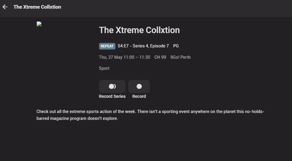

denz 501 Posted May 27, 2021 Posted May 27, 2021 After the .1 update there is no more thumbnails for any upcoming show once I get to work I will attach log

Luke 42203 Posted May 27, 2021 Posted May 27, 2021 I think this topic is really a question about your live tv guide provider, because look: 2021-05-27 08:55:13.801 Info HttpClient: GET http://images.icetv.com.au/placeholder/54319_poster.png Put that url in a browser and you'll be greeted with a 404 not found.
Luke 42203 Posted May 27, 2021 Posted May 27, 2021 Yup. Maybe the guide data changed since the last time your server refreshed, and when the guide data changes, they immediately expire the image urls. Just a guess.
