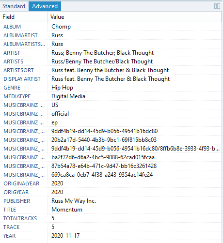

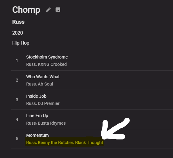

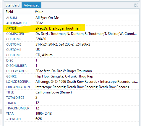

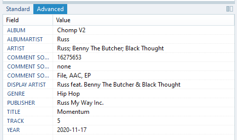

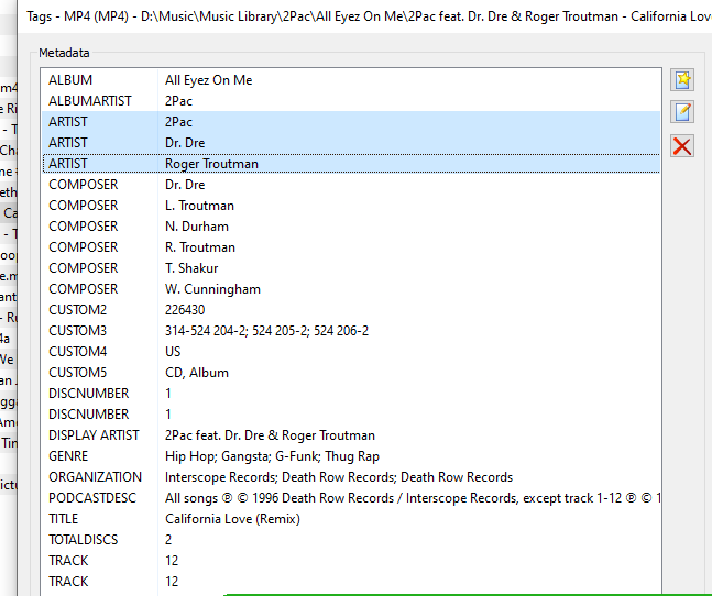

spon 26 Posted May 27, 2021 Posted May 27, 2021 Hi guys, I have had issues for a very long time figuring out how to get Emby to display artists featured on a song correctly. If I'm able to find the song/album on musicbrainz, the artists display correctly. If the song is tagged via other software, I can never get the artists to show correctly. I have one song, with 2 different screenshots of the metadata. There is no hidden metadata - this is everything. Can someone please tell me specifically which of the tags are being used to list the artist? Not the album artist, but the artist as showed in the screenshot. I thought I had read that it will pull from the Artist tag, but the Artist tag is identical in both scenarios. The only difference I can see is Artists, which is missing from the problem files. If Emby is using Artists it could be problematic b/c none of the mainstream tagging softwares seem to use Artists. Musicbee, Media Monkey, etc won't write to Artists tag, only Artist. Thanks!

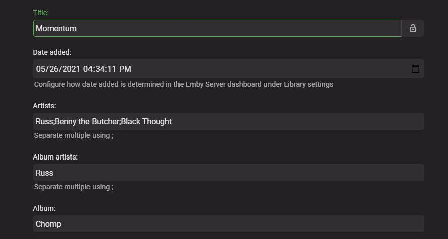

Luke 42287 Posted May 27, 2021 Posted May 27, 2021 HI, if you use the metadata editor, what does it list for an artist?

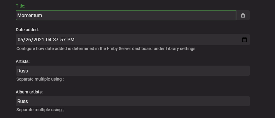

spon 26 Posted May 27, 2021 Author Posted May 27, 2021 3 minutes ago, Luke said: HI, if you use the metadata editor, what does it list for an artist? Hi Luke. The correct version shows all the artists, separated with semicolons, matching what it shows in the Artist tags. The incorrect version only shows one artist, which is the first artist listed in the Artists tag, as well as the Album artist. It's just weird because for both files the Artist tag is identical.
Luke 42287 Posted May 27, 2021 Posted May 27, 2021 Right so because the Artist is the same as the album artist, that's why you're not seeing it. It could be that ffprobe did not pick up any artist tag, and so the server took the value from album artist and applied it to artist. it could also be that its' just tagged with Russ. Try refreshing the metadata on the track. Then the server log will have the ffprobe command line. You could run that from a command prompt to see what ffprobe picks up. Bottom line, it's not tagged how you think it is. You'll want to use tag writing software that writes to all versions of id3 tags.

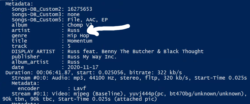

spon 26 Posted May 27, 2021 Author Posted May 27, 2021 (edited) 1 hour ago, Luke said: That should be fine. You can try refreshing the metadata on the track, then the server log will show the ffprobe command line that was used to probe it for media info. Then if you take that and run it from a command prompt, you can see what ffprobe got from the track. The plot thickens. The results from ffprobe seem to support that something is off with the tags themselves or at least with how ffprobe is reading the tags. You can see that both the correct and incorrect tracks show only "Russ" as the Artist. The main difference between the two tracks tags, as far as I can tell, is that correctly displayed track has all three performers in Artists tag. A non-Emby question that I now have is why ffprobe is only showing a single value in the Artist tag despite every mp3 tagging software that I've tried (Mp3tag, MusicBee, TagScanner, MediaMonkey) all showing multiple Artists in that tag. For this test I create the mp3s myself so that I could have control over exactly which tags were being added so I don't understand why Artist is showing a single value. Correctly displayed track Incorrectly displayed track Edited May 27, 2021 by spon
Luke 42287 Posted May 27, 2021 Posted May 27, 2021 We'd have to look through the ffprobe source code to answer that, which we can if necessary, but when there are mulitple I would suggest using the plural Artists tag. That doesn't actually answer the question so I realize that is more of a workaround. I can think of two things: Your file is embedded with multiple versions of id3 tags, and the one ffprobe is reading is not the one your tagging software is writing. That's why I suggested using Picard and enabling the option to write to all versions (which i think is on by default). Or, perhaps ffprobe is artificially discarding entries after the first one because it thinks the artist tag should only have one value. I'm just throwing that out there but i think it's unlikely because we would have seen that before.
spon 26 Posted May 27, 2021 Author Posted May 27, 2021 (edited) Thanks Luke. Good news - I figured out the issue. It looks like Emby/ffprobe requires that the tags be written in Unicode. There is a setting in one of the apps I've been trying (TagScanner) that reads "Always save ID3V2 tags in Unicode". What I did was load up any problem file into TagScanner and then simply hit save. I can then see that the tag version changes from ID3v2.3 to ID3v2.3@utf16. Then I refreshed metadata in Emby and all the artists are shown. I checked ffprobe too and it also shows the semi colon separated artist list. So, I'm glad we figured it out. I suspect some of the other threads I've seen with similar issues can be explained in the same way. As always, thanks for your help. I'm always impressed by your willingness to help out. Edited May 27, 2021 by spon 1

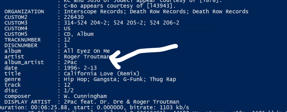

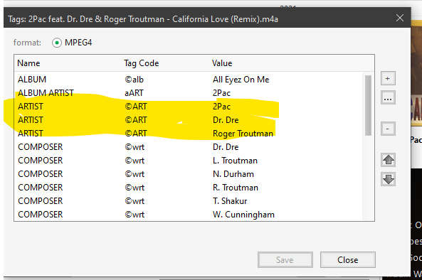

spon 26 Posted May 28, 2021 Author Posted May 28, 2021 (edited) sorry going to bump this for one last question? Does anyone know of an app that will completely remove all tags from music files? I've spent about 2 hours now trying to get one song to be imported to Emby correctly and it's just not working. So far I've tried the usual suspects: Picard, Mp3tag, Tag Scanner, Musicbee & Media Monkey. I remove all tags (via both Picard and Tag Scanner) so the file is completely clean. Re-add tags via Picard, MusicBee or Media Monkey, re-add to Emby but the results never show all the artists. I'm assuming there is some sort of stuck tag that the 5 apps I've tried are not cleaning. Screenshots of the current file showing each app (including ffprobe) read the tags. Notice how ffprobe doesn't even list 2Pac as the artist at all and is also missing Dr. Dre. It's as if it's only catching the last Artist listed or something. TagScanner Mp3tag MusicBee Picard ffprobe Edited May 28, 2021 by spon
PenkethBoy 2068 Posted May 29, 2021 Posted May 29, 2021 mp3tag - select the tags and hit the X on the right in the extended tag dialog

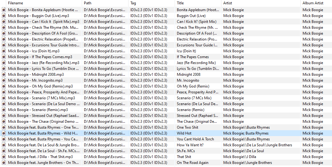

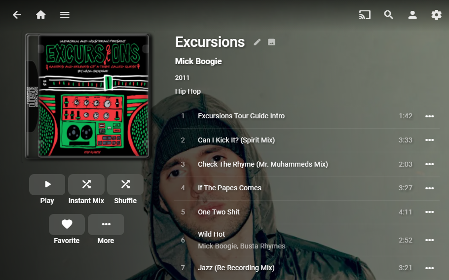

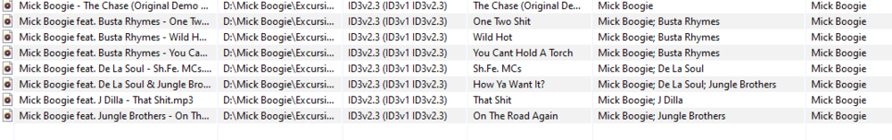

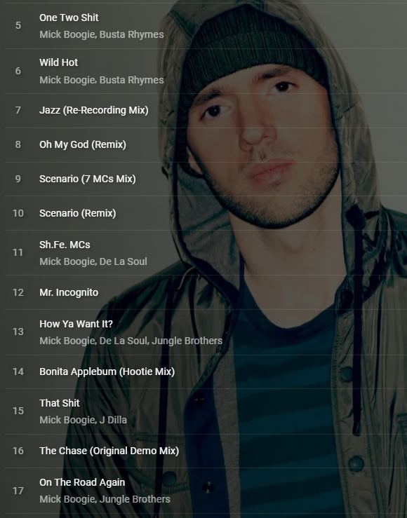

spon 26 Posted June 2, 2021 Author Posted June 2, 2021 9 hours ago, cayars said: You can use any upload server on the net. Just post the link. Here is an example album for troubleshooting. https://wetransfer.com/downloads/e96d37d29d7c18e60f0b5c751585922920210602145019/9105cffd450f12eb5ff1f5424a7ad1ef20210602145135/5986bc Album details can be found here: https://www.discogs.com/Mick-Boogie-Excursions/release/9786308 Thanks again!!
Carlo 4561 Posted June 4, 2021 Posted June 4, 2021 If I load the album as is I only get 1 track with multiple artist listed "Wild Hot". If I fix the tags I then get this
