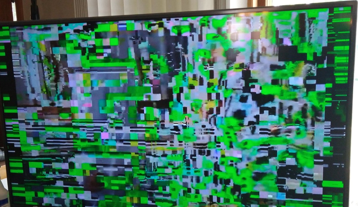

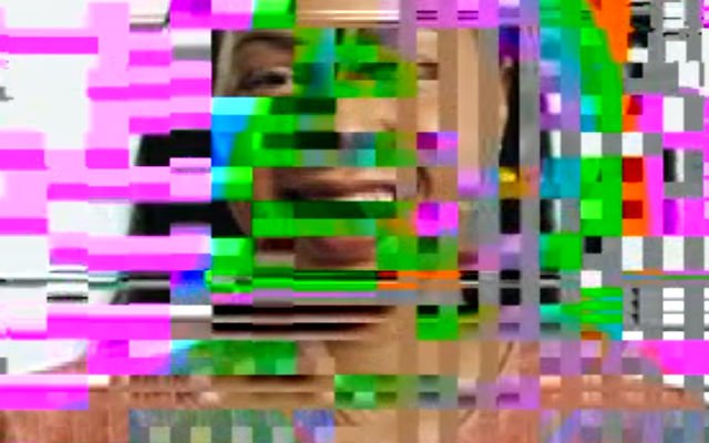

drorem99 0 Posted May 26, 2021 Posted May 26, 2021 26-may Hi, I recently started seeing video artifacts when using the Roku app and watching liveTV (see attached photo of TV). I sent a debug log this morning (26-may 10:43AM EDT) which was generated while watching ch 2.2 (WBBM Chicago). I'm using an HDHomerun connect (2 tuner model) as the liveTV source and have Emby running on a linux server w/ Ubuntu 20.04.1 LTS w/ emby version 4.6.1.0. I also see the artifacts while using a web browser to port 8096 on the server (see attached screenshot). Curiously, I do *not* see the artifacts when using an Amazon Fire device with the Emby fire app. I'm unsure when exactly the problem started - I did upgrade to emby v 4.6 recently - I've verified that the Roku Emby app is up to date. I also don't see artifacts when looking at the channels via the HDhomerun windows app. Does anyone have any ideas as to what might be wrong? thanks.

drorem99 0 Posted May 27, 2021 Author Posted May 27, 2021 Carlo, I did find HW transcoding was enabled on the server - I turned it off and I'm not seeing the artifacts. I don't recall turning it on explicitly and (as I mentioned) I didn't see this behavior in the past with the Roku app. Did the HW transcoding flag get enabled by default with the recent 4.6 server upgrade? Also - I'm curious why I don't see the artifacts when using the Amazon Fire device and associated app? (wouldn't it have seen the same transcoded video from the server?) Luke - I'm unsure what you want re: an example? I can certainly turn on HW transcoding again and send whatever would be helpful to diagnose the problem. FYI.. I did turn on debugging on the Roku app and sent a debug log (yesterday 26-may at 10:43AM EDT). regards, Doug
