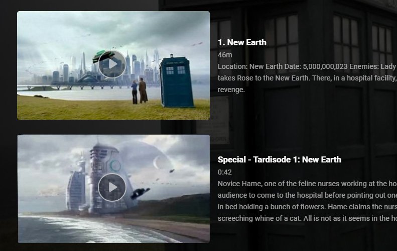

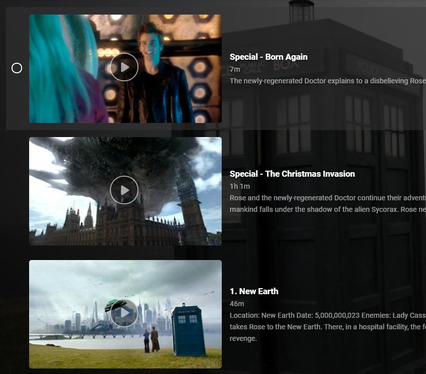

rexerm 36 Posted May 26, 2021 Posted May 26, 2021 (edited) After upgrading to 4.6.0, I went through all of my episodes and verified they were placed in the correct spots in seasons. I just noticed -- having upgraded to 4.6.1 a few days ago -- that things are now mixed up a bit. Specials are still in the correct seasons, but they do not seem to be obeying the "Airs before episode" setting. An example from Doctor Who. The Special "Tardisode 1" should appear before episode 1 "New Earth." It used to, but now is listed after. Strangely, some things do appear in the correct spot, anyway, like the first two specials preceding episode 1. It seems to be very random. EDIT: just to verify, I restored an image with 4.6.0 on it and the order was fine. Definitely a 4.6.1 bug. Edited May 26, 2021 by rexerm 1

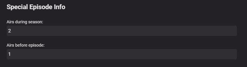

rexerm 36 Posted May 26, 2021 Author Posted May 26, 2021 No, this is nothing to do with the changes between 4.5.4 and 4.6.0. As you can see from 3rd screenshot above, the "Tardisode" special's metadata for placement in the season is filled out how I want, but sorts incorrectly in the 1st screenshot (after episode 1 instead of before). Seems to be an 4.6.1 issue (not sure on the 4.6.0.52 beta, as I did not test that).
