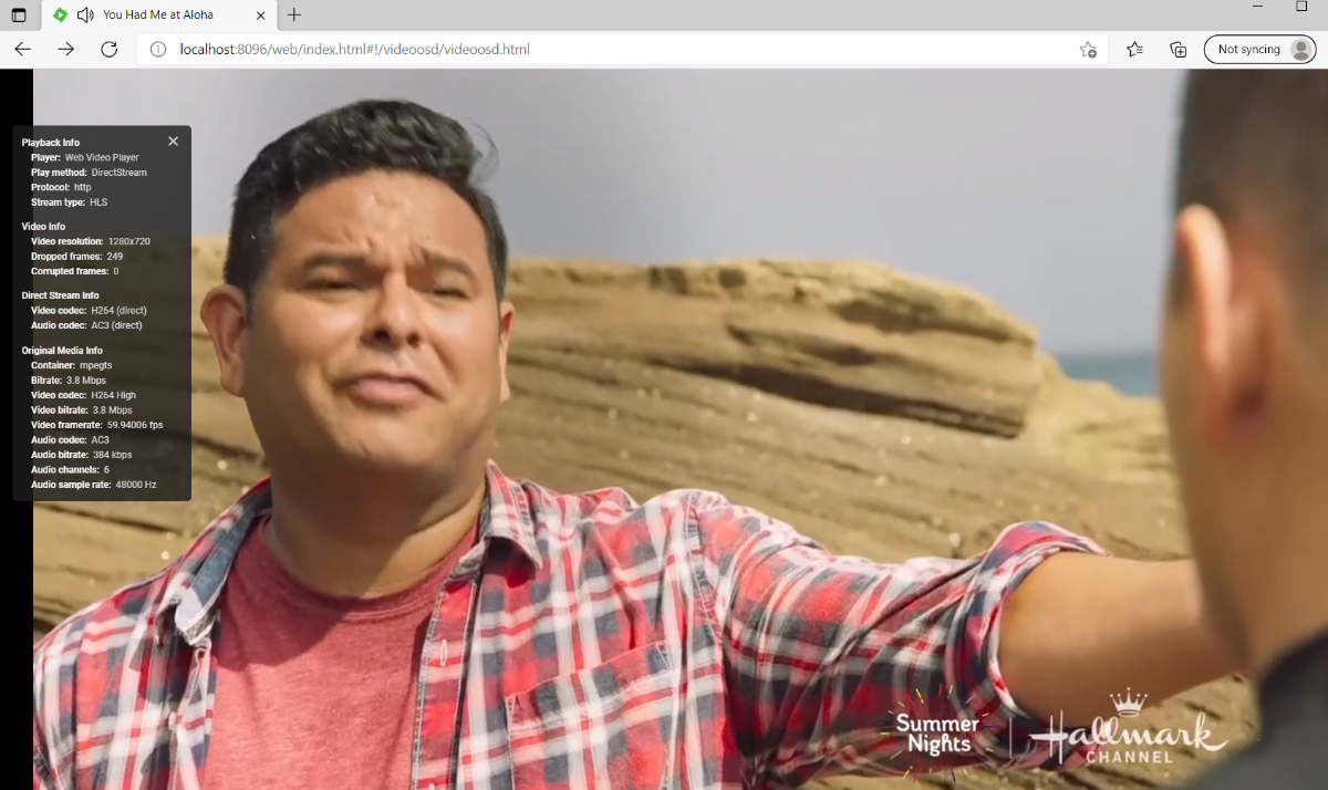

Carlo 4561 Posted June 6, 2021 Posted June 6, 2021 Chrome, Edge, Firefox would all be browser clients or what we typically call Web Clients vs Android TV, Roku, Theater, etc. So that answers that question. A few screen shots wouldn't hurt. If you could click on the cog icon during playback if available and click on stats for nerds option (if possible).

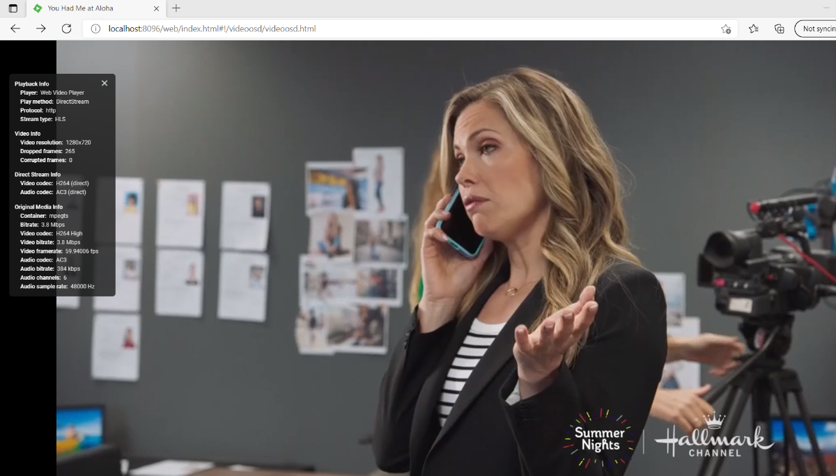

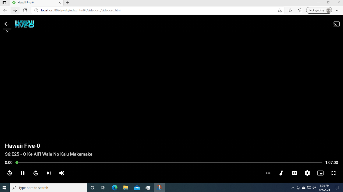

paulduffy 2 Posted June 7, 2021 Author Posted June 7, 2021 Hi Here are some screen shots: Fail Screenshot title - is the title screen for one of the recordings that will not play. In this screen, I click on "Play" and get Fail Screenshot playing - shows what I get when the video recording will not play Fail Screenshot stats_for_nerds - is what shows up on this screen when I click on the gear wheel and select stats for nerds.... Playing Screenshot stats_for_nerds - I was able to play a different recording. When this recording was playing, I selected stats for nerds and get this screen. Frozen Screenshot - after a few minutes, the playback froze and I got this screen. I click on the "advance 10 seconds" button and then the playback resumes. This happened several times during the playback of this movie. I hope this helps explain what I am seeing and what is happening...... Thanks. Paul

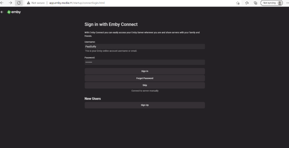

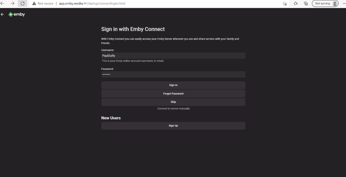

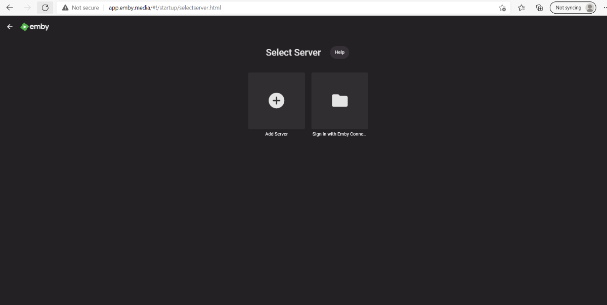

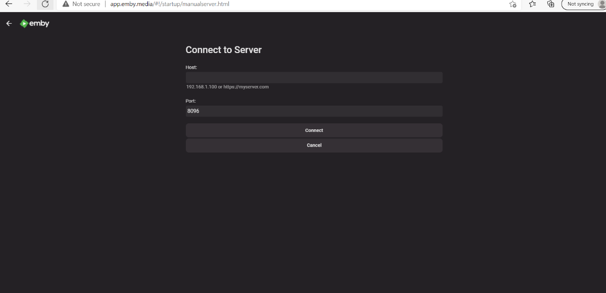

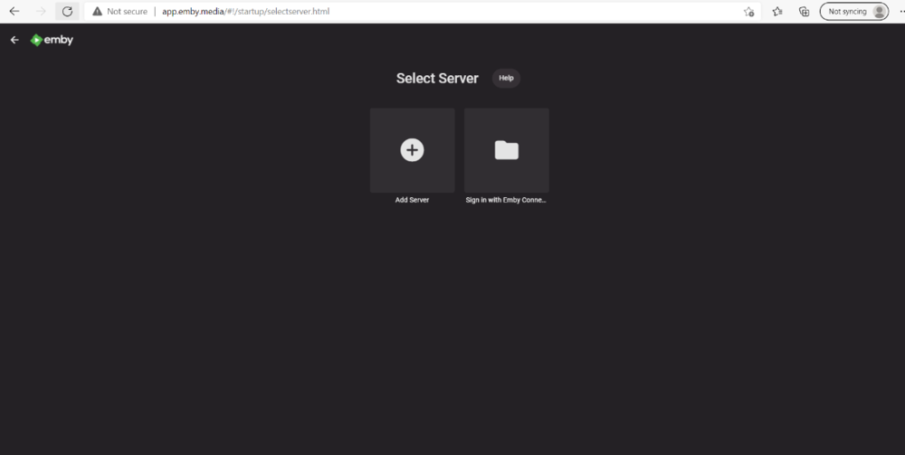

Luke 42203 Posted June 10, 2021 Posted June 10, 2021 Would you mind trying with our online web app and see how that compares? http://app.emby.media Thanks.
paulduffy 2 Posted June 10, 2021 Author Posted June 10, 2021 Hi I clicked on the link and get: Emby Connect seems to be a capability to connect to my server from other locations....something I am not really trying to do. I try to sign in and then get this screen: do you want me to "Add Server"? If I click on this option, I get: and I am not sure what to do......
