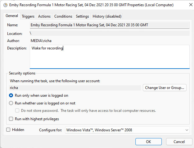

rbjtech 5335 Posted November 24, 2021 Posted November 24, 2021 (edited) In the Windows scheduler - you should see the recordings listed as 'Emby Recording X' - is it worth posting screen shots from those tabs to see if there is anything obviously wrong ? My machine never sleeps, so I don't have this issue - but I was looking into what it actually does using the schedule.... a) - My 'General' section is set to only Run when a user is logged in - I presume when your machine 'wakes' it is still logged in ? Try setting to use a service account instead ? b) - My 'Actions' section is an interesting one - It works but it looks very odd - program is embyserver.exe - that's fine - but arguments are - "C:\Emby-Server\system\EmbyServer.dll C:\Emby-Server\system\EmbyServer.dll C:\Emby-Server\system\EmbyServer.dll C:\Emby-Server\system\EmbyServer.dll C:\Emby-Server\system\EmbyServer.dll C:\Emby-Server\system\EmbyServer.dll C:\Emby-Server\system\EmbyServer.dll C:\Emby-Server\system\EmbyServer.dll -noautorunwebapp" is that correct ? Why all the same arguments ? c) My 'Conditions' are - Power, all 3 ticked d) My 'Settings' - Run task as soon as possible after a schedule is missed (should be yes?), retry should probably be yes as well ? Maybe worth having a play to modify this yourself, and if it solves the issue - then emby may need to change some of it's wake settings .. Edited November 24, 2021 by rbjtech
Noel-M 11 Posted November 24, 2021 Author Posted November 24, 2021 There is no problem with the machine waking. Attached is a report from System Power State. Emby always logs something after the wake 2021-11-24 11:50:10.718 Debug NetworkManager: Detected local ip addresses: 192.168.0.5, 127.0.0.1, fe80::3d74:d41:c15f:3386%14, ::1 .. but does not acknowledge the PowerModeChanged event immediately. Ofter it handles the event after the program that was to be recorded has finished. My user is always logged in. That's not my preference, but Emby generates the scheduled task with the "Run when user logged in" checked. This prevents me from waking Emby as a system service.

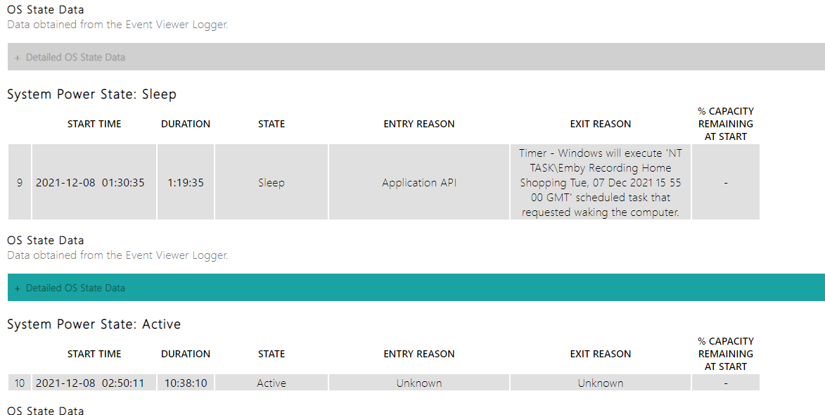

Noel-M 11 Posted December 8, 2021 Author Posted December 8, 2021 Debug enabled. The machine goes to sleep at 01:30 am. I have scheduled a recording of "Home Shopping" at 03:00 am on 8th dec. My log file rotates at 0:00 - so I have included the log file for 7th as well. I haven't seen this behaviour before. In the log file from the 7th I see the recording scheduled. 2021-12-07 23:58:18.680 Info LiveTV: Creating recording timer for a2cbf4f0b70e4730bf311291b582a902, Home Shopping. Timer will fire in 176.68865920666667 minutes The system power report shows the machine sleeping and waking (and the reason for waking) The logfile from the 8th has no mention of 'Home Shopping'. The program was not recorded. embyserver-63774518400.txt embyserver.txt
Luke 42197 Posted December 8, 2021 Posted December 8, 2021 OK I see a workaround. As you can see, we're getting notified of the Resume event much later than expected, and this is the reason for the problem. But when the system actually wakes, there are also network change events firing, so we can also listen to those. Thanks.
