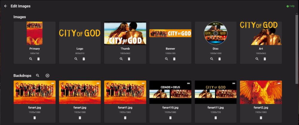

BuddahKat 17 Posted May 25, 2021 Author Posted May 25, 2021 Sure, here's a zipped movie folder to test. I just added this to my Emby server, screen shot attached of the resulting 'Edit Images' screen. You can see that it has TWO 'fanart.jpg' files listed, however there's only ONE in the movie folder that was added. Hope this helps! test_folder.zip
Happy2Play 9814 Posted May 25, 2021 Posted May 25, 2021 I see this issue on existing item but not new items. as mentioned in other topic. I only see this with fanart naming and do not see this with backdrop naming.
Luke 42301 Posted May 25, 2021 Posted May 25, 2021 I can reproduce with his test zip right on import, so that's good. Should be enough to resolve. 1

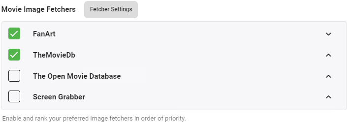

Luke 42301 Posted April 19, 2022 Posted April 19, 2022 If you enable multiple image sources then duplicate backdrops are going to be inevitable, so keep that in mind.
Happy2Play 9814 Posted April 20, 2022 Posted April 20, 2022 1 hour ago, Luke said: If you enable multiple image sources then duplicate backdrops are going to be inevitable, so keep that in mind. True but will not end up with Backdrop and Fanart named images. But that movie does have more than one backdrop on each provider. But a wild guess would be another program is providing one "Backdrop" and Emby is set to 2 backdrops and getting the same backdrop from same provider and saving as FanArt. So both programs pull same backdrop from same provider.
Luke 42301 Posted April 20, 2022 Posted April 20, 2022 That could be, yes. The method to avoid duplicates is very primitive, by comparing byte sizes. If you have more than one provider enabled and/or other software downloading backdrops in addition to emby, the chances of duplicates will be much higher.

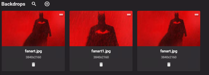

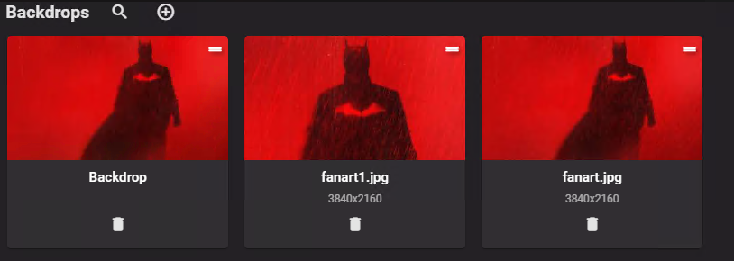

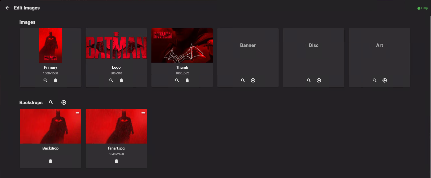

Nashemon 3 Posted April 20, 2022 Posted April 20, 2022 (edited) Thank you both for your responses. Taking them into consideration, I've been testing things out, trying to give ample time between tests to confirm Emby doesn't automatically manage the extra backdrop image in an unexpected way. I'm mostly confident that the following is accurate. I'm putting the observations in spoilers, in case it's pertinent. Spoiler 21 hours ago, Happy2Play said: Technically a different issue. But first question would be how would I recreate this as Emby no longer creates Backdrop.jpg images it only creates fanart/fanartx.jpg's. You're right. No file named Backdrop.jpg is created. It seems Emby just calls it "Backdrop" initially, but after a short while if "Save artwork into media folders" is checked, it renames the "Backdrop" one to fanart.jpg. If save artwork is not checked, it remains named Backdrop and has an identical fanart.jpg. There are three scenarios I've found. 1. While Emby still shows the two duplicate images as Backdrop and fanart.jpg, deleting Backdrop removes it from Emby and fanart.jpg remains in both Emby and the movie's folder. 2. While Emby still shows the two duplicate images as Backdrop and fanart.jpg, deleting "fanart.jpg" deletes it from the movie's folder, but leaves "Backdrop" in Emby. No idea where it stores this Backdrop image. If I search for missing metadata, it adds a fanart.jpg to Emby. 3. If I wait for Emby to rename Backdrop so that there are two fanart.jpg (as above), deleting either one of them deletes the fanart.jpg file from the movie's folder. After a minute the other "duplicate" one will disappear from the Emby screen leaving me with no backdrops. 18 hours ago, Happy2Play said: True but will not end up with Backdrop and Fanart named images. But that movie does have more than one backdrop on each provider. But a wild guess would be another program is providing one "Backdrop" and Emby is set to 2 backdrops and getting the same backdrop from same provider and saving as FanArt. So both programs pull same backdrop from same provider. This has always been set to 1. If I change it to 2, it does this: Then after some time Emby renames Backdrop to fanart.jpg (again, only if "Save artwork into media folders" is checked). 20 hours ago, Luke said: If you enable multiple image sources then duplicate backdrops are going to be inevitable, so keep that in mind. Ok, let's look at that. As a preface, I have no other programs or scrappers managing anything for Emby, to the best of my knowledge. To replicate the issue I created Z:\Test\The Batman (2022)\"The Batman (2022).mp4". I created a new Movie library, and selected the test folder. Default settings except for: Minimum automatic collection size: 4 Metadata savers: Nfo checked Movie Image Fetchers: TheMovieDb and FanArt checked, in that order (uncheck Screen Grabber) Save artwork into media folders: Checked Done Scan files in the new test folder. Emby finds the movie, fetches a poster, a backdrop, a duplicate backdrop named fanart.jpg, a logo, and a thumb. Then I did some testing. Each test I started with the same properly named folder with only the properly named video file in it as before. All settings are the same as above except for the Movie Image Fetchers used. Test 1: Movie Image Fetchers: TheMovieDb only Scanned files. Emby finds the movie, fetches a poster, and a single backdrop named fanart.jpg. No logo or thumb. Not ideal, but ok since no duplicate backdrop. Test 2: Movie Image Fetchers: FanArt only This time Emby finds the movie, a poster, a different backdrop named fanart.jpg, a logo, and a thumb. This seems like it would be the solution, but going to miss a lot of options for posters if I leave it like this, as I usually prefer the posters from TheMovieDb. Test 3: Movie Image Fetchers: FanArt and TheMovieDb, in that order. This time Emby finds the movie, a poster from FanArt, a backdrop from FanArt, a logo, and a thumb. No duplicate backdrop, and I still have all the options from TheMovieDb if I want. So in conclusion, I can recreate this issue 100% of the time by having both TheMovieDb and FanArt fetchers selected, in that order. Which is the default. If I simply move FanArt above TheMovieDb, the issue does not occur. Seems to be an issue with TheMovieDb fetcher, in combination with the FanArt fetcher. Maybe it's just me, though. Can anyone else replicate this? Edited April 20, 2022 by Nashemon
Happy2Play 9814 Posted April 20, 2022 Posted April 20, 2022 7 minutes ago, Nashemon said: Test 1: Movie Image Fetchers: TheMovieDb only Scanned files. Emby finds the movie, fetches a poster, and a single backdrop named fanart.jpg. No logo or thumb. Not ideal, but ok since no duplicate backdrop. LOGO and THUMB currently only come FanArt.tv as they were the only providers. But will changed slightly in 4.7. But with what you have provided I cannot reproduce in 4.6 or 4.7 so far. But this looks like a database issue as it is not possible to have 2 images named "Fanart".
Nashemon 3 Posted April 20, 2022 Posted April 20, 2022 3 minutes ago, Happy2Play said: LOGO and THUMB currently only come FanArt.tv as they were the only providers. But will changed slightly in 4.7. But with what you have provided I cannot reproduce in 4.6 or 4.7 so far. But this looks like a database issue as it is not possible to have 2 images named "Fanart". It takes some time for the second one to show up sometimes. My testing involved waiting and scanning/refreshing/restarting multiple times. I can force it to show a Backdrop and duplicate fanart.jpg by doing Refresh Metadata selecting "Search for missing metadata" and without replacing existing images.
Happy2Play 9814 Posted April 20, 2022 Posted April 20, 2022 2 minutes ago, Nashemon said: It takes some time for the second one to show up sometimes. My testing involved waiting and scanning/refreshing/restarting multiple times. I can force it to show a Backdrop and duplicate fanart.jpg by doing Refresh Metadata selecting "Search for missing metadata" and without replacing existing images. Do you save image with media? But I have tested with and not with media and don't get duplicate with any scanning or refreshing, but is on a NEW portable test install.
