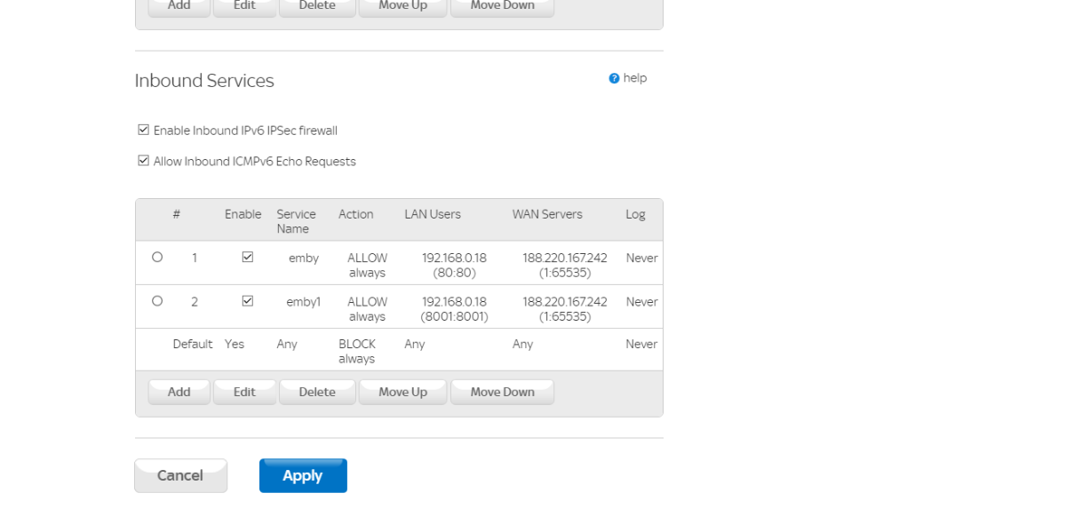

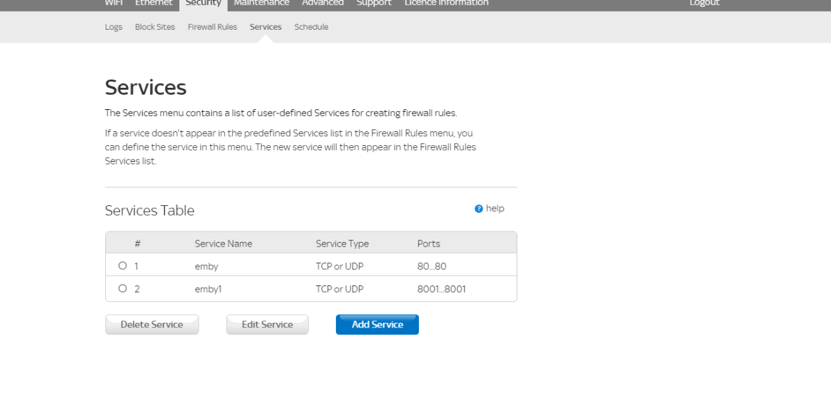

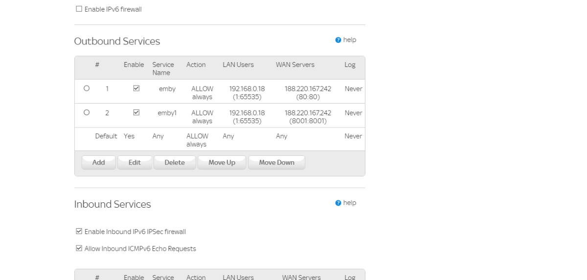

That looks good. Was this done on your Emby Server?
Please take a pic and post of how your port forwarding is set in your router.
Shamuslcfcmiayoung
i went on the command on windows and typed tracert 8.8.8.8
i hope these are correct haha
 985620427_OperaSnapshot_2021-05-24_210232_192_168.0.1.thumb.png.2ff4cfc47c5f7b49ab0a4e925bc9bc97.png1105222786_OperaSnapshot_2021-05-24_210347_192_168.0.1.thumb.png.b27fd318fd99428722d895bb3099fa4e.png1604995840_OperaSnapshot_2021-05-24_210305_192_168.0.1.thumb.png.f4a4e26ef053b97777830579617c6c4e.png
Carlo
You don't have proper ports forwarded for Emby.
Per our documentation you need for forward port 8096.
