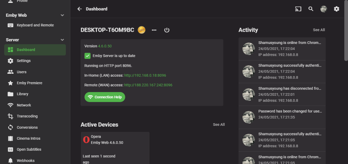

Shamuslcfcmiayoung 2 Posted May 24, 2021 Author Posted May 24, 2021 (edited) im very struggling as the remote access ip address is not recongising and it was working yesterday and I cant seem to figure out why pleas somebody help i am pulling my hair out haha as you can see in the picture plus on firestick when i put the ip address in it keeps saying error no server? Edited May 24, 2021 by Shamuslcfcmiayoung added new photo
