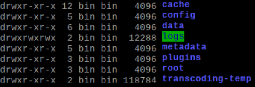

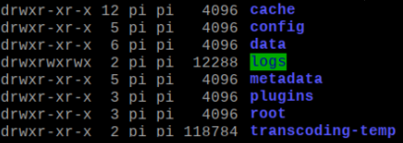

gokuz 13 Posted May 24, 2021 Posted May 24, 2021 @Luke Another issue that I might spring it on you, your docker are changing "emby/config" chwon to BIN. "emby/config" is setup as 1000:1000 (User). Whenever I use your docker, it changes to BIN user every single time. Maybe its intended? idk.
gokuz 13 Posted May 24, 2021 Author Posted May 24, 2021 1 minute ago, Luke said: @gokuz Cool, its no big deal actually since it still works. Just that my docker compose file = 1000:1000 (user) emby/config folder = user (ls -l to check) After running your beta, emby/config (ls -l) changes to (BIN) user.
gokuz 13 Posted May 25, 2021 Author Posted May 25, 2021 Before After running docker-compose, Docker compose env,

alucryd 318 Posted May 25, 2021 Posted May 25, 2021 @gokuz Where are you running the ls command? On the host machine or in the docker container? The container has no idea what your host users are, 1000:1000 inside the container is probably just bin:bin, so there's nothing to worry about. I can check later what 1000:1000 is here if needed.
gokuz 13 Posted May 25, 2021 Author Posted May 25, 2021 31 minutes ago, alucryd said: @gokuz Where are you running the ls command? On the host machine or in the docker container? The container has no idea what your host users are, 1000:1000 inside the container is probably just bin:bin, so there's nothing to worry about. I can check later what 1000:1000 is here if needed. On the host machine. Yea it still works but I noticed this anomaly when i switched to/from linuxserver's emby docker. Their docker didn't change user so I found it weird yours does.
Solution alucryd 318 Posted May 25, 2021 Solution Posted May 25, 2021 We chown to allow people to quickly switch the user they want it running as and make sure the config is writable. In any case, I just realized what's going on. You're using PUID and PGID variables, when we want UID and GID, please refer to our documentation: https://hub.docker.com/r/emby/embyserver 1
gokuz 13 Posted May 25, 2021 Author Posted May 25, 2021 19 minutes ago, alucryd said: We chown to allow people to quickly switch the user they want it running as and make sure the config is writable. In any case, I just realized what's going on. You're using PUID and PGID variables, when we want UID and GID, please refer to our documentation: https://hub.docker.com/r/emby/embyserver TIL, uid is different than puid. But I do not have UID setup. Guess its a fluke lol. Thanks, solved.
alucryd 318 Posted May 25, 2021 Posted May 25, 2021 If you don't specify it, it defaults to 2:2, I thought this was daemon:daemon almost everywhere, but I guess it's bin:bin on your distro (on mine bin:bin is 1:1). 1
