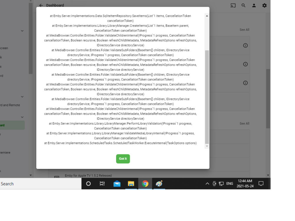

SMTV91 16 Posted May 24, 2021 Posted May 24, 2021 Hi everyone, I recently had issues with scheduled tasks failing so I followed the instructions from another emby forum post which said the answer was to rebuild the db. So I renamed the original library file and set about rescanning media files. Since then the scan which had been running for about 4-5hrs froze at 86.6% for about 2 hrs and then stopped and gave a failed error message. I then tried scanning each media folder manually but kept getting scan failed error messages. Only about 1/3 of my library files are present. I attached my latest logs and screen shot the scanned media file alert from the dashboard. I'm at a loss for what to do... embyserver.txt
Solution Luke 43429 Posted May 24, 2021 Solution Posted May 24, 2021 HI, please take a look at this and let us know if this helps you resolve it: https://support.emby.media/support/solutions/articles/44002210894-corrupt-database Thanks.
SMTV91 16 Posted May 24, 2021 Author Posted May 24, 2021 Thanks for the reply Luke. I've started following the guide and am in the process of rescanning again after once again deleting the library.db file. I wasn't able to do the step in the guide to delete the library.db-shm & library.db-wal files as they would disappear when I shut down the server and weren't able to be deleted when the server was up as they were in use by the server. Right now the scan is at 95.5% so if that doesn't work I'll move on to the database integrity steps.
SMTV91 16 Posted May 24, 2021 Author Posted May 24, 2021 Looks like deleting the db file and rescanning until I get a successful media scan did the trick Luke. Thanks again. I'll save this guide for next time
