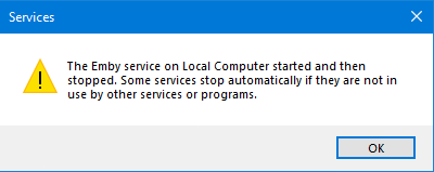

DerrickM 23 Posted May 24, 2021 Posted May 24, 2021 Apologies if this is redundant, I didn't find anything while searching, Emby server seemed to be working 24 hours ago after updating. Today i cannot get the service to start. Im pretty sure I havent changed anything. When I open services and click start on my Emby service I get a message that says Any help is appreciated. embyserver-63757394782.txt

DerrickM 23 Posted May 24, 2021 Author Posted May 24, 2021 I did follow that exact guide when I redid it today, It was working perfectly for probably 2 years.
Luke 42203 Posted May 24, 2021 Posted May 24, 2021 Something is denying the server access to the port that it needs: 2021-05-23 19:26:22.348 Error Main: Error in appHost.Init *** Error Report *** Version: 4.6.0.50 Command line: C:\Users\Derrick\AppData\Roaming\Emby-Server\system\EmbyServer.dll -service Operating system: Microsoft Windows 10.0.19042 Framework: .NET Core 3.1.13 OS/Process: x64/x64 Runtime: C:/Users/Derrick/AppData/Roaming/Emby-Server/system/System.Private.CoreLib.dll Processor count: 16 Data path: C:\Users\Derrick\AppData\Roaming\Emby-Server\programdata Application path: C:\Users\Derrick\AppData\Roaming\Emby-Server\system System.Net.Sockets.SocketException: System.Net.Sockets.SocketException (10013): An attempt was made to access a socket in a way forbidden by its access permissions. First thing to do is try rebooting your machine, and then let's see if it's still an issue after that. Thanks.
DerrickM 23 Posted May 24, 2021 Author Posted May 24, 2021 I have tried it twice, it does the same thing, is it the port 8096 that its being denied access to?

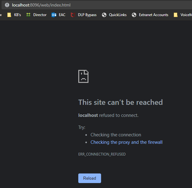

DerrickM 23 Posted May 24, 2021 Author Posted May 24, 2021 I do have one instance of it running but when i click and go to browse library i get: And my service is there but it wont start sorry for the late response, I appreciate the help very much.
