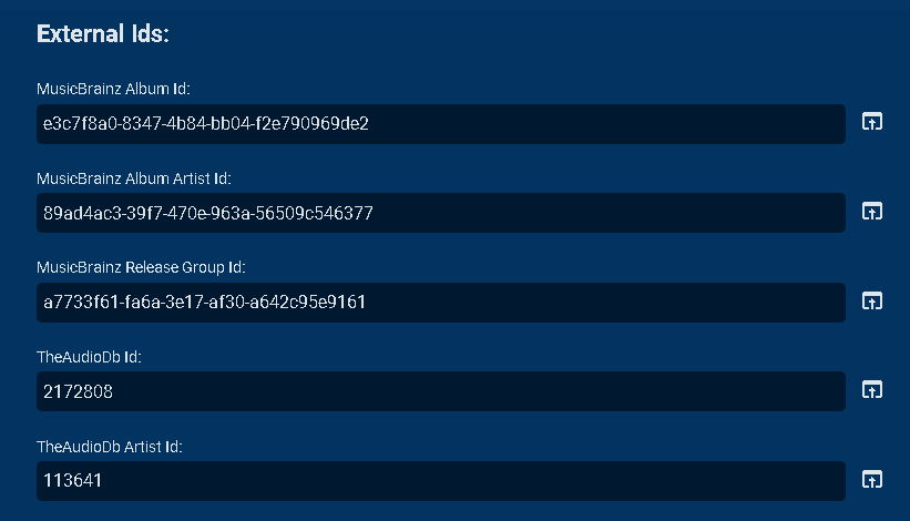

Carlo 4561 Posted May 23, 2021 Posted May 23, 2021 If you look in Emby are these two albums using the same tags? This is a meta-data view of an album If these are the same I would then check how each album is tagged to make sure they have different IDs so Emby knows what albums they actually are.

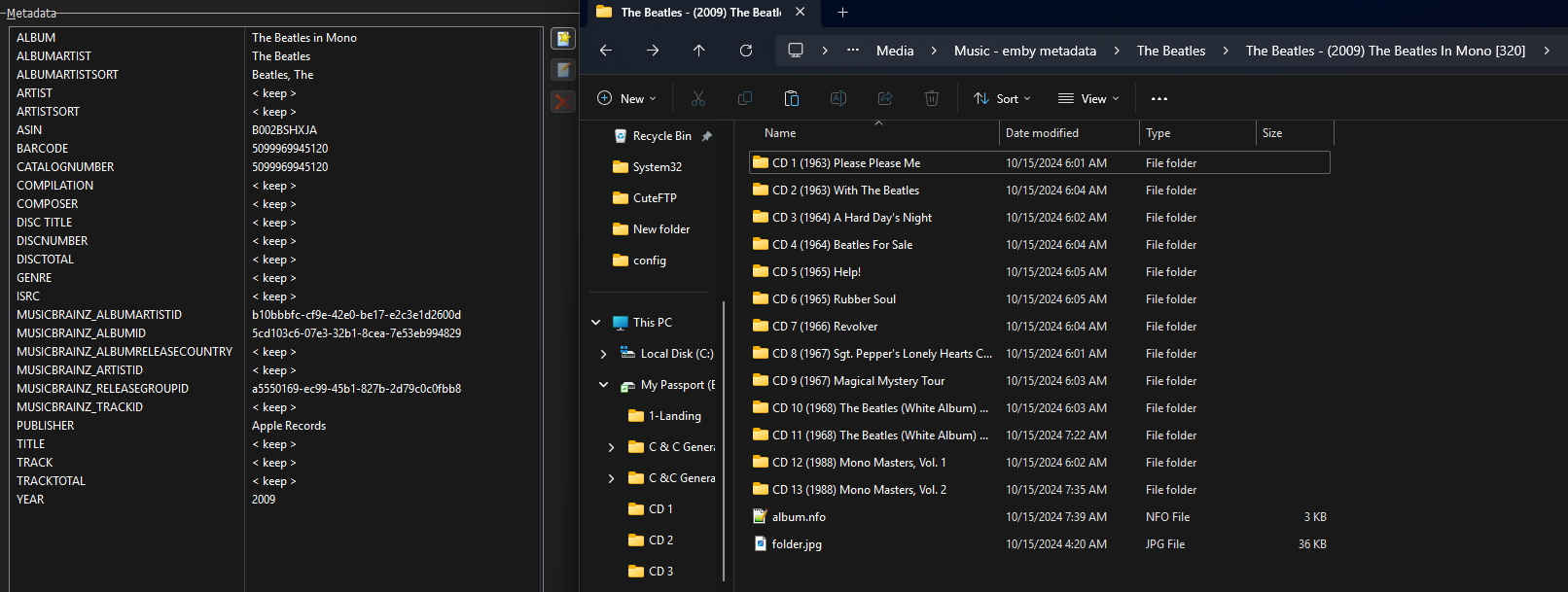

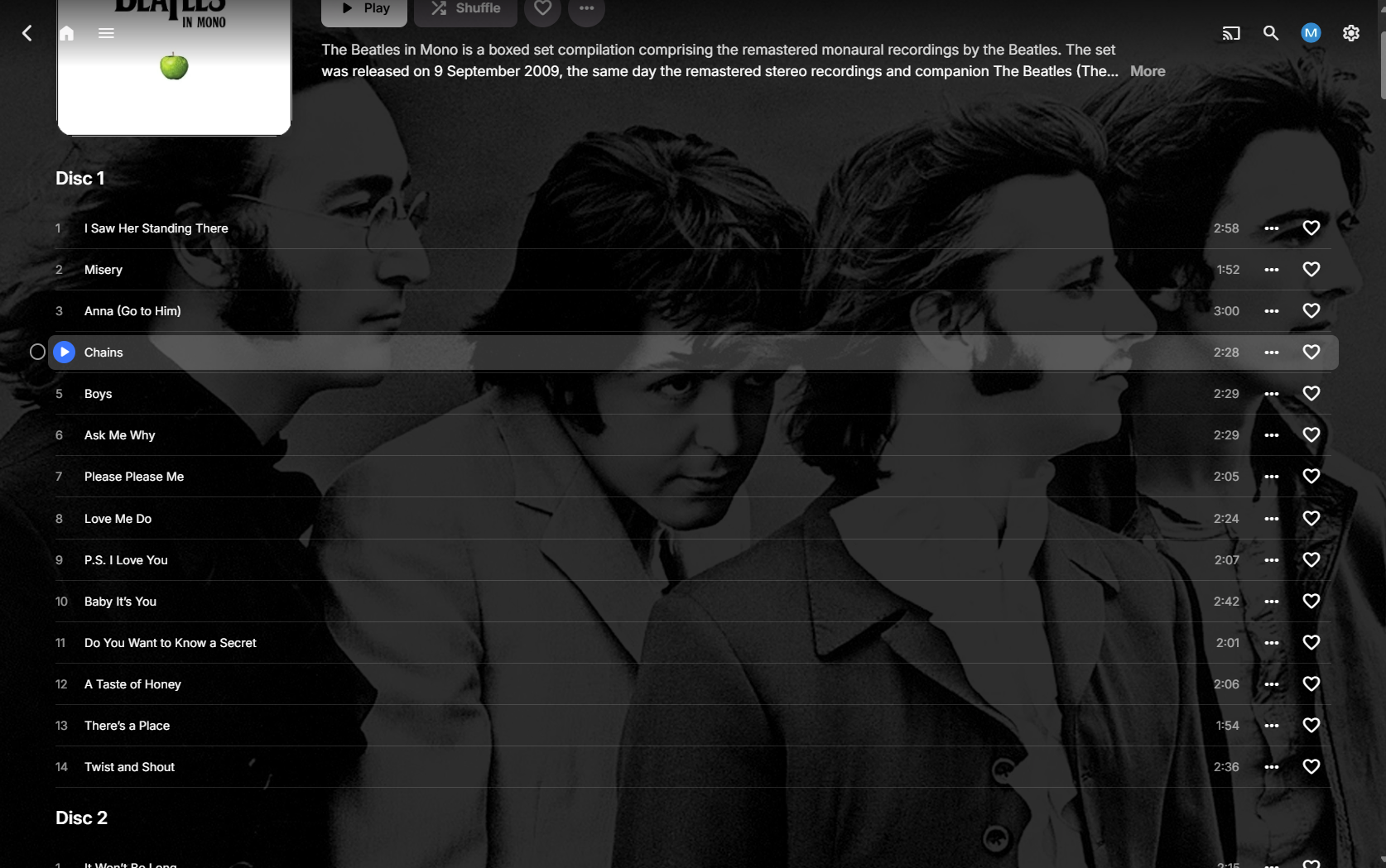

simbun 0 Posted October 15, 2024 Posted October 15, 2024 On 23/05/2021 at 16:50, Luke said: It's combination of name + albumartist + mbz id's that make an album unique, so if those are all the same, then they're the same album. It looks like things have changed over the years because it now appears to be grouping by just MUSICBRAINZ_ALBUMID, if populated. I have both sets of Beatles boxsets (The Beatles and The Beatles is Mono), and can't find a way to stop the albums merging across releases (whilst keeping the tags correct). If Emby supported DiscSubtitle then I could have converted the boxset into an album, but that's not an option either. I'm looking for a new server and have limited experience with Emby, so if anyone has any suggestions they'd be much appreciated.
user24 330 Posted October 15, 2024 Posted October 15, 2024 2 hours ago, simbun said: I have both sets of Beatles boxsets (The Beatles and The Beatles is Mono), and can't find a way to stop the albums merging across releases (whilst keeping the tags correct). Hi, your MB links give different top-level MBIDs for these two box sets: Name: The Beatles (box set, includes 2009 stereo remasters) MBID: 3002658c-fcf9-4f9b-9a41-c96ea3b9e2fc Name: The Beatles in Mono (2009 mono remasters) MBID: a5550169-ec99-45b1-827b-2d79c0c0fbb8 (From some limited testing) if these MBIDs are used as embedded metadata in the MusicBrainz Album field, then Emby will import this and should separate correctly, but you will probably end up with two box sets being imported (with the correct overview info) and not individual albums. You could then separate the albums by Disc number, effectively turing the box sets into multi-disc albums. I also found an old thread with some recent posts that may give more clues/info? There may be others as well??? https://emby.media/community/index.php?/topic/61003-multi-disc-albums-separated-by-disc/page/2/ This may not be exactly what you are after, but perhaps offers some ideas to try? Cheers!
Happy2Play 9798 Posted October 15, 2024 Posted October 15, 2024 12 minutes ago, user24 said: Hi, your MB links give different top-level MBIDs for these two box sets: Name: The Beatles (box set, includes 2009 stereo remasters) MBID: 3002658c-fcf9-4f9b-9a41-c96ea3b9e2fc Name: The Beatles in Mono (2009 mono remasters) MBID: a5550169-ec99-45b1-827b-2d79c0c0fbb8 (From some limited testing) if these MBIDs are used as embedded metadata in the MusicBrainz Album field, then Emby will import this and should separate correctly, but you will probably end up with two box sets being imported (with the correct overview info) and not individual albums. You could then separate the albums by Disc number, effectively turing the box sets into multi-disc albums. Correct they would be two Boxset per those id so all the albums would be tagged as those boxsets not individual albums. If your albums are tagged per name then yes they will be grouped together as same item no matter how you have them organize. Only one done, might get to the other one later. Listed as one album with 13 discs Hmm never noticed Disc 1 was fixed in 4.8.10.0. 1
simbun 0 Posted October 16, 2024 Posted October 16, 2024 20 hours ago, Happy2Play said: Correct they would be two Boxset per those id so all the albums would be tagged as those boxsets not individual albums. If your albums are tagged per name then yes they will be grouped together as same item no matter how you have them organize. This is exactly what I'm seeing. So, if you care about the individual albums then the only option is to disambiguate them somehow e.g. add '(Beatles in Mono)' to the album name. Given that I'm looking for a server to feed Symfonium for Android Auto use, retagging isn't an option as otherwise it'll affect my main system. Given the lack of DiscSubtitle support the sensible option would have been to use a: On 23/05/2021 at 16:50, Luke said: combination of name + albumartist + mbz id's that make an album unique
