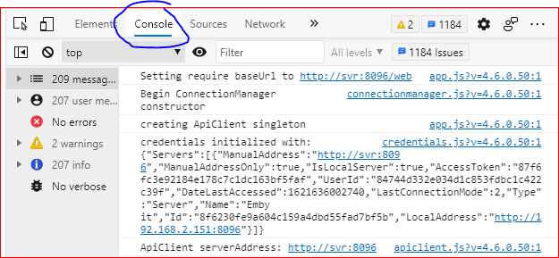

justinrh 264 Posted May 22, 2021 Posted May 22, 2021 @BillybobBilly in your browser, while on the page where you experience the problem, hit F12 (or menu -> developer tools). A new pane will appear, where there will be a Console tab. If you see any errors (and maybe warnings?), copy/paste or take a screenshot. There are ways to filter for errors, but you'll have to figure out that for your browser.
BillybobBilly 18 Posted May 23, 2021 Author Posted May 23, 2021 With a little more testing this appears to be a very inconsistent issue. Some shows have the problem outright while others appear to have this issue with only specific episodes. Additionally, if I manually adjust the playback to around 1 minute remaining the video autoplays the next episode correctly. Only when the file plays for its full duration does this issue come up. @justinrh I will try this the next time I have the issue.

BillybobBilly 18 Posted May 24, 2021 Author Posted May 24, 2021 (edited) On 5/22/2021 at 3:06 PM, justinrh said: @BillybobBilly in your browser, while on the page where you experience the problem, hit F12 (or menu -> developer tools). A new pane will appear, where there will be a Console tab. If you see any errors (and maybe warnings?), copy/paste or take a screenshot. There are ways to filter for errors, but you'll have to figure out that for your browser. These two errors appear on the page where this is an issue (under each error it says "next episode starting in 0 seconds"): getGamepad will now require Secure Context. gamepadtokey.js?v=4.6.0.50:1 Please update your application accordingly. For more information see https://github.com/w3c/gamepad/pull/120 DevTools failed to load SourceMap: Could not load content for http://Address.Removed: HTTP error: status code 404, net::ERR_HTTP_RESPONSE_CODE_FAILURE Edited May 24, 2021 by BillybobBilly
