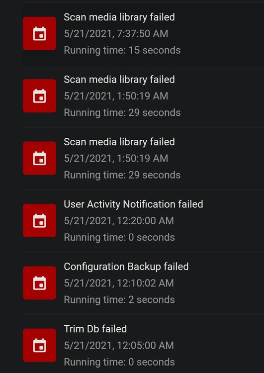

rblackhaw 3 Posted May 22, 2021 Posted May 22, 2021 4.6.0.50 updated two days ago and I've been getting multiple "Scan media library failed" alerts as well as "User activity notification failed", "Configuration backup failed", and a "Trim db failed" alerts. I'm unable to add new content since the scans aren't working. The Activity section has stopped showing users online or disconnected and is no longer showing playing or finished content. I have rebooted my pc and restarted Emby but nothing has changed. embyserver.txt
Happy2Play 9802 Posted May 22, 2021 Posted May 22, 2021 14 minutes ago, rblackhaw said: 4.6.0.50 updated two days ago and I've been getting multiple "Scan media library failed" alerts as well as "User activity notification failed", "Configuration backup failed", and a "Trim db failed" alerts. I'm unable to add new content since the scans aren't working. The Activity section has stopped showing users online or disconnected and is no longer showing playing or finished content. I have rebooted my pc and restarted Emby but nothing has changed. embyserver.txt 2.73 MB · 0 downloads Your database is locked please restart your system and try again. SQLitePCL.pretty.SQLiteException: Busy: database is locked

Happy2Play 9802 Posted May 22, 2021 Posted May 22, 2021 4 minutes ago, rblackhaw said: I restarted again and library scan is still failing. embyserver-2.txt 256.03 kB · 0 downloads Your database is still locked. This usually means you have two instances of Emby running against the same database. With Emby shutdown how many library.db files do you see in C:\Users\Berd\AppData\Roaming\Emby-Server\programdata\data? Does taskmanager still show Emby still running?
rblackhaw 3 Posted May 22, 2021 Author Posted May 22, 2021 Emby was showing twice in taskmanager before shutting down Emby. Once after shutting down. I ended that one and restarted Emby. The library scan worked and it seems to be working now. Thanks for your help!
Happy2Play 9802 Posted May 22, 2021 Posted May 22, 2021 11 minutes ago, rblackhaw said: Emby was showing twice in taskmanager before shutting down Emby. Once after shutting down. I ended that one and restarted Emby. The library scan worked and it seems to be working now. Thanks for your help! I wonder by chance is startup launching Emby and your service launching Emby?
rblackhaw 3 Posted May 22, 2021 Author Posted May 22, 2021 16 minutes ago, Happy2Play said: I wonder by chance is startup launching Emby and your service launching Emby? I've been running it as a service but I just checked and it is showing up under Startup Apps too which I never set before.
Happy2Play 9802 Posted May 22, 2021 Posted May 22, 2021 30 minutes ago, rblackhaw said: I've been running it as a service but I just checked and it is showing up under Startup Apps too which I never set before. Is the option enabled on Dashboard-Settings?
rblackhaw 3 Posted May 22, 2021 Author Posted May 22, 2021 9 minutes ago, Happy2Play said: Is the option enabled on Dashboard-Settings? Yep, it is. I must have not been paying attention and enabled it at some point. I know it wasn't set before.
