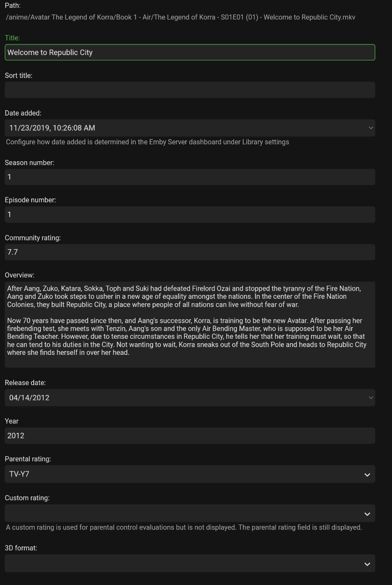

Luke 42203 Posted May 21, 2021 Posted May 21, 2021 In the emby metadata editor, do the episodes have a season number filled out?
gokuz 13 Posted May 21, 2021 Author Posted May 21, 2021 Just now, Luke said: In the emby metadata editor, do the episodes have a season number filled out? No, i gave a screenshot of it somewhere in the first page. it's empty. Being empty, it still works in 4.5.4.0
Luke 42203 Posted May 21, 2021 Posted May 21, 2021 Just now, gokuz said: No, i gave a screenshot of it somewhere in the first page. it's empty. Being empty, it still works in 4.5.4.0 It appears you have a screenshot at the season level.
gokuz 13 Posted May 21, 2021 Author Posted May 21, 2021 Just now, Luke said: It appears you have a screenshot at the season level. Oops read it wrongly sorry. Yes, all my .nfo has correct seasons for each and every episodes.
gokuz 13 Posted May 21, 2021 Author Posted May 21, 2021 1 minute ago, Luke said: In the emby metadata editor, do the episodes have a season number filled out? Yes
Luke 42203 Posted May 21, 2021 Posted May 21, 2021 Ok so it's the combination of season with no season number + episodes underneath with both season and episode numbers. I see why that's happening. We'll have a 4.6.1 maintenance update out early next week. If you need immediate relief I'll have the fix up on the beta channel tonight. 1
