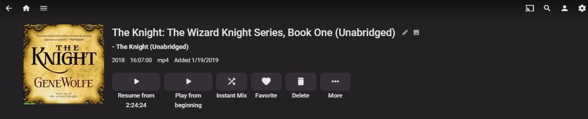

miniliQuid 95 Posted May 29, 2021 Author Posted May 29, 2021 (edited) 11 hours ago, Happy2Play said: Do you get the same results in the web client? I have only test in web client without issue as shown above. Unfortunately in the web client it is worse, but not for every file. In the web version he also doesn't save the point where you left off. Unfortunately, with some files it even doesnt show you where you skipped forward to either, but instead shows as if it is still playing from the start 0:00. However listening to it, it has definitely skipped forward in the book and is playing from the selected area. Edited May 29, 2021 by miniliQuid
