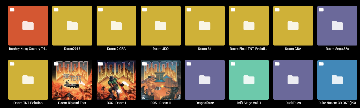

jonomite 29 Posted May 21, 2021 Posted May 21, 2021 (edited) After upgrading to the new version of Emby server, I am experiencing odd behavior with album cover art not displaying in my music library. For example, if I am viewing an artist's info page, Emby displays all of the albums, but none of them show album art. The only way I have found to get the album art to display is to refresh metadata and to leave "replace existing images" unchecked. After refreshing, the album art properly displays. I have tried a library scan, refreshing my music library metadata with replace existing images checked and unchecked and nothing has corrected the issue. The only way I've found to correct it is to individually refresh metadata on the album itself. Edited May 21, 2021 by jonomite 1
Volodesi 11 Posted May 21, 2021 Posted May 21, 2021 Same here. All my other Movies/TV Show is fine.. but my Album art for most of my music is gone.. which I painstakingly set myself through Emby. The art files are still in the folders with each album.. but 80% of them don't show anymore. Going through and manually doing this is about to drive me crazy., 1
Happy2Play 9814 Posted May 21, 2021 Posted May 21, 2021 Has a library scan completed? Emby MusicBrainz server is getting hit pretty hard with this server update so you many need to check your server log.
Volodesi 11 Posted May 21, 2021 Posted May 21, 2021 Just now, Happy2Play said: Has a library scan completed? Emby MusicBrainz server is getting hit pretty hard with this server update so you many need to check your server log. I don't use any fetchers for my music. I manually do all my Meta-data for music and used Emby to set the Primary images for each folder. I had Emby set to store the images as hidden files.. and they're all in there.. but Emby just isn't using them for some reason. All looked fine before. 1

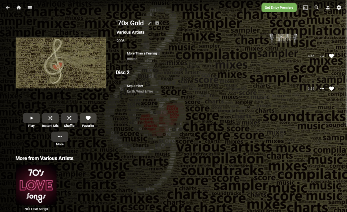

echoxxzz 22 Posted May 25, 2021 Posted May 25, 2021 On 21/05/2021 at 12:25, Luke said: In order to use local artwork, you need to pick one of the two structured options. Artwork embedded into audio files does not require this though. Really? It seems to be hit and miss when it grabs local cover art. Mostly I find it never reads local cover art when the Album Artist = "Various Artists" and the album has multiple discs. For years I have used the same folder structure for all my music and it has just worked. I use \Album Artist\Album\(Disc X)\ Are you saying I have to change my folder structure for all my music now? If so what is the preferred working structure to get latest Emby to read in local cover art?
Luke 42289 Posted May 25, 2021 Posted May 25, 2021 1 minute ago, echoxxzz said: Really? It seems to be hit and miss when it grabs local cover art. Mostly I find it never reads local cover art when the Album Artist = "Various Artists" and the album has multiple discs. For years I have used the same folder structure for all my music and it has just worked. I use \Album Artist\Album\(Disc X)\ Are you saying I have to change my folder structure for all my music now? If so what is the preferred working structure to get latest Emby to read in local cover art? That folder structure sounds fine, but make sure to configure the library option I mentioned. The folder name must also exactly match the album artist tag in the audio files
echoxxzz 22 Posted May 25, 2021 Posted May 25, 2021 5 hours ago, Luke said: That folder structure sounds fine, but make sure to configure the library option I mentioned. The folder name must also exactly match the album artist tag in the audio files I've tried all the available options and nothing works. Emby just won't import local cover art for multi-disc albums when the AlbumArtist tag is "Various Artists". I setup this very simplified folder structure to test with (see attached .rar file): Z:\Music\Guns N' Roses\G N' R Lies\(Disc 1)\05 - Patience.mp3 Z:\Music\Guns N' Roses\G N' R Lies\(Disc 1)\folder.jpg Z:\Music\Guns N' Roses\Live Era '87-'93\(Disc 1)\01 - Nightrain.mp3 Z:\Music\Guns N' Roses\Live Era '87-'93\(Disc 1)\folder.jpg Z:\Music\Guns N' Roses\Live Era '87-'93\(Disc 2)\11 - Paradise City.mp3 Z:\Music\Guns N' Roses\Live Era '87-'93\(Disc 2)\folder.jpg Z:\Music\Various Artists\'70s Gold\(Disc 1)\01 - Boston - More Than a Feeling.mp3 Z:\Music\Various Artists\'70s Gold\(Disc 1)\folder.jpg Z:\Music\Various Artists\'70s Gold\(Disc 2)\01 - Earth, Wind & Fire - September.mp3 Z:\Music\Various Artists\'70s Gold\(Disc 2)\folder.jpg Z:\Music\Various Artists\70's Love Songs\(Disc 1)\01 - Daryl Hall & John Oates - She's Gone.mp3 Z:\Music\Various Artists\70's Love Songs\(Disc 1)folder.jpg and the multi-disc album "'70s Gold" never imports the local cover art but the multiple disc album "Live Era '87-'93" does. I use MusicBrainz PiCard to tag all my music so I know the tags are set perfectly. Music Sample.rar
Luke 42289 Posted May 25, 2021 Posted May 25, 2021 Does the server show 70s fold as one album with two discs, or two different albums? If it's one album, then the album-level artwork needs to be in the 70s gold folder, not in the disc folder.
echoxxzz 22 Posted May 25, 2021 Posted May 25, 2021 (edited) 36 minutes ago, Luke said: Does the server show 70s fold as one album with two discs, or two different albums? If it's one album, then the album-level artwork needs to be in the 70s gold folder, not in the disc folder. It correctly shows up as a 2 disc album. For the sake of complete testing I'll trying putting the folder.jpg into the album folder as well. . Edited May 25, 2021 by echoxxzz
Luke 42289 Posted May 25, 2021 Posted May 25, 2021 1 minute ago, echoxxzz said: It correctly shows up as a 2 disc album . Right then we're not looking in the disc subfolders for artwork, only in the album root folder. That's not to say we can't start doing that, I just haven't seen this usage before.
echoxxzz 22 Posted May 25, 2021 Posted May 25, 2021 3 minutes ago, echoxxzz said: It correctly shows up as a 2 disc album. For the sake of complete testing I'll trying putting the folder.jpg into the album folder as well. . Putting the folder.jpg into the album folder didn't help either.
