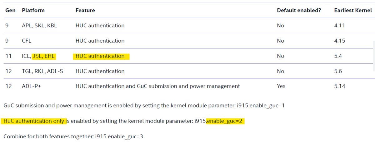

ivybridge0 1 Posted February 20, 2022 Posted February 20, 2022 According to Nyanmisaka---Jellyfin developer, focusing on video streaming via FFmpeg, https://github.com/nyanmisaka . In https://www.chiphell.com/thread-2375777-1-1.html , he also said: Enabling Low-Power low voltage mode can improve Intel's transcoding and tone mapping performance. This function can be enabled directly under Windows, but under Linux, you need to manually add the kernel parameter i915.enable_guc=2 to use it. Processors before the 11th generation only support Low-Power H.264. Under Linux, for Intel graphics, it is recommended to use QSV instead of VAAPI. QSV usually provides higher throughput. I think intel turn their new MSDK to support QSV,but VAAPI support is out of date for these new devices.We even need manually add the kernel parameter i915.enable_guc=2,its so complex for nomal users..To fix them,maybe we should wait updates/patches about intel-media and linux mainline kernal.
softworkz 5133 Posted February 20, 2022 Posted February 20, 2022 (edited) 1 hour ago, ivybridge0 said: Enabling Low-Power low voltage mode can improve Intel's transcoding and tone mapping performance Yes, but not necessarily with equal or better quality. "Low-Power" means that encoding is done by a fixed-function block on the CPU die, while the "normal" mode works by employing a mix of hardware features like (video motion estimation) and GPU kernel shaders which can be loaded and are part of the driver (for VAAPI) or external (MSDK - has its own shader kernels). see "two modes": https://github.com/intel/media-driver#components-and-features 1 hour ago, ivybridge0 said: processors before the 11th generation only support Low-Power H.264 This is not true. Almost all generations had support for both ways. There's also no change about that for future generations, only this specific platform (Elkhart/Jasper) doesn't support the "normal" mode, because it doesn't have the VME component in the GPU. see: https://github.com/intel/media-driver#decodingencoding-features 1 hour ago, ivybridge0 said: Under Linux, for Intel graphics, it is recommended to use QSV instead of VAAPI. QSV usually provides higher throughput. Yes, QSV usually provides better quality and performance in general, because it does a number of things differently compared to plain VAAPI use. 1 hour ago, ivybridge0 said: I think intel turn their new MSDK to support QSV, IIRC, MSDK always had it's own VME implementation (don't know whether as shaders or in software), and that's why it can overcome the limitation with the missing VME component without much effort. 1 hour ago, ivybridge0 said: but VAAPI support is out of date for these new devices No, it's not. It's only a hardware limitation, not a VAAPI limitation and it's not about "new" devices it's only about that special target platform (low cost, low power consumption). 1 hour ago, ivybridge0 said: We even need manually add the kernel parameter i915.enable_guc=2,its so complex for nomal users.. I think the process is not that difficult. You need to run a single command only. When you do Linux, this shouldn't be an exciting task. see #3: https://github.com/intel/media-driver#known-issues-and-limitations 1 hour ago, ivybridge0 said: To fix them,maybe we should wait updates/patches about intel-media and linux mainline kernal. To me, it rather looks like it is intentional to have it disabled by default, I wouldn't expect this to change. Interestingly, for ADL-P+, it IS enabled by default. At some place they are calling this functionality "unsafe", so there most be something they are afraid of and hence the disabled-by-default. see: https://01.org/linuxgraphics/downloads/firmware?langredirect=1 What I would be curious about is How does your HW detection log look like after you have set this kernel option? Edited February 20, 2022 by softworkz
ivybridge0 1 Posted February 20, 2022 Posted February 20, 2022 35 minutes ago, softworkz said: I think the process is not that difficult. You need to run a single command only. When you do Linux, this shouldn't be an exciting task. see #3: https://github.com/intel/media-driver#known-issues-and-limitations To me, it rather looks like it is intentional to have it disabled by default, I wouldn't expect this to change. Interestingly, for ADL-P+, it IS enabled by default. At some place they are calling this functionality "unsafe", so there most be something they are afraid of and hence the disabled-by-default. see: https://01.org/linuxgraphics/downloads/firmware?langredirect=1 What I would be curious about is How does your HW detection log look like after you have set this kernel option? Thanks for your professional explains. I set the kernal option i915.enable_guc=3 three days ago,when I upgraded the kernal from ubuntu20.04lts original 5.13 to mainline 5.16. I remember I see something in github,which is about setting guc=3 means to enable both huc and guc,then I did it.Nothing is wrong for now. Here are logs when emby-ffmpeg transcoded normally with hwacc. ffmpeg-transcode-36163a6d-5fc3-49b3-b85e-f3daf4677bd1_1.txt
softworkz 5133 Posted February 20, 2022 Posted February 20, 2022 Thanks. According to the table, you need to set it to 2:

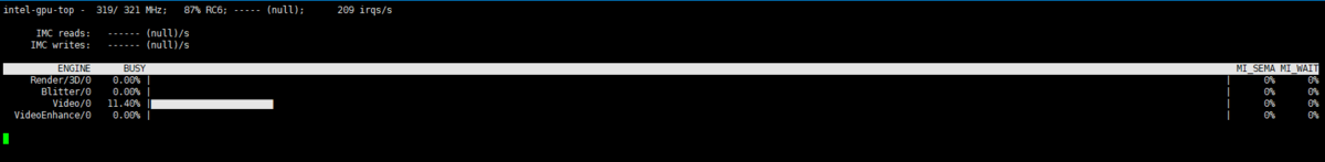

ivybridge0 1 Posted February 23, 2022 Posted February 23, 2022 5 hours ago, softworkz said: It's weird that no VAAPI encoders are detected. You said you had compiled all the latest drivers and Intel components and it worked that way. What was actually working with that test - VAAPI or QSV? Okay,let me show u. Here is vainfo: root@N5095:~# vainfo error: can't connect to X server! libva info: VA-API version 1.15.0 libva info: User environment variable requested driver 'iHD' libva info: Trying to open /usr/lib/x86_64-linux-gnu/dri//iHD_drv_video.so libva info: Found init function __vaDriverInit_1_15 libva info: va_openDriver() returns 0 vainfo: VA-API version: 1.15 (libva 2.13.0) vainfo: Driver version: Intel iHD driver for Intel(R) Gen Graphics - 22.2.1 (7e357b4be) vainfo: Supported profile and entrypoints VAProfileNone : VAEntrypointVideoProc VAProfileNone : VAEntrypointStats VAProfileMPEG2Simple : VAEntrypointVLD VAProfileMPEG2Main : VAEntrypointVLD VAProfileH264Main : VAEntrypointVLD VAProfileH264Main : VAEntrypointEncSliceLP VAProfileH264High : VAEntrypointVLD VAProfileH264High : VAEntrypointEncSliceLP VAProfileVC1Simple : VAEntrypointVLD VAProfileVC1Main : VAEntrypointVLD VAProfileVC1Advanced : VAEntrypointVLD VAProfileJPEGBaseline : VAEntrypointVLD VAProfileJPEGBaseline : VAEntrypointEncPicture VAProfileH264ConstrainedBaseline: VAEntrypointVLD VAProfileH264ConstrainedBaseline: VAEntrypointEncSliceLP VAProfileVP8Version0_3 : VAEntrypointVLD VAProfileHEVCMain : VAEntrypointVLD VAProfileHEVCMain : VAEntrypointEncSliceLP VAProfileHEVCMain10 : VAEntrypointVLD VAProfileHEVCMain10 : VAEntrypointEncSliceLP VAProfileVP9Profile0 : VAEntrypointVLD VAProfileVP9Profile0 : VAEntrypointEncSliceLP VAProfileVP9Profile1 : VAEntrypointVLD VAProfileVP9Profile1 : VAEntrypointEncSliceLP VAProfileVP9Profile2 : VAEntrypointVLD VAProfileVP9Profile2 : VAEntrypointEncSliceLP VAProfileVP9Profile3 : VAEntrypointVLD VAProfileVP9Profile3 : VAEntrypointEncSliceLP VAProfileHEVCMain422_10 : VAEntrypointVLD VAProfileHEVCMain444 : VAEntrypointVLD VAProfileHEVCMain444 : VAEntrypointEncSliceLP VAProfileHEVCMain444_10 : VAEntrypointVLD VAProfileHEVCMain444_10 : VAEntrypointEncSliceLP When I run ffmpeg with qsv, ffmpeg -hwaccel qsv -c:v vp9_qsv -i input.webm -vf hwdownload,format=nv12 -pix_fmt yuv420p output.yuv output logs: root@N5095:~# ffmpeg -hwaccel qsv -c:v vp9_qsv -i input.webm -vf hwdownload,format=nv12 -pix_fmt yuv420p output.yuv ffmpeg version N-105688-g0d34e21282 Copyright (c) 2000-2022 the FFmpeg developers built with gcc 9 (Ubuntu 9.3.0-17ubuntu1~20.04) configuration: --arch=x86_64 --disable-yasm --enable-vaapi --enable-libmfx libavutil 57. 21.100 / 57. 21.100 libavcodec 59. 21.100 / 59. 21.100 libavformat 59. 17.102 / 59. 17.102 libavdevice 59. 5.100 / 59. 5.100 libavfilter 8. 27.100 / 8. 27.100 libswscale 6. 5.100 / 6. 5.100 libswresample 4. 4.100 / 4. 4.100 WARNING: defaulting hwaccel_output_format to qsv for compatibility with old commandlines. This behaviour is DEPRECATED and will be removed in the future. Please explicitly set "-hwaccel_output_format qsv". Input #0, matroska,webm, from 'input.webm': Metadata: COMPATIBLE_BRANDS: qt MAJOR_BRAND : qt MINOR_VERSION : 537199360 ENCODER : Lavf58.34.101 Duration: 00:02:17.70, start: 0.000000, bitrate: 9644 kb/s Stream #0:0(eng): Video: vp9 (Profile 0), yuv420p(tv), 1920x1080, SAR 1:1 DAR 16:9, 29.97 fps, 29.97 tbr, 1k tbn (default) Metadata: HANDLER_NAME : Apple Video Media Handler TIMECODE : 00:16:14:29 ENCODER : Lavc58.61.100 libvpx-vp9 DURATION : 00:02:17.704000000 Stream mapping: Stream #0:0 -> #0:0 (vp9 (vp9_qsv) -> rawvideo (native)) Press [q] to stop, [?] for help Output #0, rawvideo, to 'output.yuv': Metadata: COMPATIBLE_BRANDS: qt MAJOR_BRAND : qt MINOR_VERSION : 537199360 encoder : Lavf59.17.102 Stream #0:0(eng): Video: rawvideo (I420 / 0x30323449), yuv420p(tv, progressive), 1920x1080 [SAR 1:1 DAR 16:9], q=2-31, 745750 kb/s, 29.97 fps, 29.97 tbn (default) Metadata: HANDLER_NAME : Apple Video Media Handler TIMECODE : 00:16:14:29 DURATION : 00:02:17.704000000 encoder : Lavc59.21.100 rawvideo [vp9_qsv @ 0x559d62b073c0] A decode call did not consume any data: expect more data at input (-10) Last message repeated 1 times [vp9_qsv @ 0x559d62b073c0] A decode call did not consume any data: expect more data at input (-10) frame= 4127 fps= 69 q=-0.0 Lsize=12535762kB time=00:02:17.70 bitrate=745750.3kbits/s speed= 2.3x video:12535762kB audio:0kB subtitle:0kB other streams:0kB global headers:0kB muxing overhead: 0.000000% with intel_gpu_top(picture 1),gpu was working. Then,I tried ffmpeg -hwaccel vaapi -hwaccel_device /dev/dri/renderD128 -hwaccel_output_format vaapi -i input.webm -c:v h264_vaapi -b:v 2M -maxrate 2M output.mp4 output logs: root@N5095:~# ffmpeg -hwaccel vaapi -hwaccel_device /dev/dri/renderD128 -hwaccel_output_format vaapi -i input.webm -c:v h264_vaapi -b:v 2M -maxrate 2M output.mp4 ffmpeg version N-105688-g0d34e21282 Copyright (c) 2000-2022 the FFmpeg developers built with gcc 9 (Ubuntu 9.3.0-17ubuntu1~20.04) configuration: --arch=x86_64 --disable-yasm --enable-vaapi --enable-libmfx libavutil 57. 21.100 / 57. 21.100 libavcodec 59. 21.100 / 59. 21.100 libavformat 59. 17.102 / 59. 17.102 libavdevice 59. 5.100 / 59. 5.100 libavfilter 8. 27.100 / 8. 27.100 libswscale 6. 5.100 / 6. 5.100 libswresample 4. 4.100 / 4. 4.100 Input #0, matroska,webm, from 'input.webm': Metadata: COMPATIBLE_BRANDS: qt MAJOR_BRAND : qt MINOR_VERSION : 537199360 ENCODER : Lavf58.34.101 Duration: 00:02:17.70, start: 0.000000, bitrate: 9644 kb/s Stream #0:0(eng): Video: vp9 (Profile 0), yuv420p(tv), 1920x1080, SAR 1:1 DAR 16:9, 29.97 fps, 29.97 tbr, 1k tbn (default) Metadata: HANDLER_NAME : Apple Video Media Handler TIMECODE : 00:16:14:29 ENCODER : Lavc58.61.100 libvpx-vp9 DURATION : 00:02:17.704000000 File 'output.mp4' already exists. Overwrite? [y/N] y Stream mapping: Stream #0:0 -> #0:0 (vp9 (native) -> h264 (h264_vaapi)) Press [q] to stop, [?] for help [mp4 @ 0x563fb9942f80] Application provided duration: -9223372036854775808 / timestamp: -9223372036854775808 is out of range for mov/mp4 format [mp4 @ 0x563fb9942f80] pts has no value Output #0, mp4, to 'output.mp4': Metadata: COMPATIBLE_BRANDS: qt MAJOR_BRAND : qt MINOR_VERSION : 537199360 encoder : Lavf59.17.102 Stream #0:0(eng): Video: h264 (High) (avc1 / 0x31637661), vaapi(tv, progressive), 1920x1080 [SAR 1:1 DAR 16:9], q=2-31, 2000 kb/s, 29.97 fps, 30k tbn (default) Metadata: HANDLER_NAME : Apple Video Media Handler TIMECODE : 00:16:14:29 DURATION : 00:02:17.704000000 encoder : Lavc59.21.100 h264_vaapi frame= 4127 fps=153 q=-0.0 Lsize= 33586kB time=00:02:17.67 bitrate=1998.5kbits/s speed=5.09x video:33568kB audio:0kB subtitle:0kB other streams:0kB global headers:0kB muxing overhead: 0.053766% with intel_gpu_top(picture 2),gpu was working,too.
ivybridge0 1 Posted February 23, 2022 Posted February 23, 2022 In addition,for some kernal error logs about bpfilter,I change kernal to ubuntu origin 5.13.0-30,and set guc=2 yesterday.
