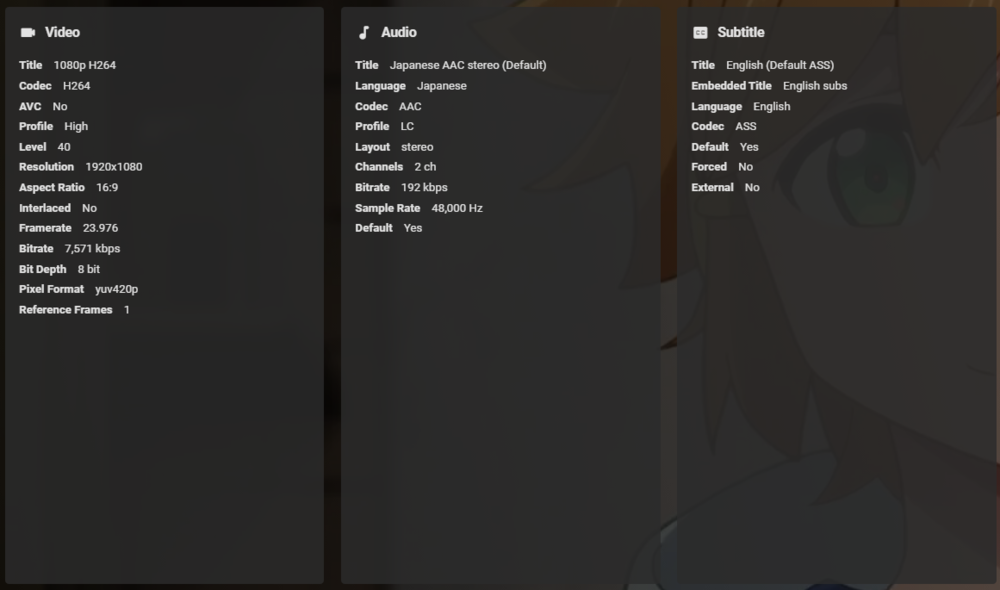

kieve 2 Posted May 24, 2021 Author Posted May 24, 2021 Some more information: This is an example of a file having the issue: I have noticed the following: When I turn on subs, it loads them from this url: http://10.81.1.1:8096/emby/Videos/20066/d3104a80dd7f906a7232bd6d5b8a8a36/Subtitles/2/0/Stream.ass This sub file appears to be empty: [Script Info] Title: English (US) ScriptType: v4.00+ Collisions: Normal PlayDepth: 0 WrapStyle: 0 ScaledBorderAndShadow: yes PlayResX: 640 PlayResY: 360 [V4+ Styles] Format: Name, Fontname, Fontsize, PrimaryColour, SecondaryColour, OutlineColour, BackColour, Bold, Italic, Underline, StrikeOut, ScaleX, ScaleY, Spacing, Angle, BorderStyle, Outline, Shadow, Alignment, MarginL, MarginR, MarginV, Encoding Style: Default,Roboto Medium,26,&H00FFFFFF,&H000000FF,&H00020713,&H00000000,0,0,0,0,100,100,0,0,1,1.3,0,2,20,20,23,1 [Events] Format: Layer, Start, End, Style, Name, MarginL, MarginR, MarginV, Effect, Text But, if I change the URL to (I changed the last part from /2/0/Stream.ass to /2/1/Stream.ass): http://10.81.1.1:8096/emby/Videos/20066/d3104a80dd7f906a7232bd6d5b8a8a36/Subtitles/2/1/Stream.ass It has the actual lines: [Script Info] Title: English (US) ScriptType: v4.00+ Collisions: Normal PlayDepth: 0 WrapStyle: 0 ScaledBorderAndShadow: yes PlayResX: 640 PlayResY: 360 [V4+ Styles] Format: Name, Fontname, Fontsize, PrimaryColour, SecondaryColour, OutlineColour, BackColour, Bold, Italic, Underline, StrikeOut, ScaleX, ScaleY, Spacing, Angle, BorderStyle, Outline, Shadow, Alignment, MarginL, MarginR, MarginV, Encoding Style: Default,Roboto Medium,26,&H00FFFFFF,&H000000FF,&H00020713,&H00000000,0,0,0,0,100,100,0,0,1,1.3,0,2,20,20,23,1 [Events] Format: Layer, Start, End, Style, Name, MarginL, MarginR, MarginV, Effect, Text Dialogue: 0,0:01:04.25,0:01:05.25,Default,,0,0,0,,Huh? (I only included the first line here)
