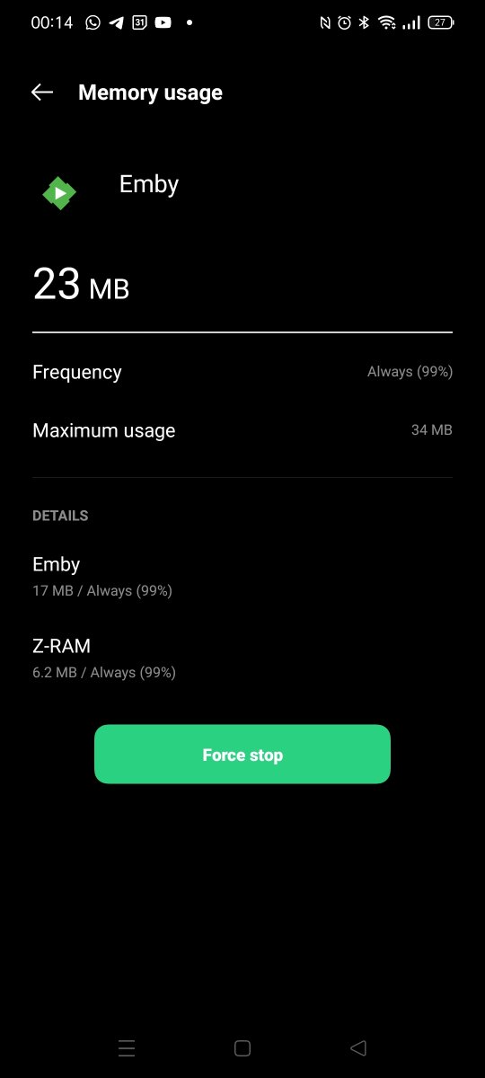

Bazzu85 22 Posted July 9, 2021 Author Posted July 9, 2021 (edited) On 07/07/2021 at 19:07, Luke said: Can you try the beta version of the app and see how that compares? Thanks. I don't notice differences.. Emby for Android 3.2.03 I found this about background services.. https://stackoverflow.com/questions/59442078/background-services-are-restricted-in-xiaomi-and-oppo can you give it a check? I have a oppo find x2 lite btw where is the correct session to check if the app is still running in background? is the memory usage section the right one? Edited July 9, 2021 by Bazzu85

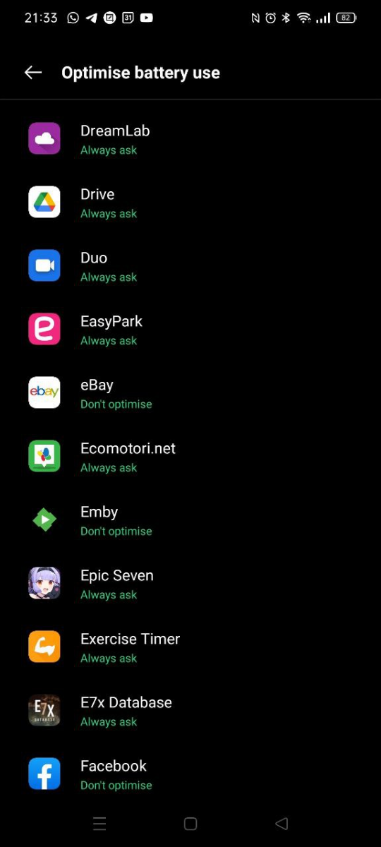

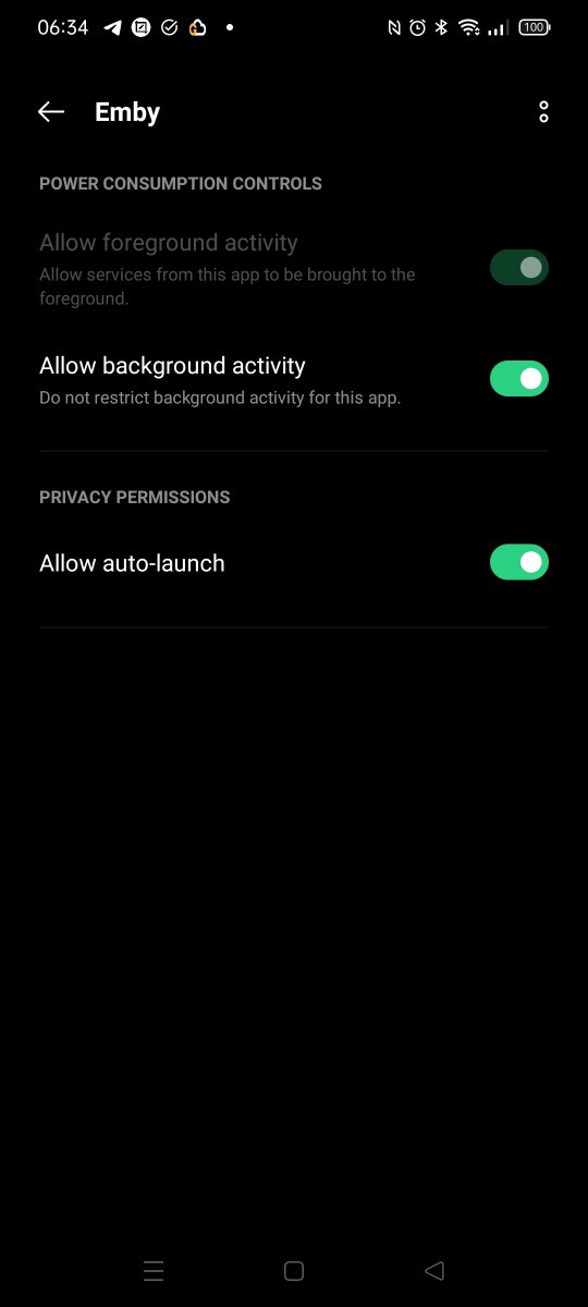

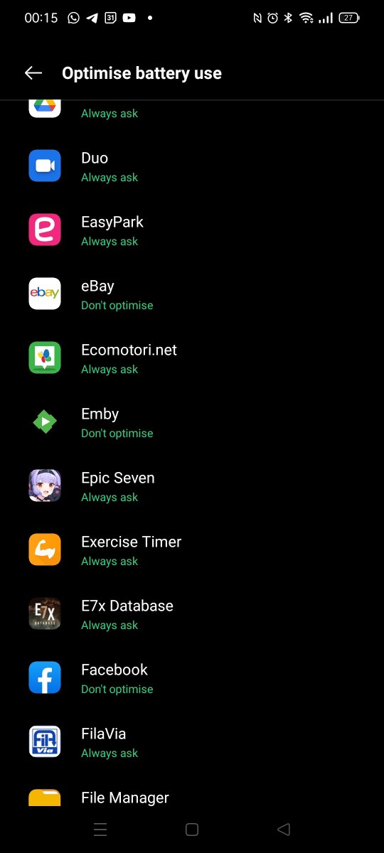

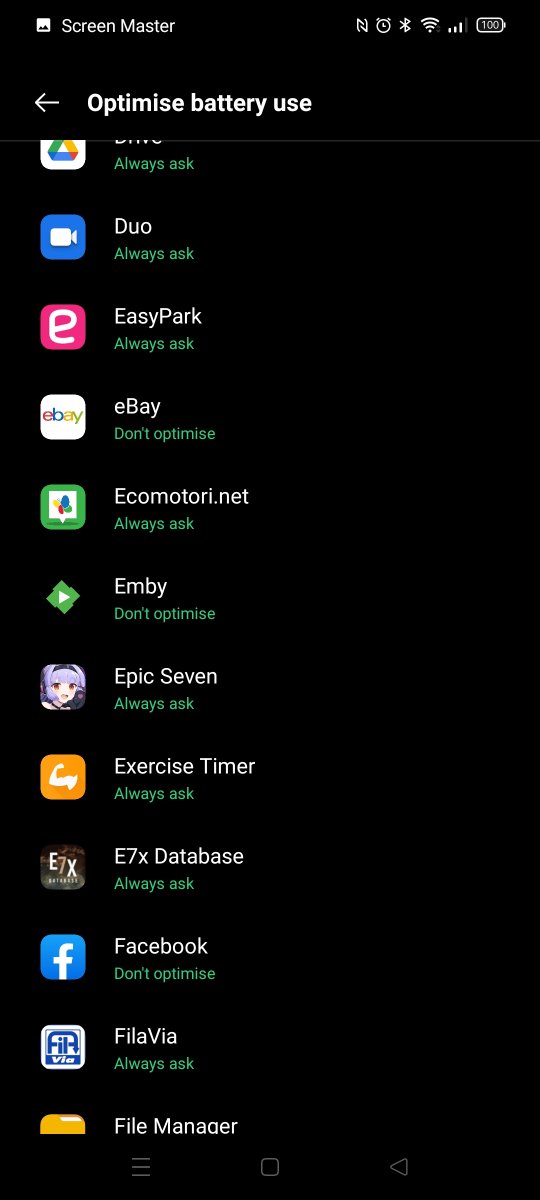

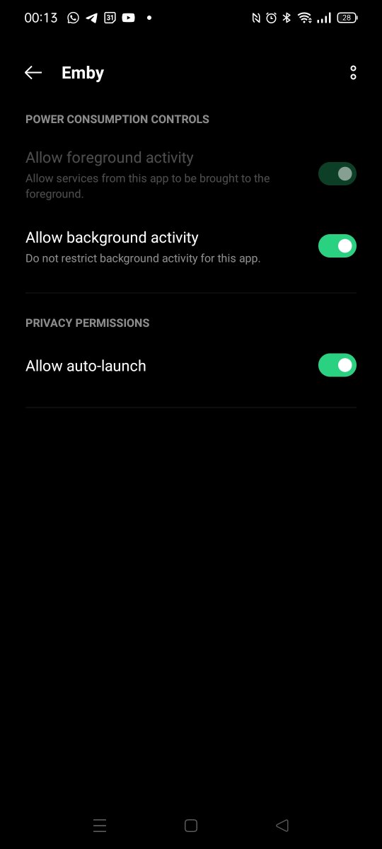

Bazzu85 22 Posted July 18, 2021 Author Posted July 18, 2021 13 hours ago, Luke said: I would take a look at this: https://dontkillmyapp.com/oppo H, I checked the suggestions but the link is 3 years old (at least) 1. Pin your app to the recent apps screen. done. check the lock icon on top: 2. Enable your app in the app list inside the security app’s “startup manager” and “floating app list” (com.coloros.safecenter / com.coloros.safecenter.permission.Permission). These are section not yet in ColorOs 11 settings. The only related section is this: and as you see I already enabled the exeption for emby. Additionally I checked the blocking records section that list the blocked app over time and emby is not recorded 3. Turn off battery optimizations. done: 4. Give the service a persistent notification to remain in the foreground. this is not something a user can do if the app doesn't permit it. at this point I ask you.. how can I debug if the app as this background service is running? I have to search some particular setting on the phone? I have to search some record on the server logs?

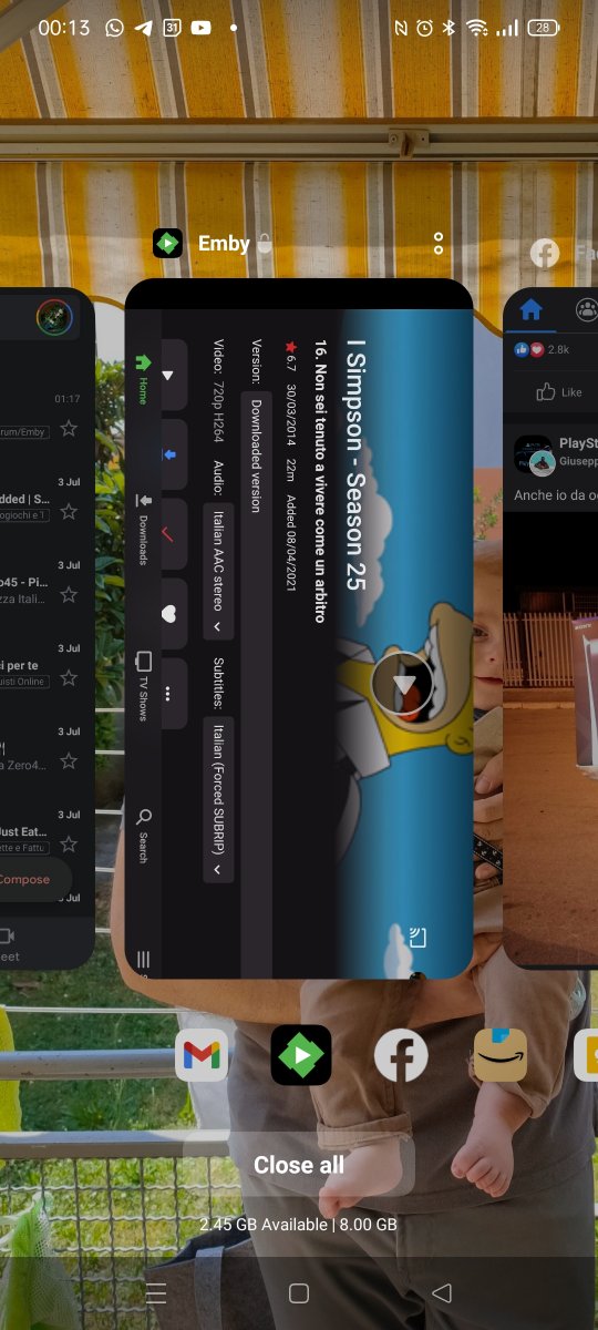

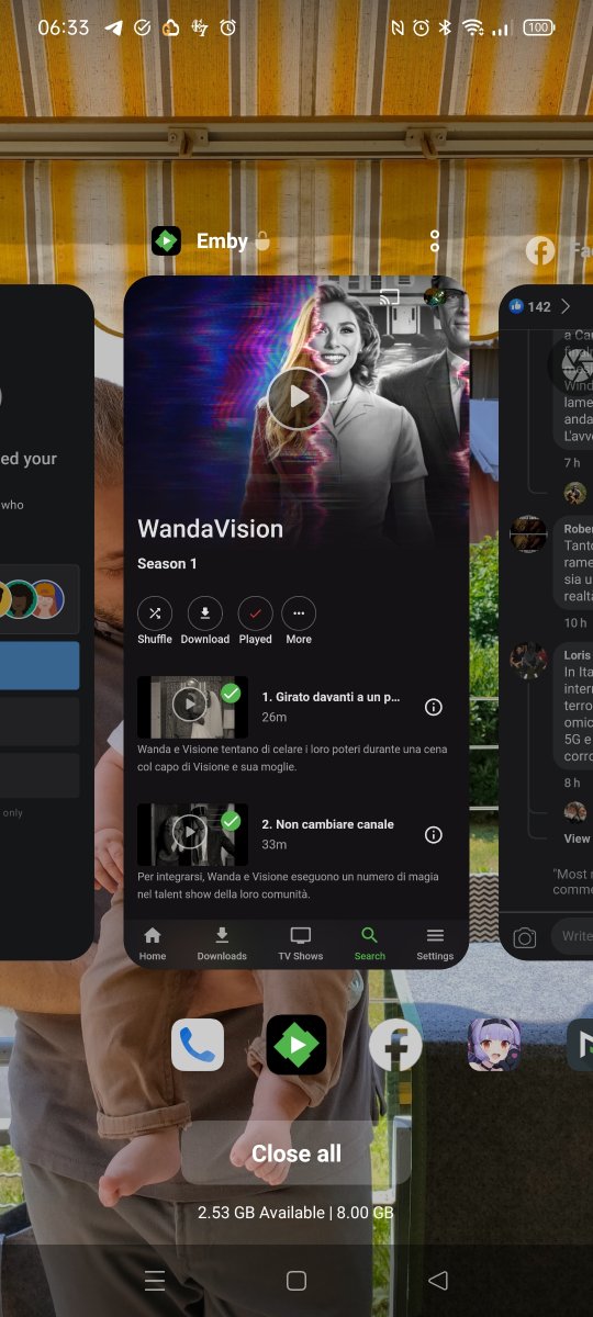

Bazzu85 22 Posted July 25, 2021 Author Posted July 25, 2021 50 minutes ago, Luke said: Are you still having an issue with this? Yes. Right now I'm waiting for some sync from the server from yesterday (when I last opened the app manually). Here's some screens about the app being in background:

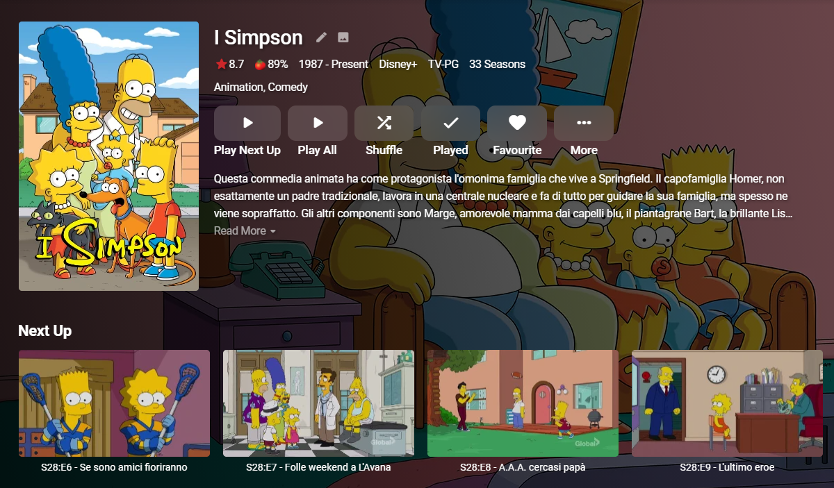

Bazzu85 22 Posted August 8, 2021 Author Posted August 8, 2021 (edited) @Luke can you please follow my reasoning? The actual situation is that both my device has the "simpson" job setted to download the latest x unwatched episodes. In both if I don't open manually the app the sync doesn't occurs. Both devices have the app in background and unopened from x hours/days: 1. Tablet, Huawei MediaPad T5 10, Android 8 2. Phone Oppo Find X-2 Lite, Android 11 Checking the server the status is always: "Downloaded" for both entries. 1. Tablet 2. Phone The next episode that need to be transfered is from S28E06. So 1. Tablet: 2 episodes 2 Phone 2 new episode removing S28E05 Here's some test to show you that the problem ISN'T the android app not running in background. This test are exectuted on the server web page without touching both android devices Test1: Modified the tablet entry to sync 4 unwatched episode Screens of job modification: https://imgur.com/a/ho8KowQ Edit: Test failed. Not all tweak were done as suggested here https://dontkillmyapp.com/huawei Made all necessary tweaks and waiting for tests after some hours of idle. For this device the tests results in: all work flawlessly. Waiting some minutes/hours the sync occurs automatically. Screens after job modification after 20 hours of no signal from the android app: https://imgur.com/a/YwWrsPt Waiting the sync. Test2: Modified the phone entry to sync 5 unwatched episode Screens of job modification: https://imgur.com/a/QNlYoAA After a while the downloads start without touching the phone: https://imgur.com/a/u5APffE I repeat: NO PHONE INTERACTION. Test3: Created a new sync of a serie Screen after job creation: https://imgur.com/a/56fwJXn After a while the downloads start without touching the phone: https://imgur.com/a/lYUJFaL Again: NO PHONE INTERACTION Test4: Watched an episode with google tv and after hours of no sync, restarted the server Screens of sync required: https://imgur.com/a/cnYF1MM Waited 5+ hours. No sync from phone Restarted the server: waiting for changes or sync jobs.. https://imgur.com/a/QFWlDcU edit: no sync after the restart Final thoughts: for me and my test the problem is that the server is not updating automatically the sync jobs. They remain in "Dowloaded" status until there's something that trigger the update (AKA modify the sync). The app on phone is running well and is in background as expected. If it were not so it would not work, even modifying the sync jobs on server. The strange fact is that manually opening the app, the synchronization about what need to be synced is done instantly. For the moment I found a workaround to open the app with a tool every time I connect the phone to the charger. At least every night the download jobs occurs. edit: checking the tablet test I don't know what to think. On that device the sync works. On oppo phone the sync don't works automatically but only manually open the app or modifying something on the server. There's no doubt that the app is running in background 'cause test number 2. Edited August 10, 2021 by Bazzu85 additional infos
