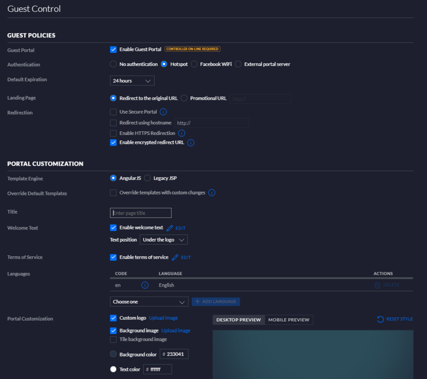

rbjtech 5337 Posted May 20, 2021 Posted May 20, 2021 (edited) Agree with @cayars - emby is the easy part - the work and $ will be in the network / wifi. Something like a Ubiquiti Unifi Access Point already has the ability to create a Guest 'Policy' which re-directs you to a URL - I see no reason why this could not be used to direct to the emby server. An anonymous login will then take you into the videos screen for example. All access will be via a standard browser on the mobiles - on the Kiosks - it would be better to use the App but not essential. If decent 4G/5G is available - then you could host emby in a cloud provider and just provide the internet URL's to the users. The kiosks could get the internet via 4G dongles. Edited May 20, 2021 by rbjtech 1

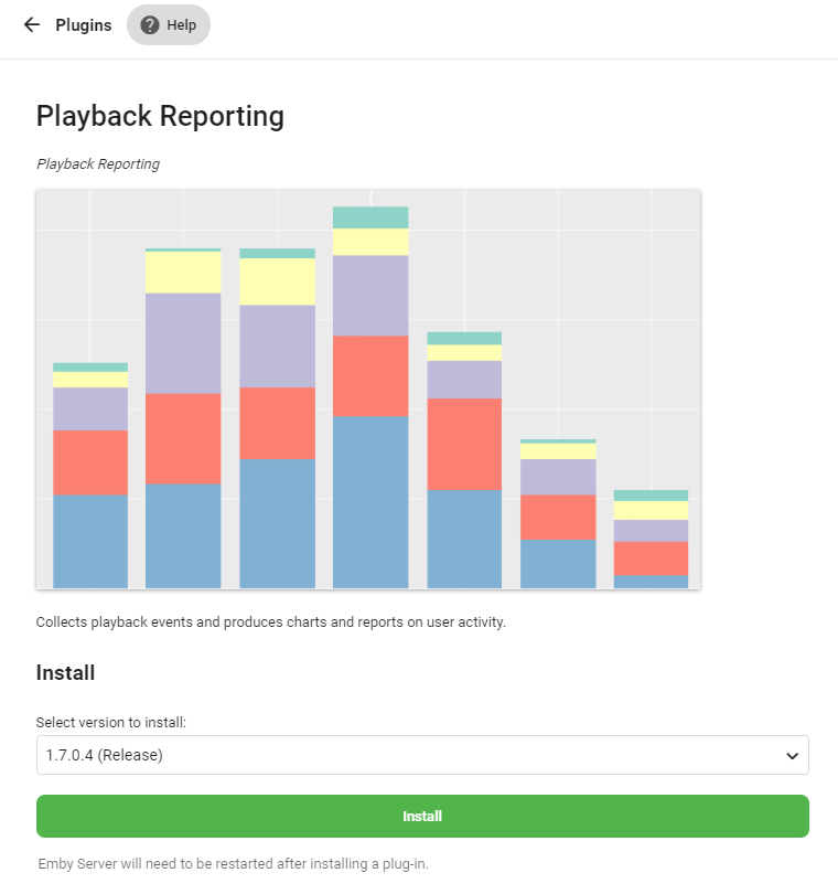

rbjtech 5337 Posted May 25, 2021 Posted May 25, 2021 "Is there something that would monitor most viewed videos? Maybe a rating of the videos? " The 'Playback Reporting' plugin will give you all the stats you would likely need - it will certainly keep a playback count on which videos are being played. You could maybe setup different accounts on the Kiosks vs mobile - and then gets stats from each type ? On the rating - Emby doesn't currently have a rating or feedback system.

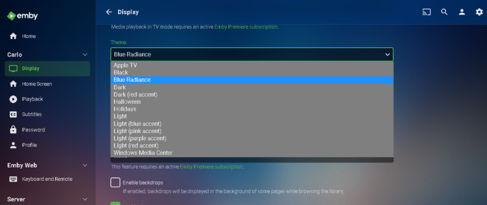

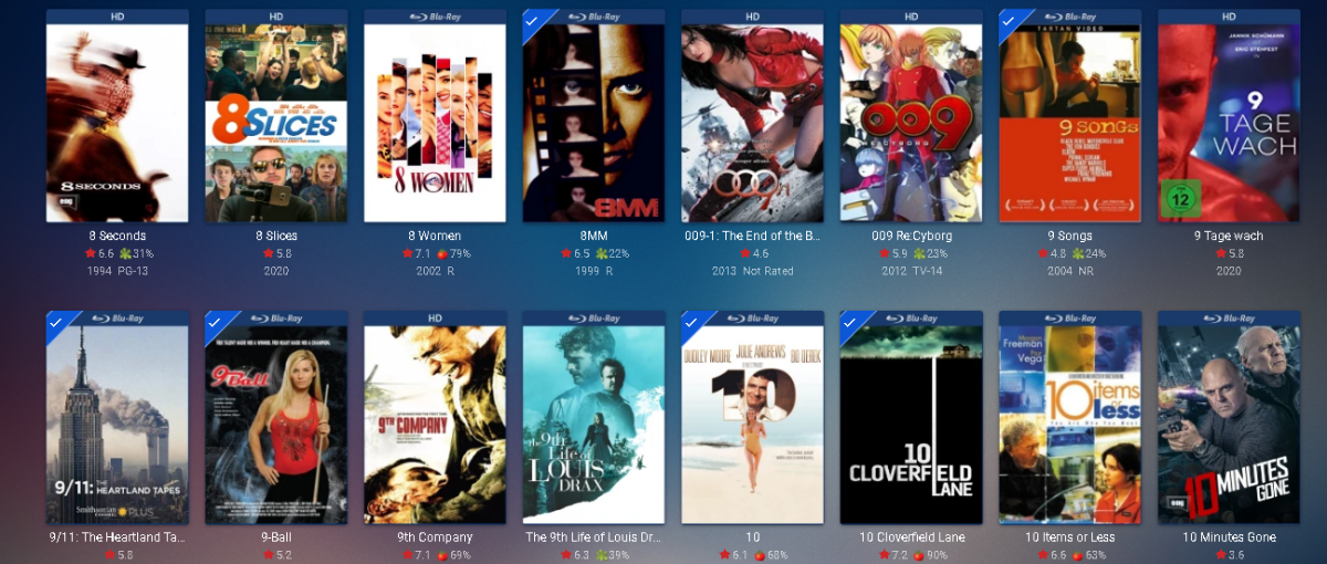

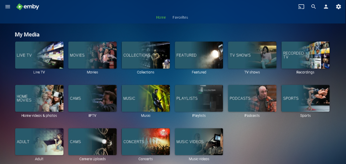

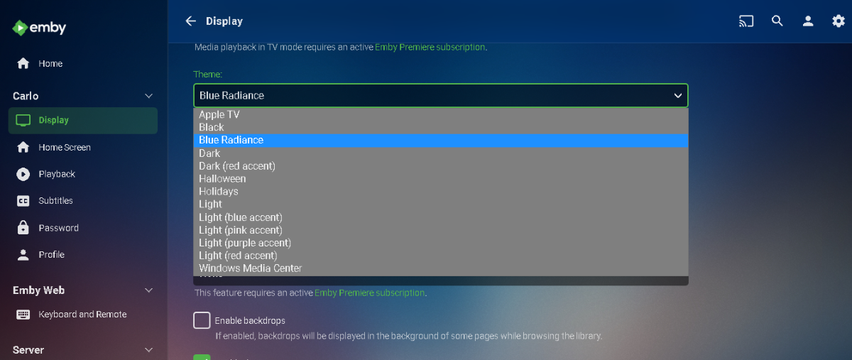

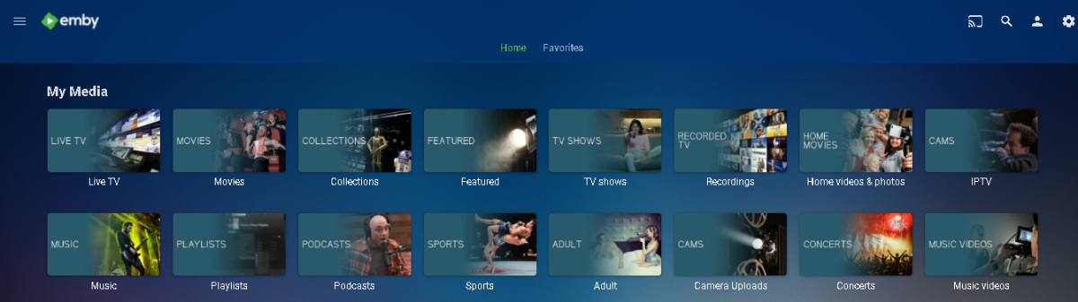

Carlo 4561 Posted May 25, 2021 Posted May 25, 2021 With Premiere you have multiple color themes to choose from. This picture is taken using the Blue Radiance theme which is my favorite. With the use of CSS you can do this like change some elements. This pictures shows the watched status changed from the green checkmark to a left hand ribbon check. ra You can change your home screen graphics for different libraries to get looks similar to these two pics: There are a lot of canned things already done with CSS if you look here: https://emby.media/community/index.php?/forum/144-web-app-css/
Shendrickson 1 Posted May 28, 2021 Author Posted May 28, 2021 Thank you all. I appreciate all the guidance. We're giving this a shot this year. Got the server built, videos uploaded. Licensing tomorrow. Then I'll work on making it pretty. :) Sorry for the noob question but when I try to find the plugins, I must be in the wrong spot. I only see one for Windows Desktop. Where should I be looking for the one you suggested @rbjtech
Shendrickson 1 Posted May 28, 2021 Author Posted May 28, 2021 I found this but I don't seem to have the Plugins in the server dashboard https://support.emby.media/support/solutions/articles/44001159720-plugins
Shendrickson 1 Posted May 28, 2021 Author Posted May 28, 2021 I found it. Under the Server Dashboard / Advanced. 1

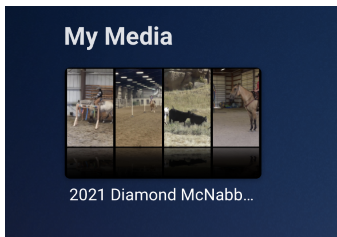

Shendrickson 1 Posted May 29, 2021 Author Posted May 29, 2021 Last questions (Really going to try at least) Do I modify the CSS from the Server/Settings /Custom CSS area? I just create what I need there? Is there a way to have the Home screen not show the compressed videos first but rather have them expanded like when you click the title underneath? I know you said there are canned examples @cayars but I'm having a hard time finding the right search term. Would it by My Media to key off of? Compressed Would like to have the Home screen open to this instead or something similar.

Carlo 4561 Posted May 29, 2021 Posted May 29, 2021 12 hours ago, Shendrickson said: When you say you want to change the text under My Media are you talking about wanting to change the wording of "My Media" to something like "Horse Videos" or "Auction Videos" or similar?

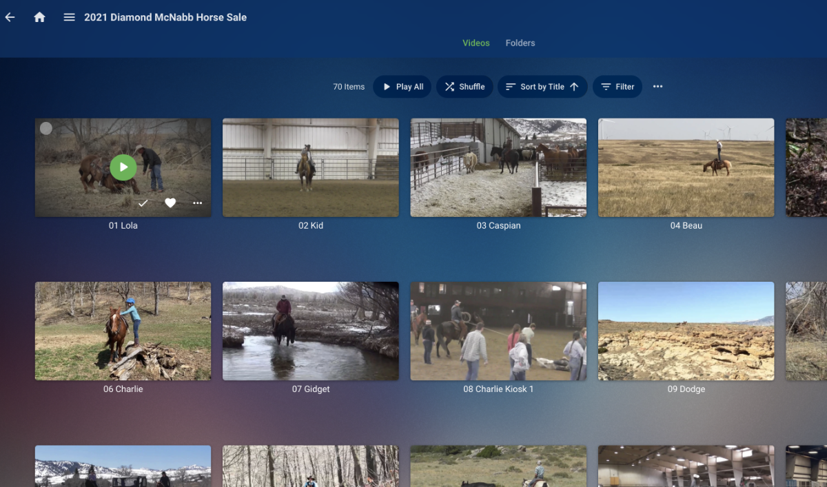

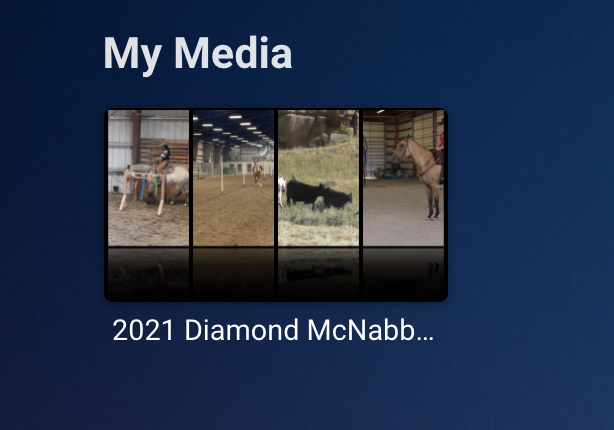

Shendrickson 1 Posted May 29, 2021 Author Posted May 29, 2021 The wording under the compressed images of My Media. In this case the 2021 Diamond McNabb.... But when looking up at my previous post and seeing what happens when you actually go into the library, the 2021 Diamond McNabb.... is shown as the title which makes sense to me. Maybe I'll just suck it up and live with it. . Still works great.
Carlo 4561 Posted May 29, 2021 Posted May 29, 2021 2012 Diamond McNabb... is the name you gave the library which you can change. To change go to Library menu, hover over this library, click the 3 dot menu and choose the rename option.
Happy2Play 9802 Posted May 29, 2021 Posted May 29, 2021 (edited) 12 minutes ago, Shendrickson said: The wording under the compressed images of My Media. In this case the 2021 Diamond McNabb.... But when looking up at my previous post and seeing what happens when you actually go into the library, the 2021 Diamond McNabb.... is shown as the title which makes sense to me. Maybe I'll just suck it up and live with it. . Still works great. That is the Display Name you used when you created the library. You can go to Dashboard-Library and select Rename on the library. Edited May 29, 2021 by Happy2Play
Shendrickson 1 Posted May 29, 2021 Author Posted May 29, 2021 Thanks @Happy2Playand @cayars In my mind I wanted to have two different labels. One for the title when in the library and a different one under the My Media thumbnails to be more descriptive so people know to take action. Don't think it would look good to have the action description shown in the library. Thanks again for the input.
